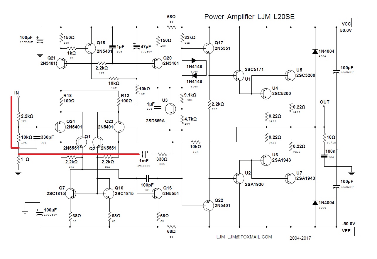

I know the right way to do it 🙂 I had a hum when I connected to preamp, since doing it the right way required major disassembly and cutting PCB tracks I haven't got around to it yet. I put a 5 ohm resistor in the shield of just one channel, if this makes a difference, and the hum is gone. I appreciate tracking down loops can be complex and it may not be a cross channel ground loop
If it helps to point out, I found the schematic and board layout of this amp on this forum.Ok. It’s very important to note that you cannot simply put a HBR resistor in series with the shield connection. You will make it worse by doing that, because the noise loop current flowing through the resistor is in series with the signal.

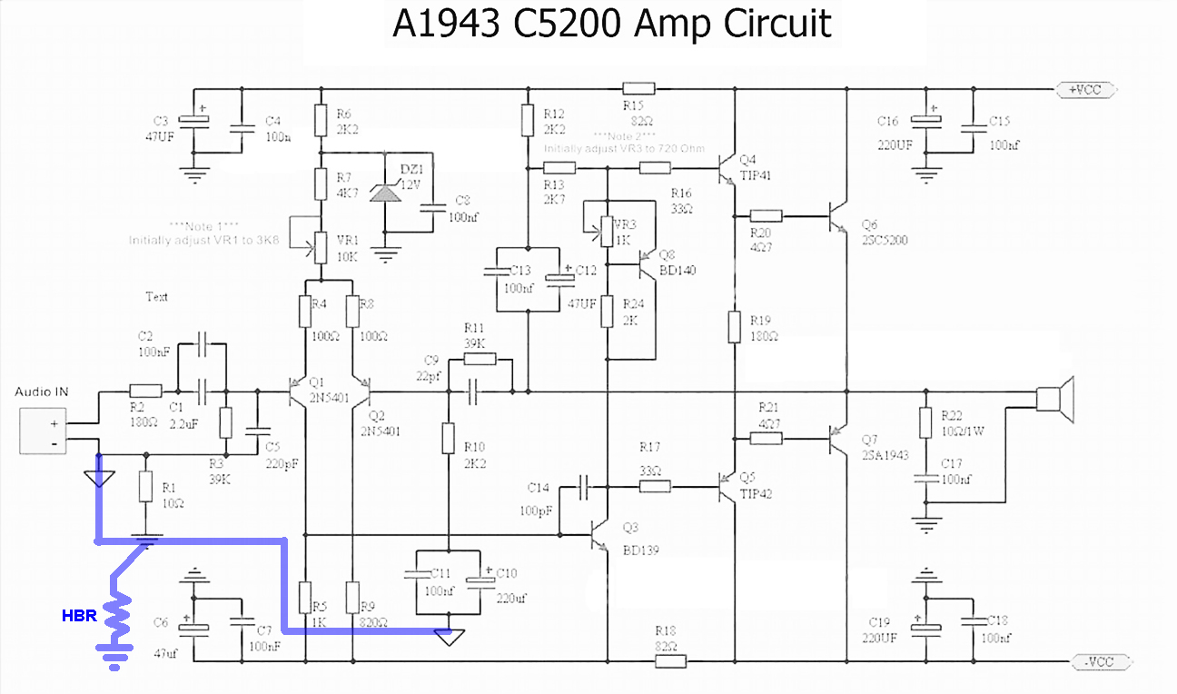

I'll try HBR connection recommended and report back.

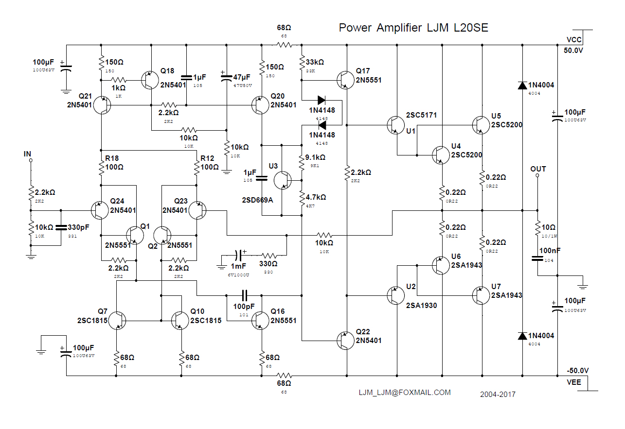

While waiting for the parts ordered to arrive, I decided to delve into 2 other amps I have with the same buzz/hum issue from speakers. It's dead silent when powered on with no input connected, then as soon as it's connected, there is buzz/hum from speakers. My guess is the same ground loop issue I've been dealing with. The images attached are schematics of the two amps with the implementation of HBR in the circuit (blue lines). Do they look right?

Yes, although in the first diagram R1 is the HBR and the triangle symbol shows the connection to the feedback networkDo they look right?
