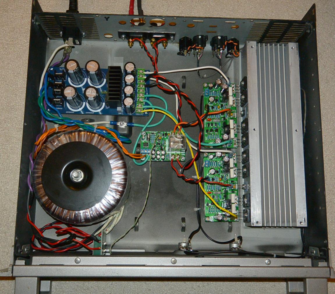

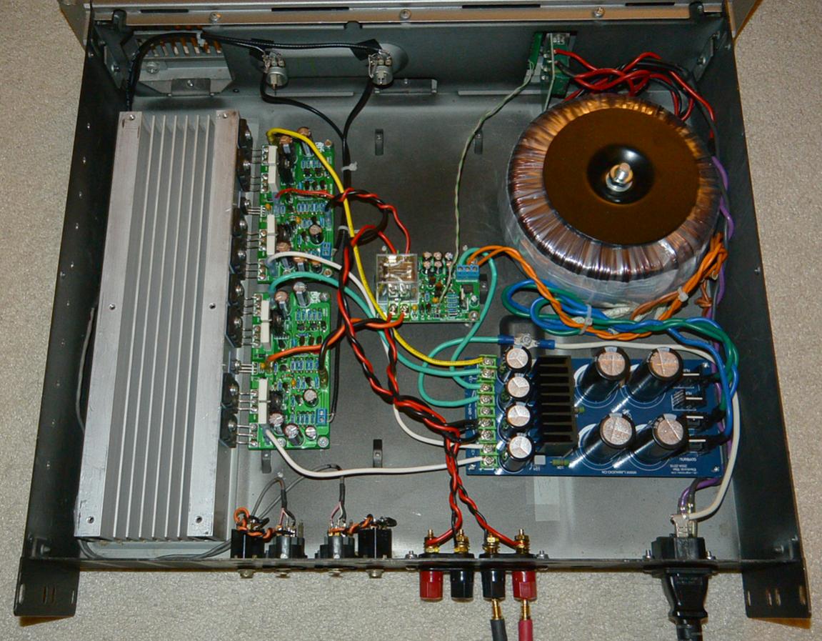

I finished LJM L20SE amp kit I purchased from ebay and it's working but there's that pesky 120Hz buzz (sounds just like sawtooth wave) from speakers when switche on. It's not audible from listening spot but it is from 2' away and doesn't change with volume knob turning. It gets little louder when input is connected and gets louder as the volume knob is turned up. Below are what I've tried so far.
1) Both output terminals show 1 mVDC when switched on with nothing else connected.
2) Tried shorted input plug and it gets little louder just like connecting line level plug.
Pictures attached. It's a Yamaha PA amp shell I adopted. Everything inside is new.
Any thoughts on what is causing the buzz / hum from speakers? Thanks in advance.

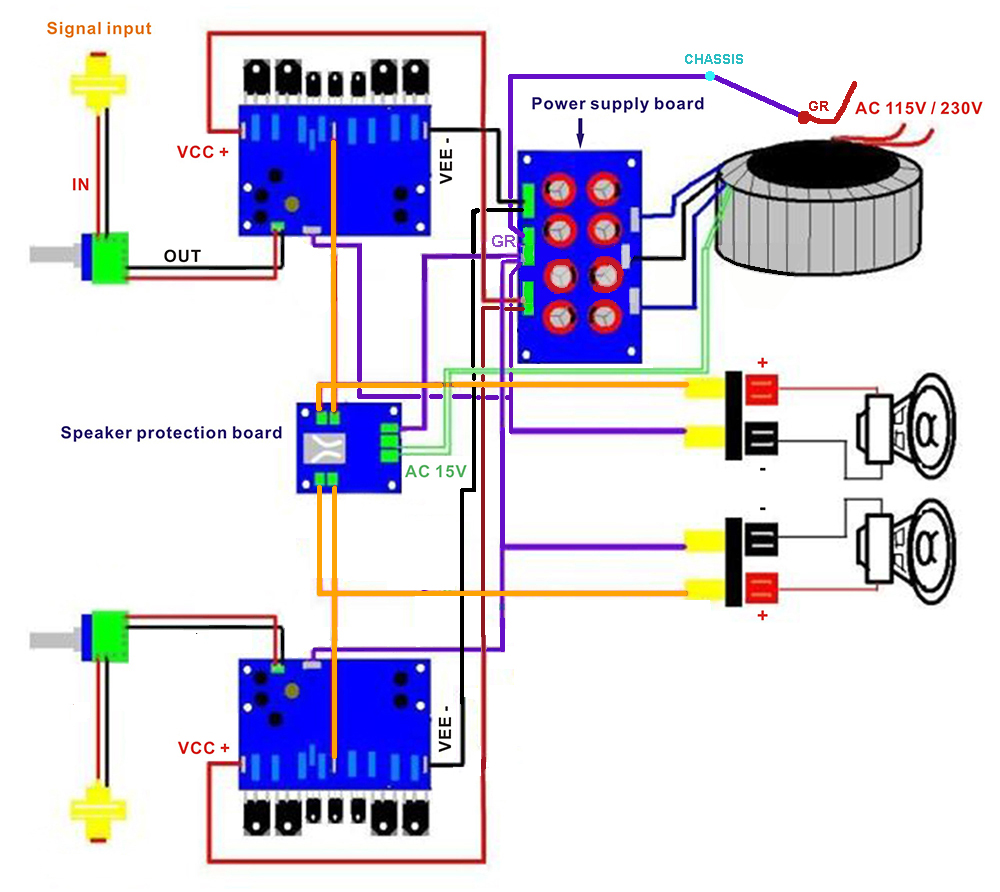

Disconnect the turquoise wire that connects from common ground (on the power supply board)to chassis ground and run it directly from chassis ground to the screen wires on the input XLRs/jack .
Also I wouldn't twist together the red speaker output wires with the black power supply return wires that run from the amplifier boards to the power supply board .
PS you have just spliced the screened twin cables to the coaxial cables ie you have not got a balanced to single end converter hidden away ?
The first thing I'd try is disconnecting the speaker return from the power supply board.
That's a ground tab of power supply board.
Also you could put a ground loop breaker between signal ground and the chassis.
Attached image is basically how my amp is wired. Red and black speaker wires in my amp are signal and return (to ground) speaker wires.
I made this amp for home audio use (unbalanced line level).

Yes, but you need to take ground to the amp too, and keep the three power wires as close to each other as you can for as long as you can.
That's basically what I have now as shown in the image on post #6.
Does the ground connection on the speaker protection go to the relay contacts?
It appears so. I put my multimeter probe between the two (with nothing else connected to relay board) and it shows connection.

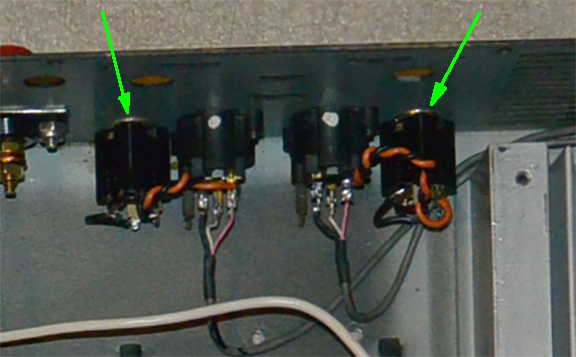

I found the culprit for buzzing when no input is plugged in. It was accidental coupling of input plug with the chassis. Shown in the attached picture are TRS input plugs which I forgot that they have metal threads and mounting nut (I recently finished another amp with TRS that has plastic threads and nut). It was electrically connecting chassis and input shield wire. I removed it and now it's dead silent when no inputs are connected. :happy1:
Now onto puzzle #2. When the input is connected, there is faint buzzing from speaker, though not as loud as it has been, it does get slightly louder if I turn the volume up all the way.

Good that you found the ground loop caused by the connectors shorting to the chassis. When the input connectors are shorted to the chassis and you have the PSU 0V tied to the chassis elsewhere, you get a loop. The loop currents flowing in the chassis metalwork can be quite high. The rule is you can have one and only one connection from the amplifier PSU 0 V to the chassis metalwork.
At the back of the presentation (slide 68 and slide 69) is a short debugging guide to help determine whether the problem is common impedance coupling or an earth loop.
I see you have mounted your input conn3ctors close together. You should bond the signal returns together. This traps internally generated cross Chanel ground loops inside the amplifier.

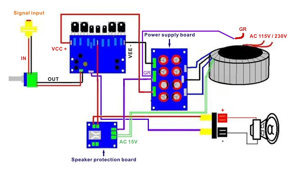

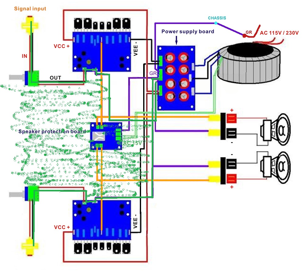

Looking at your diagram, Mark has highlighted where you have large loop areas. Power cables to the amp modules must be twisted together. AC from the transformer to the rectifiers/PSU board must be twisted together.
Twist the speaker hot and return together from the amp module to the speaker terminals.
See slides 61 to 63 for info on how to route the input cables - again, it’s all about minimizing the total loop area.
Quick tip: always bring your power connections onto an amp module together - avoid spreading them out as this creates a large loop area on the PCB.

Ok. It’s very important to note that you cannot simply put a HBR resistor in series with the shield connection. You will make it worse by doing that, because the noise loop current flowing through the resistor is in series with the signal.
See slide 37 on how to do it correctly. When it’s done the right way it will attenuate the noise signal and reduce the noise loop current. A 20 dB improvement is usually what you can achieve.
Note that when I mentioned input jack bonding, it just means ‘connect the two signal grounds together where they enter the housing - do not run any separate wire to the 0V on the PSU!
The input cable routing to get rid of the hum is critical. See slides 61 to 63. If you just run the cables directly from the input jacks to the amp modules (shortest route) you are probably creating a huge loop area inside the amp. Run the two cables together to the fist amp module, and continue the second input cable to the second module. You may well find that if you run it back to the PSU alongside the 0V return, and from the PSU alongside the 0V to the second amp module, you get the best result - you will need to experiment a bit to get the best location though. This is where I recommend the ‘headphone trick’ - See slide 65 and 66.
Don’t forget to rotate you transformer +- 60 degrees to find the noise null point as well.
