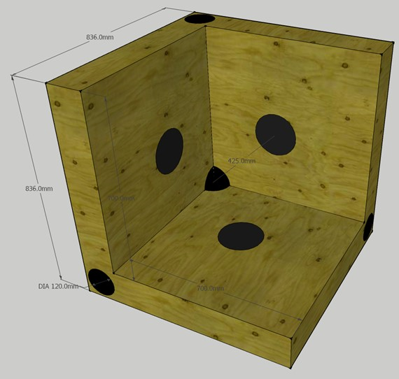

There is a Faital Pro 3FE22 in the corner apex and three SB Acoustics 4 inch alu cone bass/midrange drivers per loudspeker. They are activly crossed over at 250 Hz with a MINIDSP.
Great posts - I have been interested in Carlsson designs are well. Larsen speakers are available in the UK and is something I have considered.
Any further feedback on this design, basic measurements etc...? Have you created a separate forum thread for this?
Besides a true horn - which is simply not feasible for low frequencies* - I'd say a well-stuffed 17-foot labyrinth comes as close as anything to a non-boxy non-tuned sub mounting that also employs the rear wave fundamental suitably.

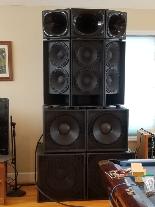

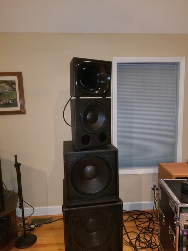

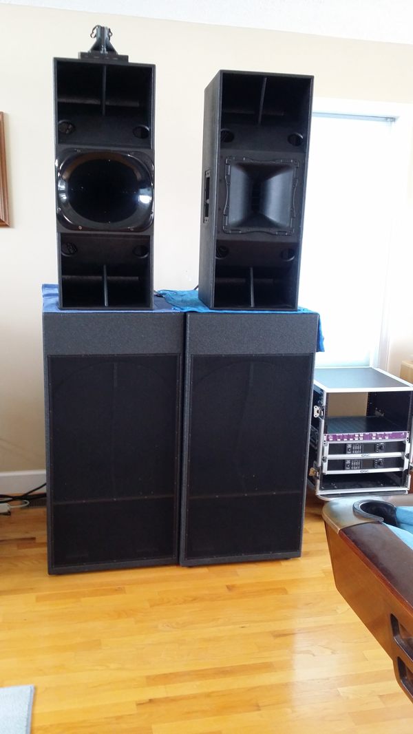

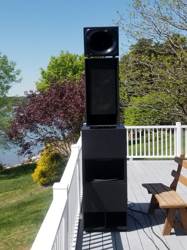

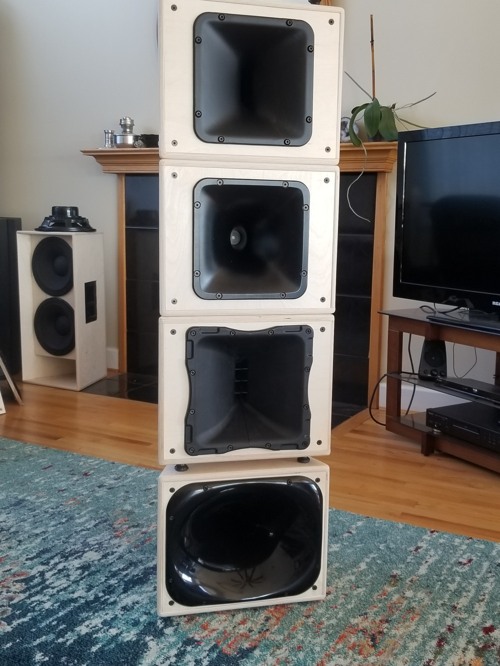

....I've made several different 4-way designs built around the BMS 4594HE ....
Photos please?
Photos please?
Thanks for asking! What DIY'er doesn't want to show their work? 🙂
My use of the bms4594 began with the Peter Morris DIY90 & 60 found on soundforums...really excellent design by a great proaudio DIY'er.
In the first pict below they are sitting on a pair of JTR Orbitshifters.
Then I got the idea to make a modular PA, that could array easily for wider coverage.
The second pict shows a trap box and the 4 horns I could put the BMS CDr on.
The size of the the horn box defined the size of 2 different mid sections, a single 12", and a double 12".
The single 12" stack is sitting on DIY single 18" sealed, and vented, subs.
The double 12" stack is sitting on DIY PPSL double 18" in push-push config.
Arraying a few stacks together can make for a hell of a big speaker.
It's all very modular, very easy to use small, or big.
The processing glue that makes it all work together, is all pieces are running zero degree flat phase via FIR, except for a little sub rotation at the very bottom end.
I really strive to eliminate any group delay...it may be why transients such as fireworks do so well....
