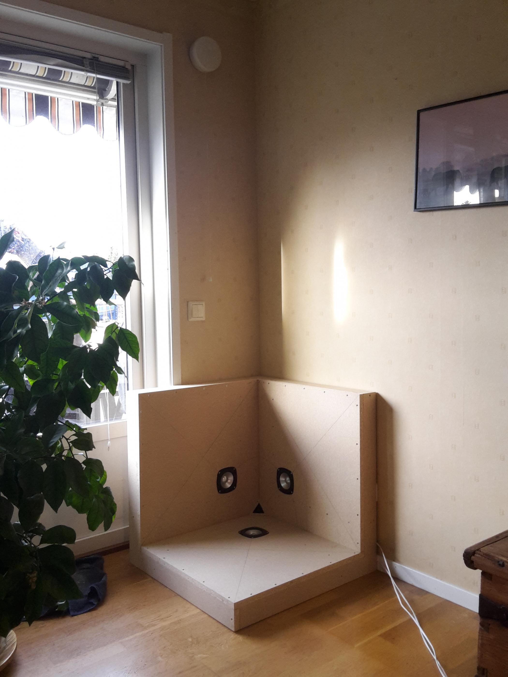

Early reflections will downgrade the transient response and the subjective experience of punch and sharp detailed reproduction of percussion. I built a pair of Ortoacoustic Unity corners some while ago, and the most striking property was the transients and the definition, especially in the midbass (the main problem area of early reflections combfiltereffects etc in normal loudspeaker/room setups).
There is a Faital Pro 3FE22 in the corner apex and three SB Acoustics 4 inch alu cone bass/midrange drivers per loudspeker. They are activly crossed over at 250 Hz with a MINIDSP.

would changing the square corners to something rounded or even diagonals affect the performance?
could this be inverted and used in the "top" corner of a room?

Probably yes and yes. This was my first foray into this strange hybrid between Unity horns and Stig Karlsson OA-speakers. It was a shock to me, and I am in the middle of a total reevaluation of electroacoustic soundreproduction. I have not had the time, energy or the economy to further the development of these speakers. There are many variations I would like to try, and rounded or diagonal outer surfaces are among those.
It has been a very profound and transformational experience to test this idea, and they are certainly not for everyone. They are absolutly ruthless to recordings and peripherals (amp, CD, soundcard etc).
I only wanted to mention them as an example of ways to avoid lots of room acoustics related problems in high fidelity reproduction of percussive instruments. Early reflections really mess up transients, dynamics and the resolution of much of the fundamentals in many instruments (midbass and lower midrange).
Using a pointsource with a very precise radiating pattern to avoid early relections and to keep the tonal balance, phase and general character between direct and reflected sound is very important to the quality of reproduction of percussive instruments in a listening room.

They have a 90 x 90 degree radiation angle so I would guess it more depends on the room acoustics and the placing of the loudspeakers.
