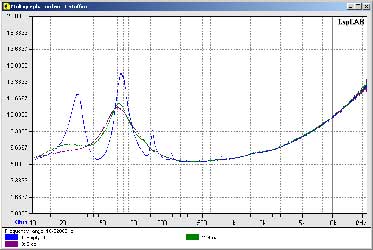

impedance graph
Hi MJK,
I have a question regarding impedance plot, there are 2 opposite achievement to make it right for TL, if I understood it correctly:
1. Your answer in this thread dated 01-07-2004:
(MJK) Watch the graphs as you move the woofer along the line and add or increase stuffing at different locations. The goal is to have a strong first peak in the terminus to augment the driver's rolling off bass bass, then damp out the other peaks to reduce ripples.
2.From Mini Mite ESL project by Sheldon D. Stokes, .Jordan TL Bass :
The line should be stuffed just until the lower peak disappears, and the upper peak becomes a smooth single peak.
You mentioned the second peak should be damped, Sheldon damped the first one (attached graph below), so I get confuse.
Would you mind explaining what the good/bad things happen for both answer?
regards,
Chris
Hi Chris,
The second peak I was refering to is in the terminus SPL response. You want the first peak to add bass but not the second which produces a ripple in the system SPL response.
I do not add stuffing until the first impedance peak is smoothed, this is an old rule of thumb that people typically apply to TL designs as a sign of correct damping material amounts. I don't believe this is correct and usually end up with two peaks in the impedance curve like a bass reflex design.
