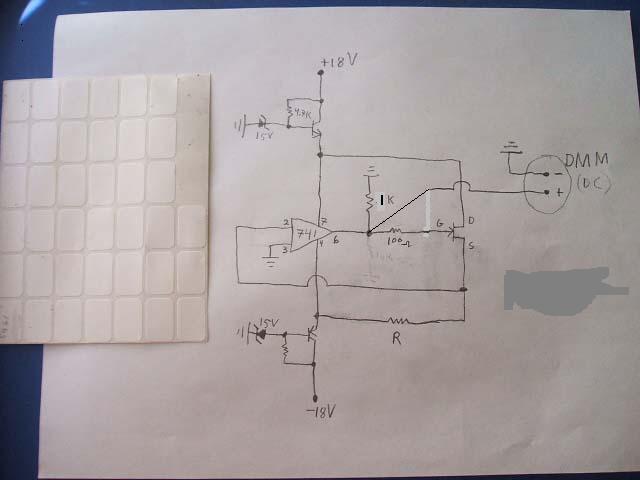

One good thing is that because the circuit is bias between 2 current sources, and a J-fet has a maximum transconductance, it is not likely there will ever be enough current to create smoke allowed to flow even if it isn't balanced. This gives you a chance to figure out what’s going on and which values need to be adjusted. If not for this, I would have never gotten the other to work and given up long ago. I'm curious if this one will work.
As always, have fun playing with your wires!🙂
BTW, here is the Vgs tester I used. About as simple as it gets. Id=14.4V/R.
