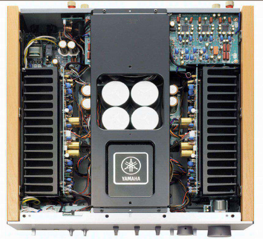

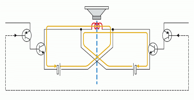

I was informed by Rabbitz, the one sent me Yamaha brochure from model 2000.
So... as you can see, idea is not mine... i have just tried something using very simple circuits.
And there they told me nice things.

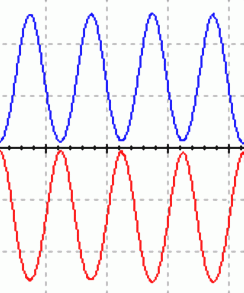

They told are avoiding crossover, using new kind of circuit... two amplifiers NOT operating in push pull mode.... operating push push or pull pull mode...all transistors the same... NO PNP together NPN...or all PNP or all NPN.... no crossover and class A operation.
Those two amplifiers are combined into a single channel, alike a bridge i think... load goes into the midway... the middle... receiving both output signals that will be out of phase one compared to the other.... complementary phase will be there combined... will be there into the output load, the speaker.
I felt the idea GREAT!... and i have tried.... sounded PERFECT!....but efficiency was very low (2.5 percent to single ended half cicles units..direct coupled, class A, now swithing circuits)
Into the input i have used a single transistor to invert....one channels captured into coletor and other into emitter...all folks class A...............2.5 watts to 100 watts of consumption...AWFULL!
HELP!.... have any idea to make this thing better?.... can you do some?.... have a good idea?.... can you contribute with me, with yourself, with forum and with mankind?.... let's do something better?.... together?

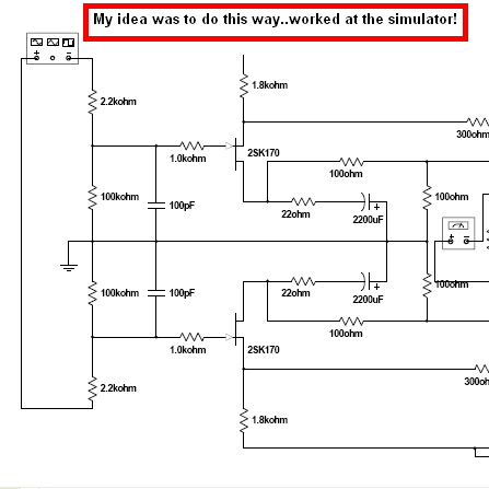

Up and down you see two amplifiers, direct coupled
of course DC amplifiers...all folks hot, class A monster.
The upper one receive one phase and the other receive the complementary phase... the down left stage inverts... gain one class A stage (colector and emitter resistances have same value).
Into the output, the upper amplifier is combined with the lower channel into the load...the off set there is small..the amplifiers are almost the same...so... the colector voltage into the upper one is 17 volts... and the colector voltage into the lower one is also 17 volts... difference is 40 milivolts or less...so... we can combine both into a single resistance or speaker, as will not flow DC.
But AC will flow!... clear...perfect sound..superior.
But terrible!...awfull!...ridiculous in efficiency.
Wanna help?... wanna do it by yourself?... wanna have fun?

Hi Carlos
I have tried the idea of using a single transistor as a phase splitter and found it isn't quite as simple in the real world as it should be. The junction capacitances of the transistor are not the same for collector and emitter. Neither are the output impedances. This will cause a phase shift in one of the signals with relation to the other vs frequency. (In addition to the 180 degree shift your trying to achieve.) Any phase shift like that will create distortion across the load at the bridged output. I don't know how Yamaha does it, but I have found it is better to have a single end to balanced converter "circuit" to feed both equal amplifiers. Hard to achieve with just 1 transistor. It might work great in a simulator with an ideal transistor, but simulators don't make much sound.:) One could build a balanced amplifier, but most balanced amps I've seen require a balanced input so you still need a conversion. There are good quality signal transformers out there, but I personally don't like signal transformers in SS, JMO. There are IC's available out there that are SE to BAL converters, but they're not cheap. Of course it certainly is possible to do it with discrete small signal SS.:cool:

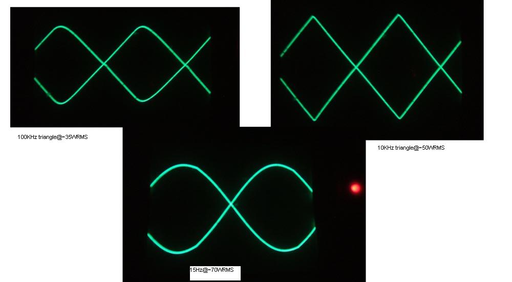

Hi Carlos
I have tried and have a circuit. It hasn't ever been simulated, but it has been built with actual electronic components and real transistors.:D I hate to give away all of my ideas :rolleyes: but I could discuss it if your interested.
These waveforms are each output to be bridged across the speaker, source is a single end input, my function generator.

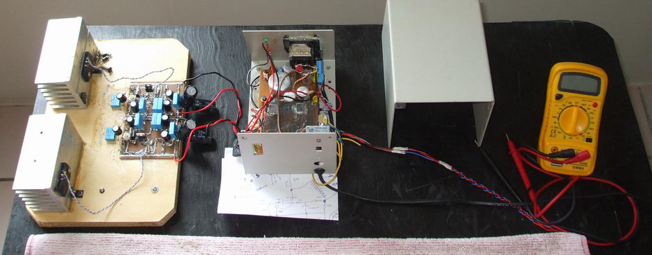

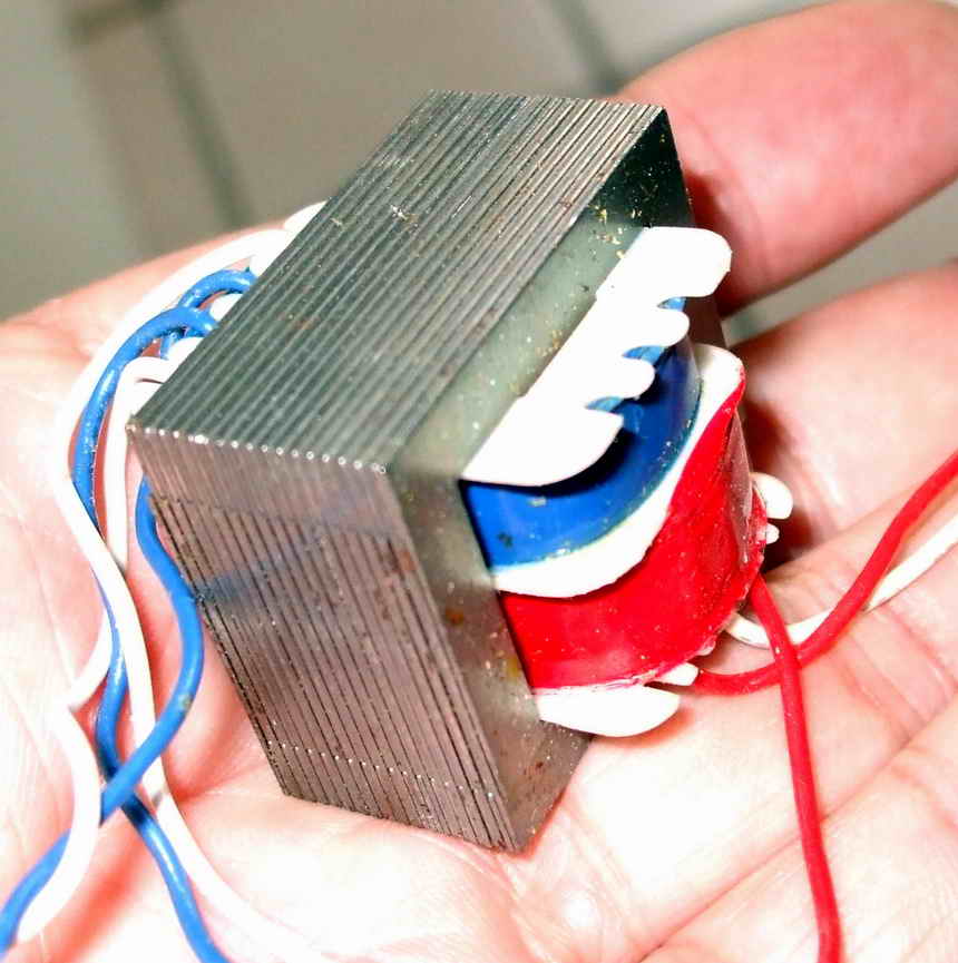

I have a transformer...in the reality i have 3 different ones
One of them may fit.
BUT!... i will not assemble...will stop...if really needed a transformer or a phase splitter, or phase inverter gain one......because the amplifier will not be more simple the way i have appreciated it.
No more stages...if needed... i will probably stop... quit!
Because if assembled...and even sounding good... i will be sure the transformer will be sacrificing... sound would be better without that thing into the input.... so.. will be a matter of confidence... i will loose confidence.... because in my mind a transformer is not a good thing to use into the audio input.
Phase splitter or phase inverter gain one stage is one more stage..the amplifier will be no simple anymore..the quality to be simple will be lost..will be three stages alike others..no advantage.

Re: I am always interested into new circuits CBS240
destroyer X said:
...BUT, i feel your circuits too much dense to me to try (lazy i am and i have some beliefs AGAINST too much complicated designs)...
Ahhh then a signal transformer might just be your solution.:) My circuits might have a few components more than yours, but they have grown over the last years. When I ran out of board space with the TO-92 parts and 1/4W resistors, I changed my philosophy. IMHO:cannotbe: , you don't need power in an amplifier until the final stages. So, make everything smaller with less current and suitable devices so you can cram it all in on your PCB so it will be smaller than a PC motherboard.:D The project PCB I'm working on now is a 5" X 4" double sided PCB. It is a completely discrete modular balanced amp. Bet you can't guess how many transistors are in it.:p It's not about how many transistors are in it, but rather how it performs. If I wanted to build something to sell, I would cut the circuit down to it's simplest form, loose all the cascodes, use cheaper parts, none of those THAT transistor arrays or Caddock resistors.:) Those things drive the price up very quickly.:eek:
