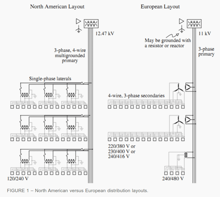

In austria all houses got at least 400V 25A.3 phase 400 Volt service in a home or small commercial building?
Three times 230V to neutral/ground with 120° phase shift.
In small apartment buildings etc we have a similar system in Canada... 120V/208V. It's the kid brother to 347V/600V which is used in industrial settings. Unlike USA which uses 277V/480V.
In my building, they took the time to do proper split phase from each main feeder phase so I actually have 120V/240V here 🙂
Interesting the difference in the wiring topology - Europe vs North America.
