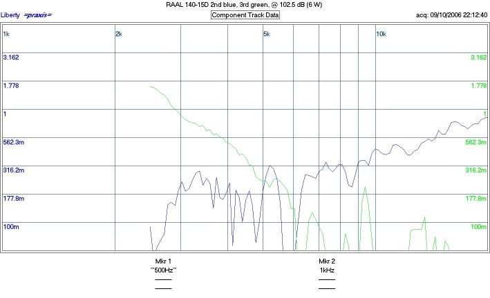

Less than 5% (2nd order) at 3 kHz for 113 db?
It doesn't scale nearly as badly as I would have thought (.. actually much better than a dome). Perhaps it would still be below 1 % at 97db? Any chance you can obtain a measurement for 1 watt at 1 meter?
I'm having trouble with synchrinizing (time windowing to avoid room reflections) below 102.5 dB of SPL, so here's the data for that SPL.
Mind the fact that both measurements were taken WITH passive crossover ( active filter gives the same results), to avoid distortion caused by amplifier pumping current in low primary inductance of the imp. matching transormer. That doesn't happen with other drivers, and this way, it is assured that comparisons are meaningful.
Thank you!
Thats rather excellent for a ribbon tweeter of this size. That would likely place a 97db 2nd order figure at 3 kHz to about .5%. 3rd order is a bit high at higher freq.s, but thats normal for a ribbon this large.
IF a proper waveguide (..with its acoustic gain), is implemented then I'd expect the lower freq. response to be similar in non-linear distortion to the values at 3 kHz.
In this instance then (with a good waveguide) I think this driver could easily give the Raven 3.2 a "run for its money".
The RAAL looks rather clean. But using 4 in a 2x2 array will result in combing effect. Not sure how it sounds in that configuration. Probably two would be enough if you crossed them at 5K~10K.
ScottG said:
In this instance then (with a good waveguide)...
Good waveguide looks as a good solution at a glance, but unfortunately, it is just a nice theory. Been there, done that. Not just IMO, there is a feel of undesireble "tension" in waveguide sound, no matter how low the distortion may be. Something tells me that you know that already. "Life" thought me: the closer to omni, the better. You gotta fix the room for that, but on the other hand, you gotta fox the room for any Hi-Fi.

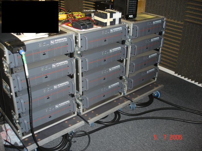

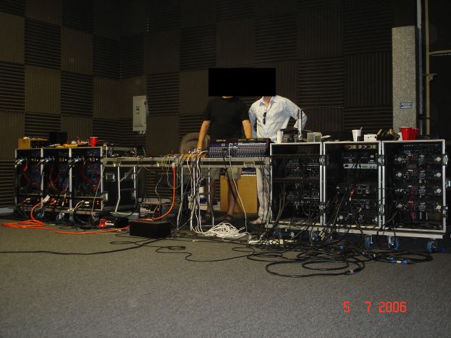

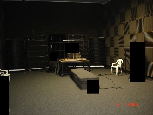

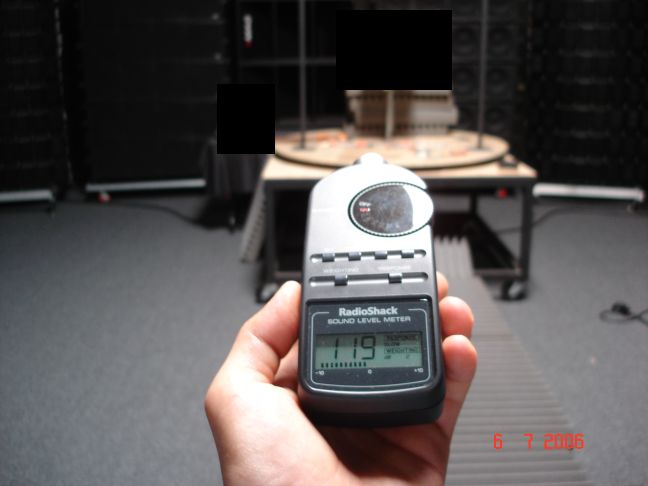

re: Radio Shack meter with a reading of 119dB.
I can get >126dB[c], 12 feet from my cheap line array, 50 cent
midwoofers and $25 tweeters. This is midbass, the upper
frequencies are 110db - 115dB. Midrange frequencies I have
pushed to 120-122dB. Only four proamps too.
