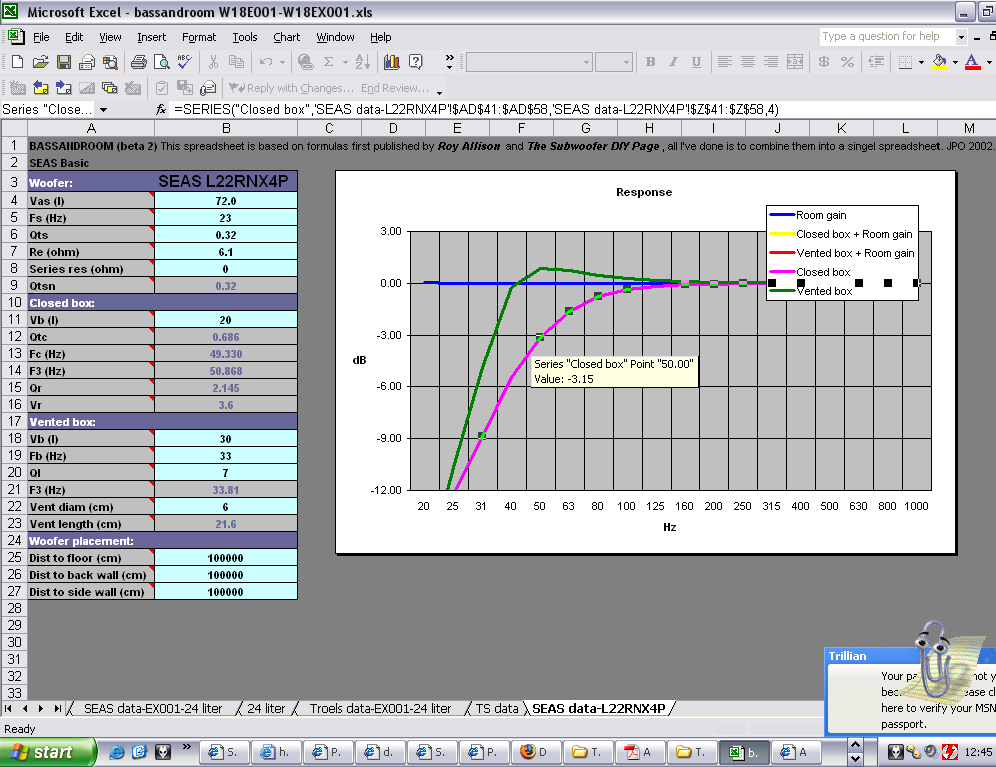

I joined this discussion a bit late, but did you measure the woofer's actual T/S parameters, final in-box Qtc, quasi-anechoic F3 post equalization or Linkwitz transform etc?
How's the room FR response?
In a sealed alignment, 20L each or a sealed enclosures seem too small to me. This is another SEAS woofers that works best vented...

Actually tried it vented early on before the main ones were built, it sounded worst.
The graph you've got for the vented option also looks slightly peaky which would be exagerated after room gain resulting in just what I found, boomyness.
Sealed was the most natural sound and 20L each is actually quite generous with a Qtc of 0.62. Consider that Troels used 30L ported and your looking at similar volumes.
