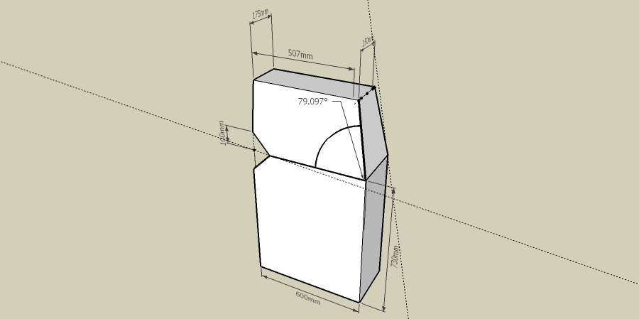

Starting to get the impetus again 🙂 So pictures so far:
Not really much to show but I only spent a few hours on them, everything has to start somewhere I guess 🙂 I've decided to keep the old cabinets and will maybe buy another set of ATC's and SS perhaps press them into surround or center channel service later on.

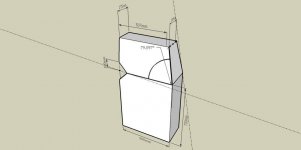

Scott what do you think of this:
What your looking at is the front baffle of the bass cabinet. 3" thick and I plan to bore the hole right the way through this and then create a further 6" lamination of MDF in the shape of a tube. So all in its 9" in depth. The irregular cabinet shape should help minimise standing waves.
This should explain better:
The only downside is that the bass cabinet is going to massively heavy. Double thickness walls throughout with extensive bracing. I'm guiessing at around 60kg each as a minimum.
Would you care to comment on the aperiodic vent placement in this shaped cabinet.

Scott I'm a little concerned about the mms on the 215 GMF - 10g! You sure that's right? According to the Supravox website, yes, but I'm wondering just how well defined the bass will be with such a low mass cone.
Surely the stiffness isn't upto the like of the Seas, so will I be looking at a loss in definition on the low bass(40-80hz) with an edge in transparency through the mid to upper bass?
And are you sure the 'vox will be good to go sealed with aperiodic? I'm somewhat weary of sealed after the Seas let down.
Cheers.
Cheers.
ShinOBIWAN said:Scott I'm a little concerned about the mms on the 215 GMF - 10g! You sure that's right? According to the Supravox website, yes, but I'm wondering just how well defined the bass will be with such a low mass cone.
Cheers.
It should be "hyper" detailed. The reduced mass actually has less energy storage so "definition" is better. Trust me on this one (..even though I've never heard the driver) - if you don't need an extreme amount of "slam" then this is THE driver (in this passband). I know virtually no french, but look at the translation for the 215 GMF:
http://translate.google.com/transla...GMF.htm&prev=/search?q=215+GMF&hl=en&lr=&sa=G
Of course the translation isn't exactly accurate, and its based on marketing - but doesn't the description sound about right?
For the loading scheme:
Yes I'm sure, but the volume needs to be large enough and the other "enhancements" I've suggested will further aid in making this superior to any bass reflex alignment.
The new shape is better than before with regard to standing waves, BUT it doesn't look like it will support nearly enough volume (just a guess though). Still, you would be better off if NONE of the surfaces were parallel - currently the side panels are parallel. Incedentally, with double wall construction (with an air gap between the walls) you could make a cabinet on the outside that looked similar to the one you had b4, but that has no parallel interior surfaces. In any event I don't think its really necessary with the forumla I've provided - but the shape does look cool. As to vent placement with this, your guess is as good as mine.

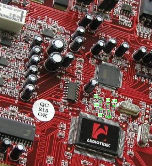

Paging Vil
I finally got a pre-owned prodigy 7.1 and am interested in moding it the same way that you did.
In your post,
http://www.diyaudio.com/forums/showthread.php?postid=671905#post671905
you posted the following pic of the audiotrack dataout
Just to clarify:
Is the L/R (next to X1) equal to LRCK
and what is the 64F (??) above the audiotrak chip? Is that the SCK?
I assue that D1 to D4 are the data out lines.
One side of these resistors are marked with green color. Can I assume that these are the points that I take the data out?
I noticed that X1 is 24.576
and X2 is 22.5792. Can you tell me which clock frequency do you use to sync the external DAC?
yes , thats left/right clock at 1xF .
yes , right thats SCK at 64xF .
yes
yes
none of those . I am using my own low jitter clock oscillator ,
24.576 for 48 , 96 , 192K
and 22.5792 for 44 , 88 , 176
