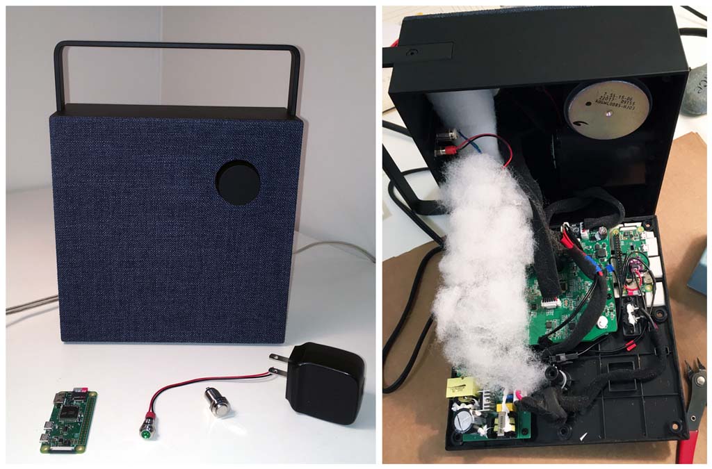

Here is a new entry in the Gallery - Portable player by Dee:
https://github.com/project-owner/PeppyPlayers.doc/wiki/Gallery#portable-player-by-dee-usa

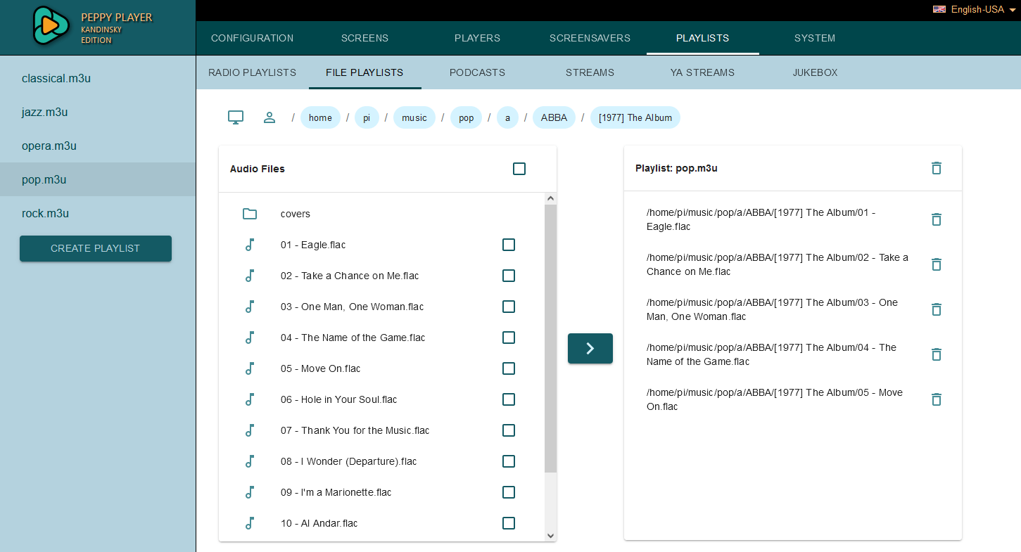

- Implemented a File Playlist Editor in the Web UI.
https://github.com/project-owner/Peppy.doc/wiki/File-Playlist-Editor

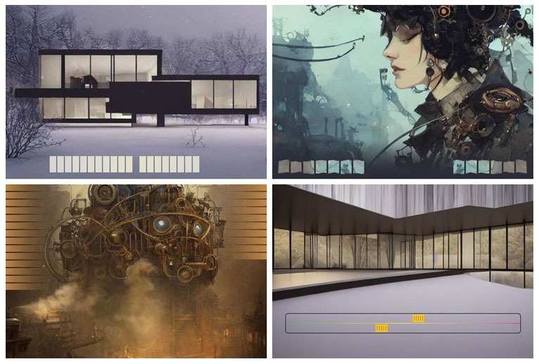

- Added new VU Meter Screensaver types
- Implemented VU Meter screensaver in the Web UI
https://github.com/project-owner/Peppy.doc/wiki/VU-Meter

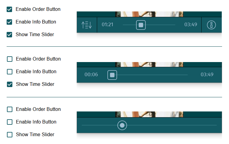

- It's possible now to hide/show different Player screen elements
https://github.com/project-owner/Peppy.doc/wiki/Player-Screen
