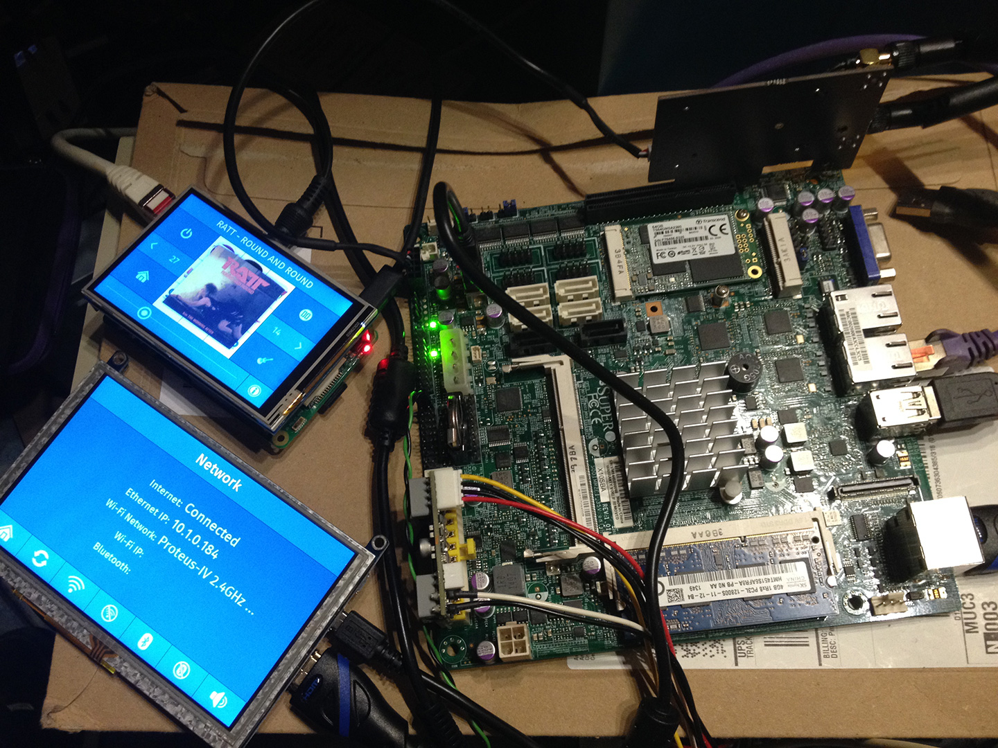

The PLTS (Peppy Laboratory Test Station) 😀
attachment.php
I can confirm that the 'Waveshare 3.5inch RPi LCD (A)' also works with your image without problems. Only the colors where not right and that was gone after installing the driver.
And i see now where that eth0 and wlan0 comes from.
You can enable/disable predictable network in the RPi OS.
If you change that setting you can adjust Peppy for newer systems:
NetworkInterfaceNames - Debian Wiki
You have pretty good PLTS 🙂 I wish to start working with hardware as well. Right now the player software takes all my spare time 🙁 I have 2-3 new hardware projects in my mind.
