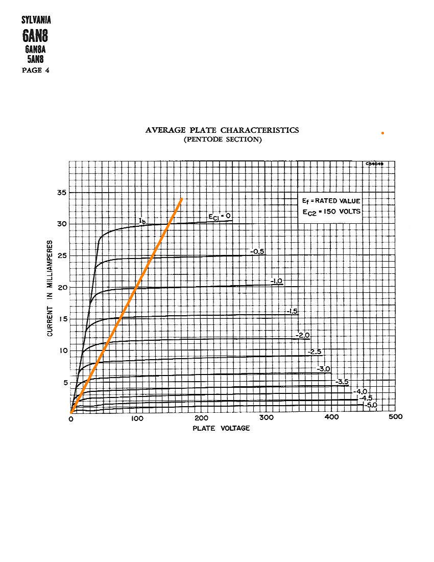

Pentode Screen Resistance (rs) Estimation Example

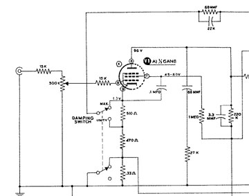

🙂In the Heathkit UA-1 12W Amplifier we see a 0.1 microF capacitor bypassing a one Meg resistor supplying the screen current. We might think that we can simply take that RC time constant & easily estimate the low frequency rolloff. But we would be dead wrong & get a result with a gross error.
The actual R the supply resistor is driving into is the screen resistance, analogous to a plate resistance of a triode. So the R in the RC time constant then becomes the parallel resistance of the screen & supply resistances. The problem is complicated by the lack of any published data with regards to screen resistance.
Fred Terman (And Wm. Hewlett) tell us that screen resistance for a pentode can be estimated as follows-
rs = ( ( Ib + Ic2 ) / Ic2 ) * Rp
From this we need to know 6AN8 triode connected pentode Rp, another spec not published for the 6AN8. For the attached 6AN8 pentode plate family draw a line from the origin to the intersection of the Ec1 zero bias curve where Ec2 & the plate are at equal voltage. In this example that would be at 150 plate volts.
Triode plate Rp for the pentode section at zero bias is approximately as follows-
Rp ~ Change of Eb / Change of Ib
From the 6AN8 Average Transfer page, Change of Eb = 150 Volts
& Change of Ib ~ 28mA (plate) + 9mA (screen)
So triode Rp ~ ( 150 / 37 ) K or 4.05K

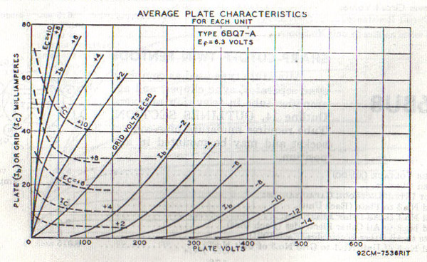

Aside from the scale factors of voltage & current all common triode plate families look very much the same. As an example refer to the 6BQ7 plate family. When G1 bias is increased plate resistance increases. As an educated guess we can assume Rp for a triode connected 6AN8 pentode section to be something like 10K at the operating point.
Using the typical operating currents split on the 6AN8 pentode we get-
rs ~ ( ( 9 + 2.8 ) / 2.8 ) * 12K
or rs ~ 42.1K
That is the number we need to compute the rolloff frequency of the amplifier front end.
The R in the RC calculation now becomes rs in parallel with one M.
So R ~ 40.4 K, a factor of about 20 times different than where we started.
RC = 0.0040 sec F = 0.159 / RC Hz 39.4 Hz
Looks like it is a step built in as part of the NFB stabilization circuits.

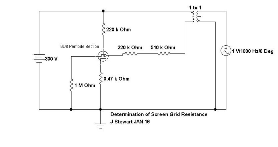

Measurement of Screen Resistance
🙂Described is a way of doing the actual rs measurement. I used a 6U8, simply because I had one. And the example has cathode degeneration which would modify the result. But if NFB is brought to that point as it often is the result is very close.
More later.
This method could be used for any pentode or beam tube. Keep in mind we are looking for 'order of magnitude' only. NTL, useful for design purposes.
There is a slight error in the original post text, the guess of Rp for a triode connected 6AN8 pentode section to be something like 12K at the operating point. I'm surprised no one picked that up!
Enjoy & report any errors!

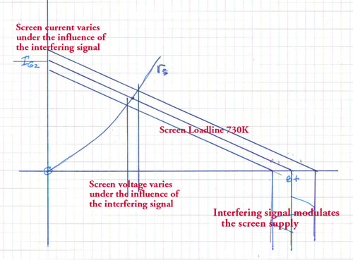

When designing or building an ordinary vacuum tube audio amplifier with a pentode front end we can for the most part ignore the screen supply resistance. Simply set it to be in the range of 3-4 times the plate resister & the circuit will perform satisfactorily. As long as the screen resister is adequately bypassed there are no significant problems.
That all changes when the intention is to use NFB. Most folks would assume that the RC time constant is simply the screen resister times the screen bypass capacitor. That can lead to problems since the screen supply resister is actually in parallel with the resistance of the screen grid itself as seen looking into the tube. Some calculations using the available published tube data indicates the screen resistance of common audio voltage amplifier pentodes to be in the range of 40K.
This simple setup makes measurements leading to the incremental screen resistance of the pentode section of a 6U8 vacuum tube while in operation. The tube is connected to a plate supply of 300 volts. The screen is fed from this supply thru a total of 730K resistance. But interposed on that is a means of applying an interfering One KHz test signal. Any audio transformer of high impedance primary & secondary can be used to couple the audio signal generator to the high voltage on the screen. I used an old Hammond 447 IT.
Just two measurements are required. Using a differential probe the AC voltage drop across the 730K is measured, then the AC voltage from common to screen.
The results of two levels of drive voltage are as follows-
First Pass- Drop across 730K was 0.9V
So Ig2 is 0.9 V / 0.73 M, 1.23 mA And Eg2 measured 0.043V
So rs is DE / DI rs = (0.043V / 1.23 mA)K or 35.0K
2nd Pass- Drop across 730K was 2.83V
So Ig2 is 2.83 V / 0.73 M, 3.88 mA And Eg2 measured 0.133V
So rs is DE / DI rs = (0.133V / 3.88 mA)K or 34.3K Done

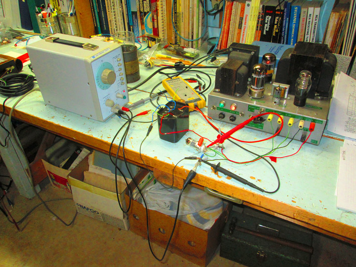

What impedance does the probe add to the circuit? Do you just move one differential probe around?
I'm using a using a PicoTech MI053 Differential Probe. The load presented to the cct is 4M & should have been included in the calc. In this measurement I used the PicoTech ADC-216, no longer available. It is 16-bit.
The measurement is quite a way off ground, so need lots of care while using these kind of ADCs. The front ends are spec'd only to 20V max, so the probe was set to 1000X.

Sampling the current on the primary would include the magnetizing current of the transformer. I wanted to remove as many unknown variables from the test as possible.
Since I have a differential probe that was the best way to a solution for me.
Cheers, John
