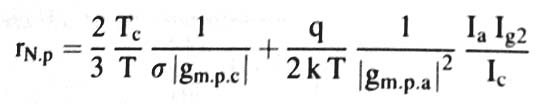

The result needs to have the dimensions of resistance. The left-hand term gets this by inverting gm.
The right hand term has current on top and gm^2 on the bottom. Keep one gm to the side as that gives us the resistance we are looking for.
The other gm on the bottom loses its current because of the current on top, leaving us with 'per volt' on the bottom - which becomes volts on top. kT is thermal energy, which divided by charge becomes volts. This cancels the volts on top - so the formula has the correct dimensions as it stands.
