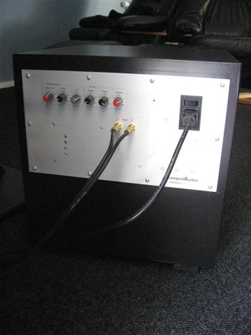

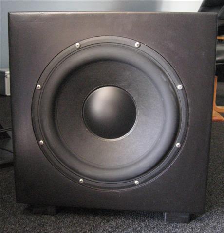

Well, the 12" XLS box I made is a complete success!
A 34cm sealed cube (~30L internal) made of 19mm mdf, no eq required. Ok, it struggles to pump out anything lower than 20Hz, but accentuates brilliantly the musical subtleties of any jazz music cd i try. I found it integrates well into any system using the custom 200W plate amp from stones audio. The XLS can handle the full volume of this amp in this configuration, just reaching max excursion, and pumps out enough sub-bass for my liking, so I don't have to worry about tearing the driver at max volume. Perfect size to take to mates' house parties!! Shakes windows on dvds!
If you are interested in crystal clear bass reproduction, rather than thumping SPL, this could be the project for you!
I'm now saving for my next diy project: nice sounding 2-way speakers + decent amp 150Wx2 to complement this nice bass I'm hearing.
