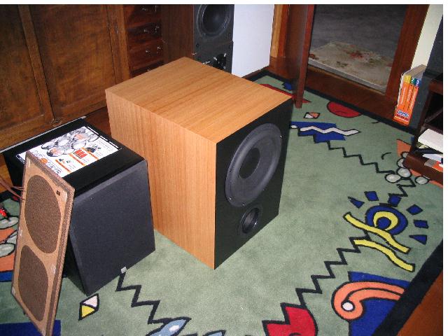

How about getting a single AE AV12 and two PR15-1400 15" passives in a 2.5cu ft enclousure? This is my setup only with a Rockford Fosgate sub and I've modeled both versions. The AV12 will get down to about 19.8 Hz and will work well with a 500watt plate amp. Mine plays down to about 19.5Hz but I use a Crown K2 amp. My box is 2.5 cu ft internal volume, and is made from two layers of 3/4 inch MDF. Internal dimensions are 12" wide, 18" deep, and 20" tall.
AE site:
http://yellow.mynethost.com/~bv126368/shop/catalog/
My sub:
AE site:
My sub:
