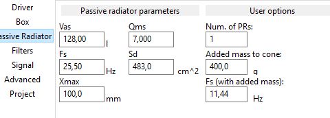

I tried to model it in winISD, but not really working.
If I add the numbers from the application notes, the numbers are not the same.
Got no idea, if the d=9cm is the outer or the inner of the tube?
WinISD uses or net volume? Or I have to add the port and the displacement too?
Is it worth it to buy a PR, (spl and quality wise) or if I follow the app. notes, it will be OK?
BTW the app notes numbers are for net volume?
For winisd:
Tube diameter = inner measurement
Vol = net volume

See pictures for the T/S parameters I use for sim'ing the SLAPS M12. Not 100% sure these are correct, so it will be a little try and error. Build a cheap box first to try it out. Then you can later make the perfect box for it, when you are sure.
I will try out 30 liter myself firstly, and then just use a bit more power, to get the XLS to max out. With a tuning of about 26 Hz you'll need 600W (use a class d amp for this and an SMPS) ... resulting in 106 db @ 25 Hz
The SLAPS will only move +-28mm at 25 Hz, so plenty of headroom here.

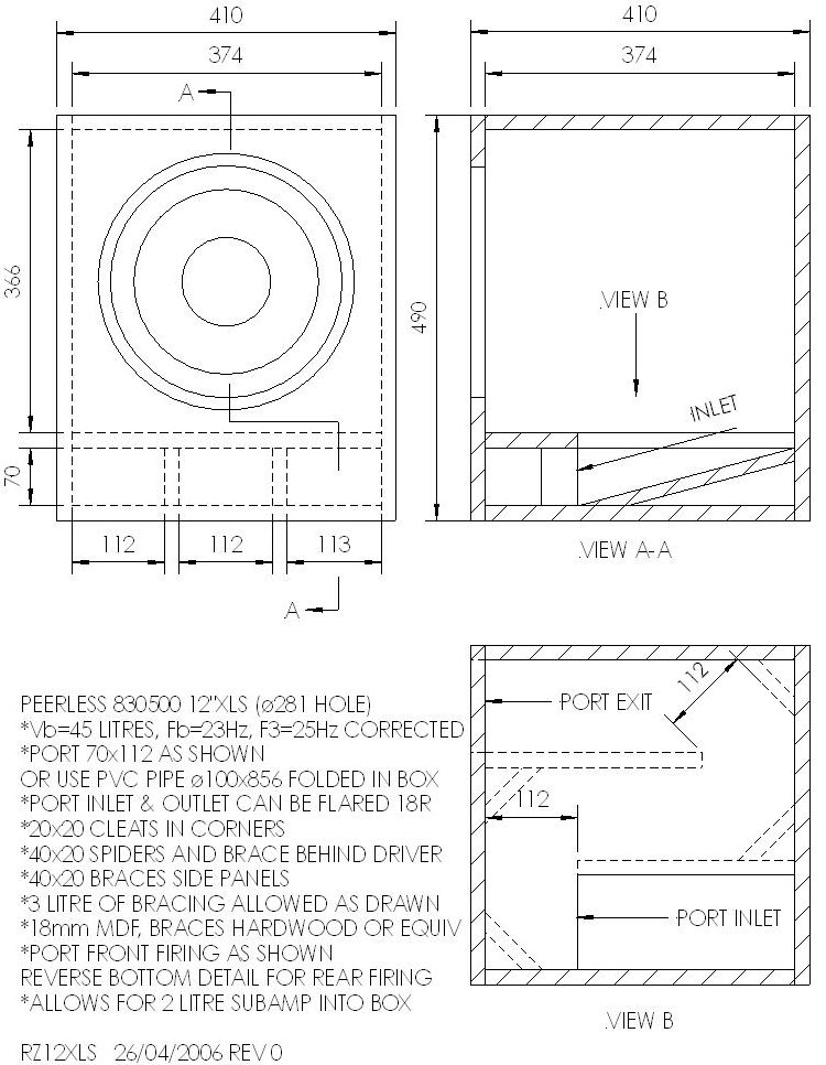

Back in 2006 I did a design for the XLS12 that used a rectangular port on the bottom of the box. The outlet is not shown in the front view of the sketch but have a pic of it. It has been suggested that the angled pieces in the corners of the port are not necessary. This only added 88mm to the height of the box and there is no reason why it couldn't be added to the rear or side as long as the effective port length remains the same.
