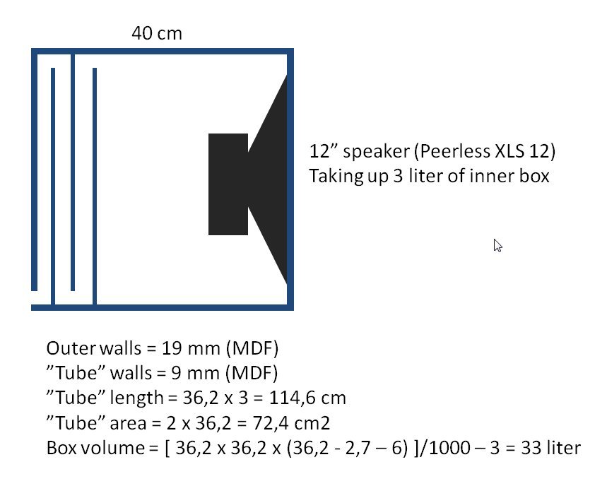

Back in 2006 I did a design for the XLS12 that used a rectangular port on the bottom of the box. The outlet is not shown in the front view of the sketch but have a pic of it. It has been suggested that the angled pieces in the corners of the port are not necessary. This only added 88mm to the height of the box and there is no reason why it couldn't be added to the rear or side as long as the effective port length remains the same.
