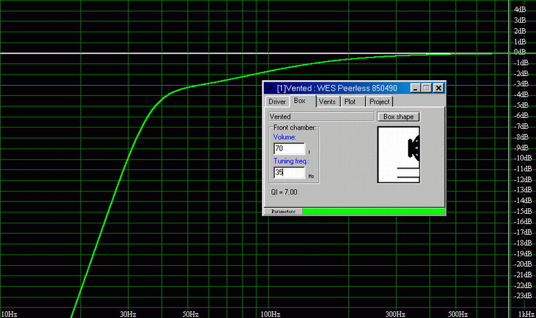

Try modeling the two 850490's in 70L, tuned to 35Hz, I show an F3 of 39Hz and reasonable group delay curves.

Scott, thanks for your comments.
I have tried the 850490 as suggested and the graph is attached. Shows an F3 of 53hz. Eek!
BTW, Gert Christensen of Peerless in Denmark suggests a 70L box tuned to 40hz gving an F3 of 40hz with a 60 x 30mm (d x l) port. Mmm. Those parameters don't look good in WinISD or as I recollect, in Unibox.
Quite frankly, the CSX 10" gives a much more satisfying curve and it's only a couple of dollars dearer than the 850490.

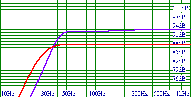

B) Like I said, that curve isn't bad for the two HDS versus the 10 incher. I will post below. This is for the stated HDS specs, except I adjusted the sensitivity down -1.3 dB to match Peerless' own graph. the box is 80 Liters, both are tuned to maximum tuning. Going between 26 Hz and 30 Hz changes little.
The CSX 10 incher is in red
The HDS 8 onch pair is in blue

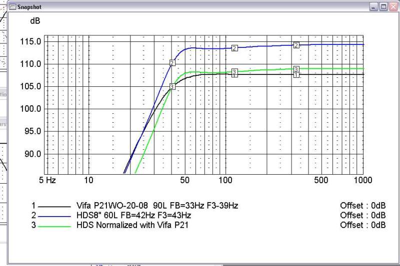

Okay, within the differences that can be expected between modeling software I get about the same numbers you do.
I've attached a graph comparing the Peerless HDS 8" and the Vifa P21 8" woofer. Maximum output, and alignment. I doubt you'd here that much difference between the two bass alignments, but you will definately hear the difference in maximum output, distortion and power handling.
The woofers are set to maximum output by setting the excursion to maximum listed linear excursion above the tuning frequency. Below tuning frequency these alignments excede excursion limits, but this method is very common when deciding what woofer to use. If the F3 is relatively low<45Hz or so, it's rarely a problem in real life. For those little woofers with little cabinets, it can be an issue.
Scott
