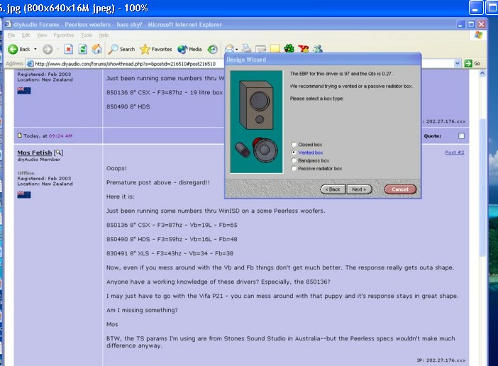

Peerless woofers - bass shy?
Should have mentioned: this is 2 x 850490.
And, the specs used are the measured specs from the Australian distrivutor of these drivers. They vary from the Peerless specs but I've also plugged the Peerless specs in and the basic rersponse is not that different.

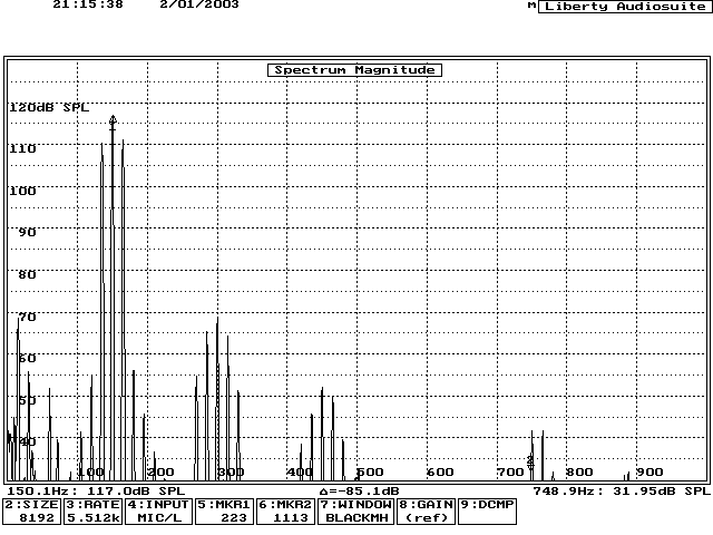

This isn't only a factor at very high excursions. In one of my prior day jobs I built RF amplifiers that worked over a very large frequency range (for RF devices that is) from 88MHz to 860MHz and 460MHz to 860MHz. Each one of these amplifiers had to deal with a lot of separate signals.
The reason I bring this up is that every driver in a speaker system has to deal with a lot of simultanious frequencies being applied to it. I am VERY familiar with this concept. Each of these signals can be relatively small, but occasionally the maximum for each signal can line up in time to create a very large signal. If the speaker (or amplifier, or microphone or...) can't handle this it's called intermodulation distortion.
The Faraday rings in the Peerless (and Scan-Speak, Seas Excel and some other very high end drivers) reduce this type of distortion a lot! I don't have distortion data on a Vifa P21 series driver, I wish I did to compare, but I haven't measured any drivers without a Faraday ring that have distortion as low as a competitor that does. (I posted the intermod distortion performance of the CSX 8" driver earlier in the thread....it's quite good for the money.)

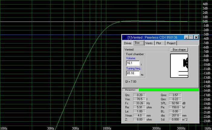

Plus, I found it strange that such a good driver with a low FS like the 850490 was showing that suggested configuration in WinISD. I assume that's WinISD and not the driver at fault there because a suggested F3 of 60hz certainly doesn't look impressive for an 8" driver.
No, it's perfectly reasonable. You've got 2 drivers in 32L, which is 16L each. The sensitivity of the driver is listed at 91.2dB so, 60Hz is about right. I just looked it up on my spreadsheet, in 20L with an F3 of 60Hz the theortical upper end limit for sensitivity is 91.6dB for a sealed system. I can't find my vented system spreadsheet right now.
If you're asking yourself about all of those "bookshelf" speaker systems that claim 89dB sensitivity and an F3 of mid to low 40's, well they are pretty much either lying or taking room gain, where the room boundries enforce low frequencies into account.
Try modeling the two 850490's in 70L, tuned to 35Hz, I show an F3 of 39Hz and reasonable group delay curves.

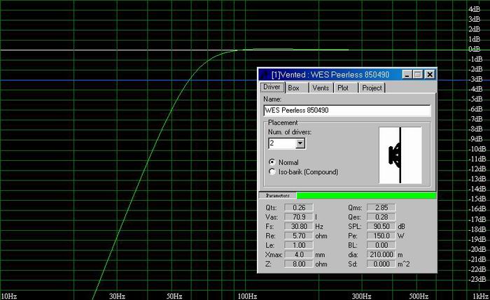

Scott, thanks for your comments.
I have tried the 850490 as suggested and the graph is attached. Shows an F3 of 53hz. Eek!
BTW, Gert Christensen of Peerless in Denmark suggests a 70L box tuned to 40hz gving an F3 of 40hz with a 60 x 30mm (d x l) port. Mmm. Those parameters don't look good in WinISD or as I recollect, in Unibox.

Can you post the woofer parameters you are using? I can't seem to download a valid spec sheet for the 850490 from the Australian company you mentioned. I don't get an F3 with my program or parameters (which are factory).
What configuration are you using to come up with an 84dB sensitivity for two woofers? I'm confused. (again..must be the lack of coffee)
Scott
84db - I think he means 94db (2 drivers at 91db = 94db according to WinISD).
"F3 of 53hz" , but thats 92db at 50hz!
Now if you set your reference at 92db, the f3 occurs at 40hz - it's all relative.
I would go with Peerless suggestions & use two 850490 in a 70l box fb 40hz. As for the lower impedance if you use a large inductor with highish DCR say 1.5ohm then two drivers paralleled at 4ohm + 1.5 = 5.5ohm which is quite acceptable.
Scott:
Sorry, thought I'd replied to this.
Measured TS for Peerless 850490:
FS=30.8, Sens=90.5, QTS=.25, Qes=.28, Qms=2.85, Vas=70.9, Z=8, DCR=5.74, PE=150w rms
And, sorry, I did mean 94db. Thanks AP.

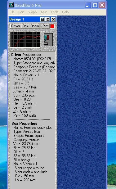

Hmmm.. my speaker boxes are HOPEFULLY going to contain 8inch Peerless woofers... (850136) The cut out for these drivers is 197mm.... I designed my boxed to have a 200mm internal width... now that I have cut the wood, its only 199mm and I have a feeling this is going to become slightly less when I attach the baffel... OHH NO!! lol wait.. nah, its okay.. lol

Okay, within the differences that can be expected between modeling software I get about the same numbers you do.
I've attached a graph comparing the Peerless HDS 8" and the Vifa P21 8" woofer. Maximum output, and alignment. I doubt you'd here that much difference between the two bass alignments, but you will definately hear the difference in maximum output, distortion and power handling.
The woofers are set to maximum output by setting the excursion to maximum listed linear excursion above the tuning frequency. Below tuning frequency these alignments excede excursion limits, but this method is very common when deciding what woofer to use. If the F3 is relatively low<45Hz or so, it's rarely a problem in real life. For those little woofers with little cabinets, it can be an issue.
