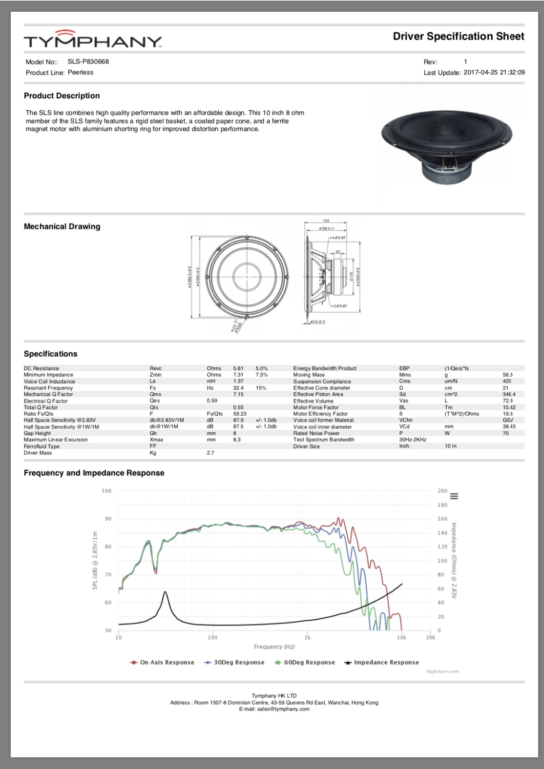

-better upper bass punch is usually the result of a higher mass driver with a much stronger motor. -look to lower Qe first, and then Mms second. In general look to a higher Bl. The 830668 isn't exactly ideal in this instance. 😱

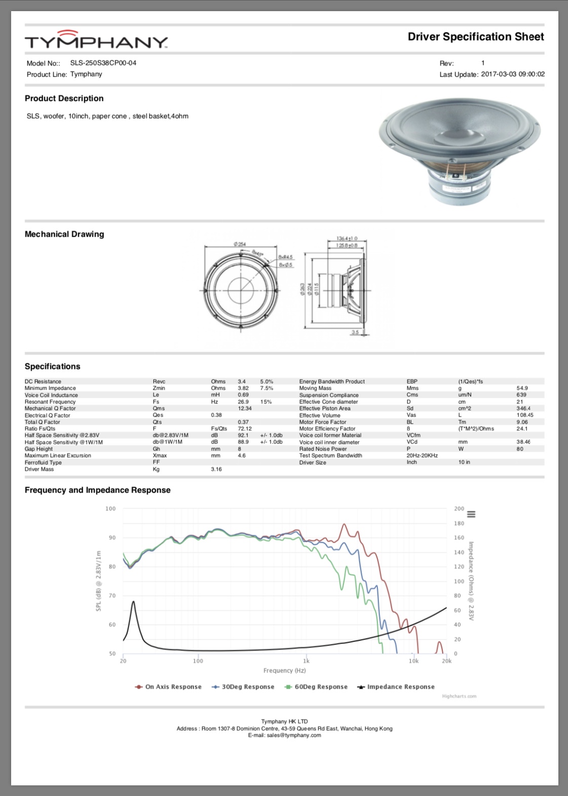

This one will give you more "punch" (if at the cost of excursion and some bass extension near the average):
Peerless by Tymphany SLS-250S38CP00-04 10" Paper Cone Woofer 4 Ohm
Note: Bl is lower simply because of the 4 ohm VC, and as Juhazi mentioned: wired in series gives you that 8 ohm load (..though in a powered subwoofer I prefer parallel assuming the amplifier can handle it).
Thanks Scott. This is interesting. If these charts are correct then the SLS-250S38CP00-04 extends much lower then the 830668. Weird because the 830668 is dubbed as a Subwoofer and the SLS-250S38CP00-04 is dubbed as a woofer. Looks like the response is also much more flat overall.
Does that mean it will extend a little lower than the 830668 in a 1ft enclosure as well?
Also, whats up with the huge drop in spl right around 25-30hz in the 830668???

Both driver's have a pressure dip just below Fs, it's just than one is more "narrow" in bandwidth. The higher Qm (suspension) probably gives it a bit of gain below this area that generates an exaggerated appearance of a "dip". As to what actually generates the dip, I don't know - but I'm guessing it's a lack of force/control relative to the suspension.

Put the driver in a sealed box and that "dip" probably disappears due to the air spring effect. I do think you are thinking of crossing far too high tho. As you are going to be using digital DSP tho you have a lot of room to experiment in. What is the resonance of the speakers you will be using as tops? If you know it that is.

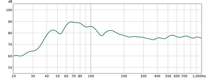

I have the 830668 in a 1 cuf box, crossing over at 300Hz.
There is no problem running it up that high.
There is a large peak at 70Hz due to the small box, but if you are running DSP it is easy to flatten this and then add a boost below.
The guys are the Orion Owners Forum are using it in a box this size to extend the range of the LXMini.
Here's a quick 1m measurement (no EQ).
