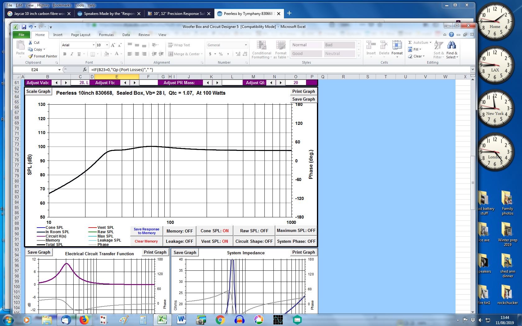

I ordered two 2x10" sealed vertical cabinets that will serve as both subwoofers and stands for a pair of bookshelf speakers. I am buying a Minidsp SHD and will be using room correction and active crossover between the bookshelves and the subs. I will be playing around with different crossover points and curves to find what works best for me, but I think I will be somewhere in the 250-500hz range.
Are the Peerless by Tymphany 830668 are a good choice for this setup? Are there better options out there for the price, or will these do just fine? The enclosures are 2 cubic ft a piece, so 1 cubic ft per sub.

If you give it about 10dB at 30 Hz with a wide "Q" you should be able to pump 100 watts into it before it exceeds X-Max
I can't judge whether or not it will sound good, but either way I would stuff the box well and adding in a resistive port might be a good idea

Hmmm, I would definitely NOT suggest a vented alignment for the 830668. The Qts is rather high. MFG spec is Qts=0.55. That's too high for vented, and you would need a HUGE box.
The 830668 is an "old school" woofer that is best used in a large box, not in a small box with a boost at low frequencies.
One 10" sub that could works well for you in 1cuft is the Dayton RS265HO-4. This driver is a true modern subwoofer designed for small volume sealed enclosures. You will still need some boost of about 3-6dB around 25-30Hz to extend the response and in 1cuft it can handle 200W or so before reaching Xmax (that's per driver, for two of them you will need two 200W channels). Do not parallel the drivers, because they are already a low 4R load, each. I would get two 200W class plate amps and use one per driver.
