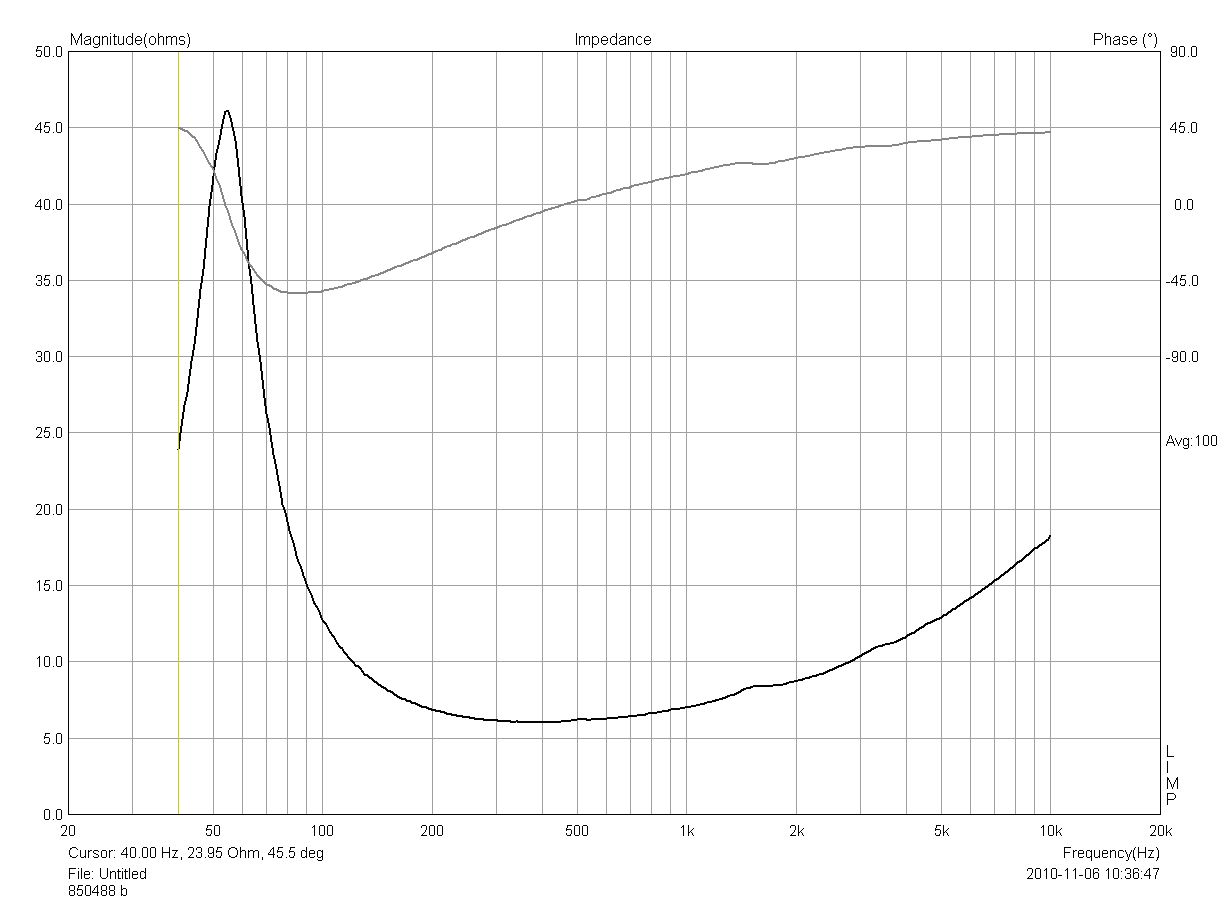

Hi bobica, I have a pair of these, very happy with them, they're in my ' No 1' system.
I haven't measured them yet, bought them several years ago when I didn't have measurement capability and just used the manufacturers specs to calculate crossover values, but recently have been thinking of testing them with ARTA and re-jigging the xovers to see if I can do better. Give me a couple of days and I'll see if I can do it, (got a busy weekend coming up)... (Can't measure distortion, but at volume they sound much cleaner than any other drivers I have)

OK, I measured each driver 3 times, here's the average TSP (They were pretty close each time, except for Vas which I found hard to get consistent, but that seems to average just below the published figure of 7.6L)
Re - 5.2; Fs - 54Hz; Qe - .35; Qm - 2.73; Vas 7.2
Impedance curve attached
