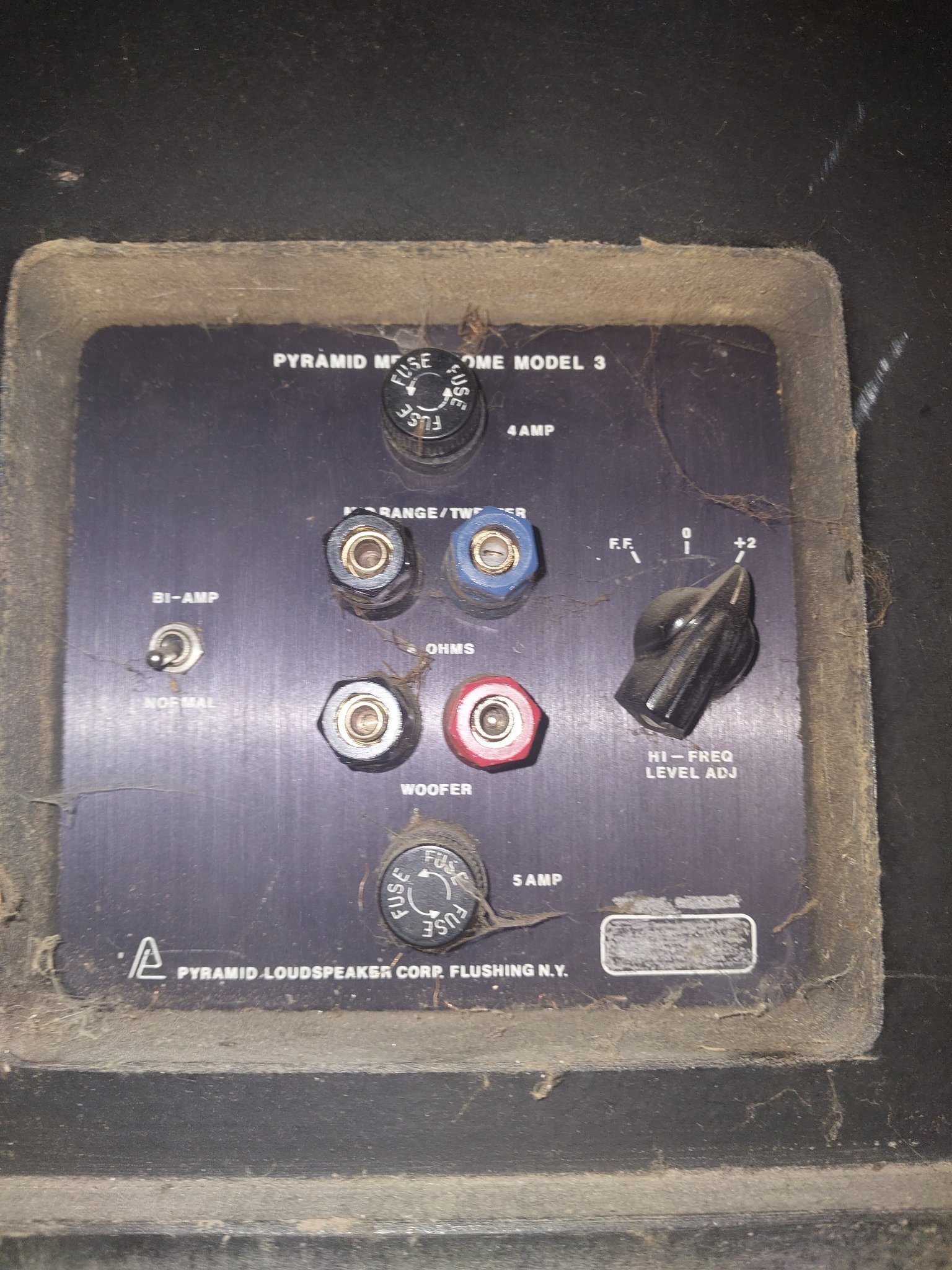

Peerless 4 ohm 4 inch sealed speaker info needed or replacement recommendations
Like where this plate is?
Supposedly there's a few drivers in there I guess and everything in them works, so do I haaaaaave to remove the driver? Or can I just put new speakers in? Like idk, I'm a noob at this rn, so I'm trying to cover all my angels, this box has the factory tar on it, and I really would rather keep it like that, the only thing that's been removed is the 2 4 inch mids, and the ribbon replacement I did.

Also what would I be testing for when I remove said drivers? Do I need an external setup to test? Or is it just a meter?
To keep it simple for a novice, I would measure each cone driver for dc resistance, push the cone lightly on the dustcap/cone to ensure normal movement without any scratchy noises, inspect the rubber/foam surround for cracks or disintegration signs, check that wire contact with driver terminal and crossover board is solid/clean, measure crossover parts with RLC meter or capable multimeter (capacitors, inductors, resistors, fuses) for their nominal values, reflow each solder point, check internal wires condition.

Ok, sounds way better . Tweeters work so they just staying i just made new ribbons i dont wana play with them again, and they are all tared in there, I have a small tear In the one woofer not big but I Wana replace the rubber foam whatever. So I'll start with that one and go from there.
