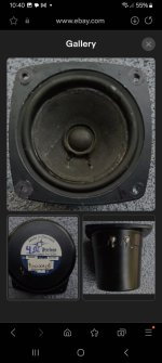

Supposedly there's a few drivers in there I guess and everything in them works, so do I haaaaaave to remove the driver? Or can I just put new speakers in? Like idk, I'm a noob at this rn, so I'm trying to cover all my angels, this box has the factory tar on it, and I really would rather keep it like that, the only thing that's been removed is the 2 4 inch mids, and the ribbon replacement I did.

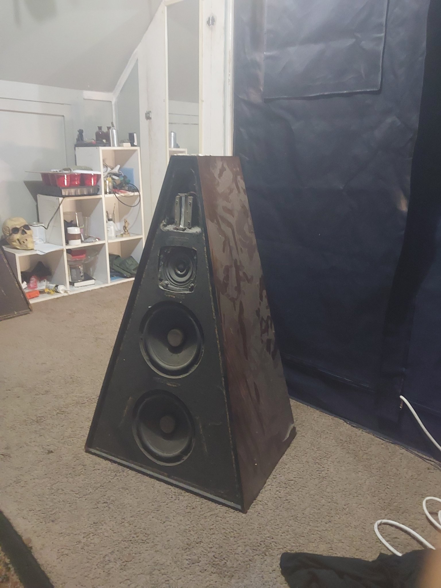

To keep it simple for a novice, I would measure each cone driver for dc resistance, push the cone lightly on the dustcap/cone to ensure normal movement without any scratchy noises, inspect the rubber/foam surround for cracks or disintegration signs, check that wire contact with driver terminal and crossover board is solid/clean, measure crossover parts with RLC meter or capable multimeter (capacitors, inductors, resistors, fuses) for their nominal values, reflow each solder point, check internal wires condition.
Leave the intimidating parts alone.

Ok, sounds way better . Tweeters work so they just staying i just made new ribbons i dont wana play with them again, and they are all tared in there, I have a small tear In the one woofer not big but I Wana replace the rubber foam whatever. So I'll start with that one and go from there.
