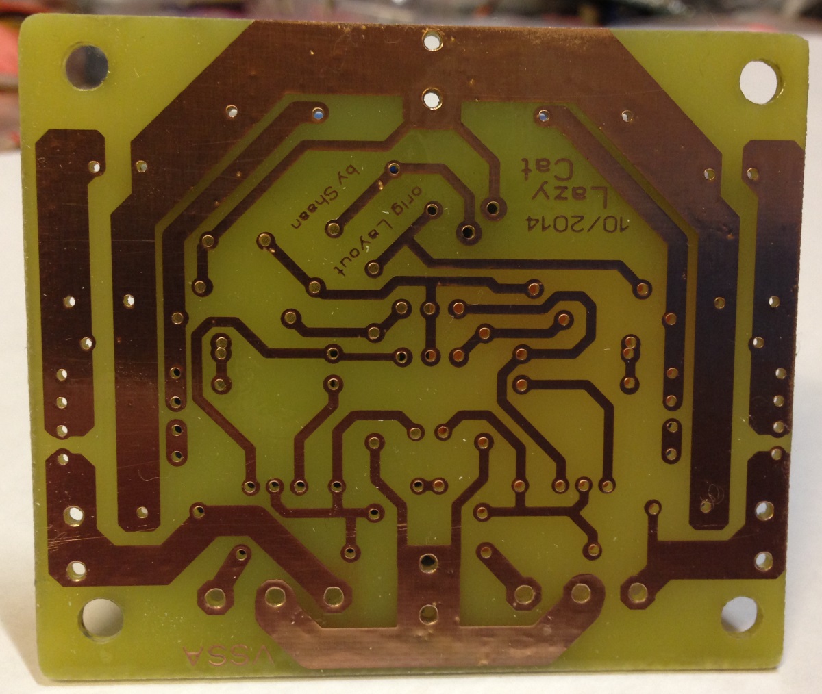

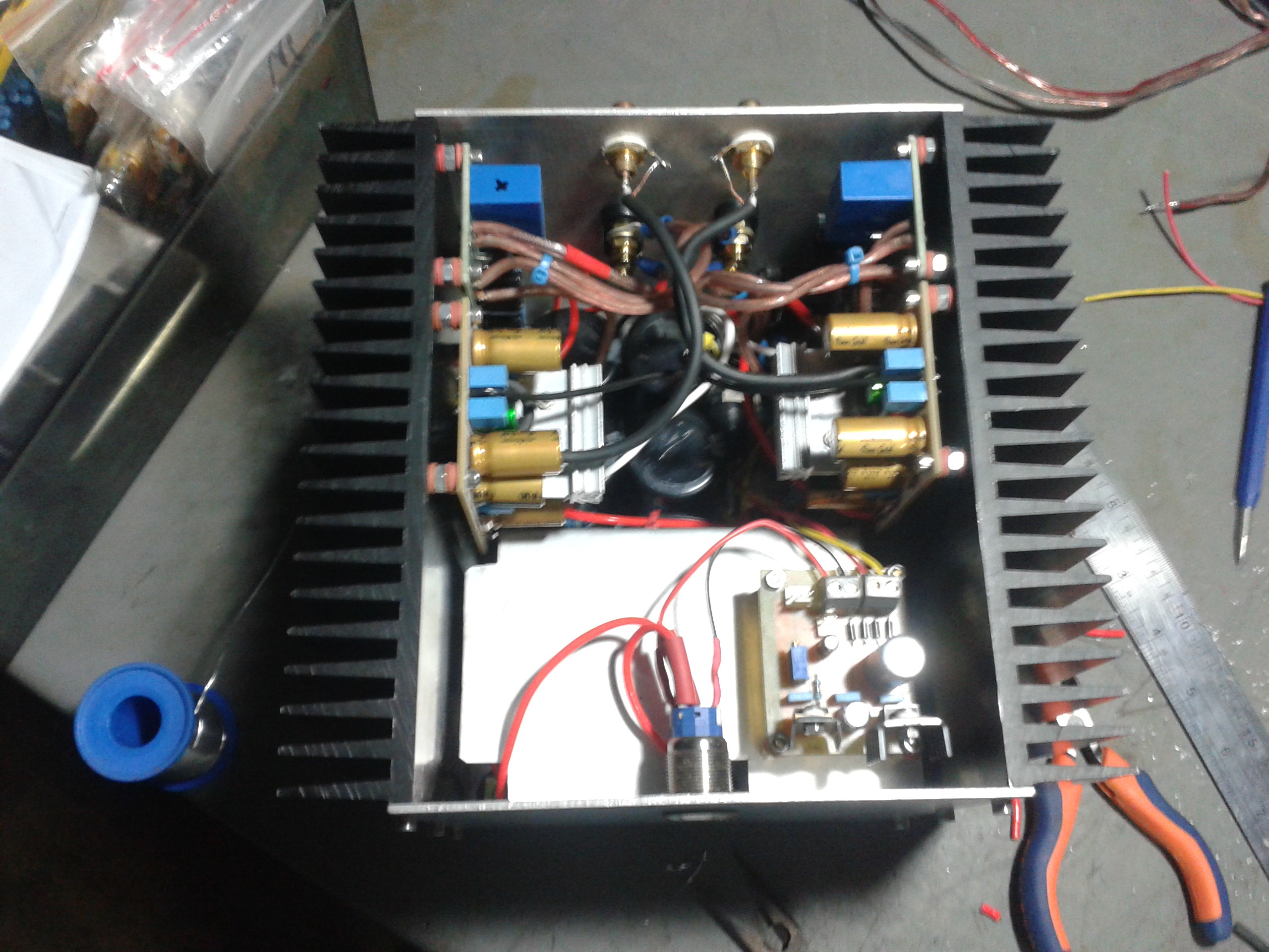

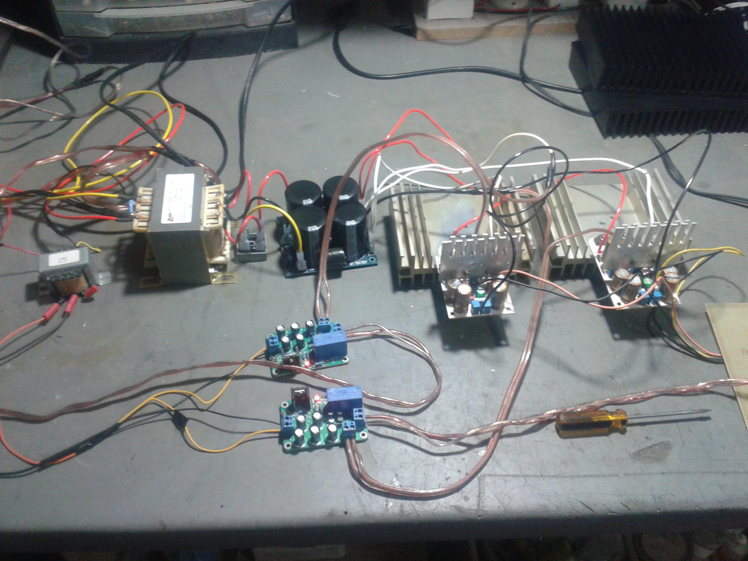

Good night people. Correct the mistake of pinning of IRFP240/9240 and now the lamp did not light series so I called the direct source and noticed that the BDs heat a little. Tomorrow I will test with load. In my BDS are mounting with the correct pinouts despite the error in the layout, I noticed it before assembling and reversed them. For me here in Brazil is difficult to buy original 2SK/2SJ, freight is expensive because of import taxes and the product tends to be retained for up to 3 months in customs. Working with electronics here in Brazil is complicated government explores other.

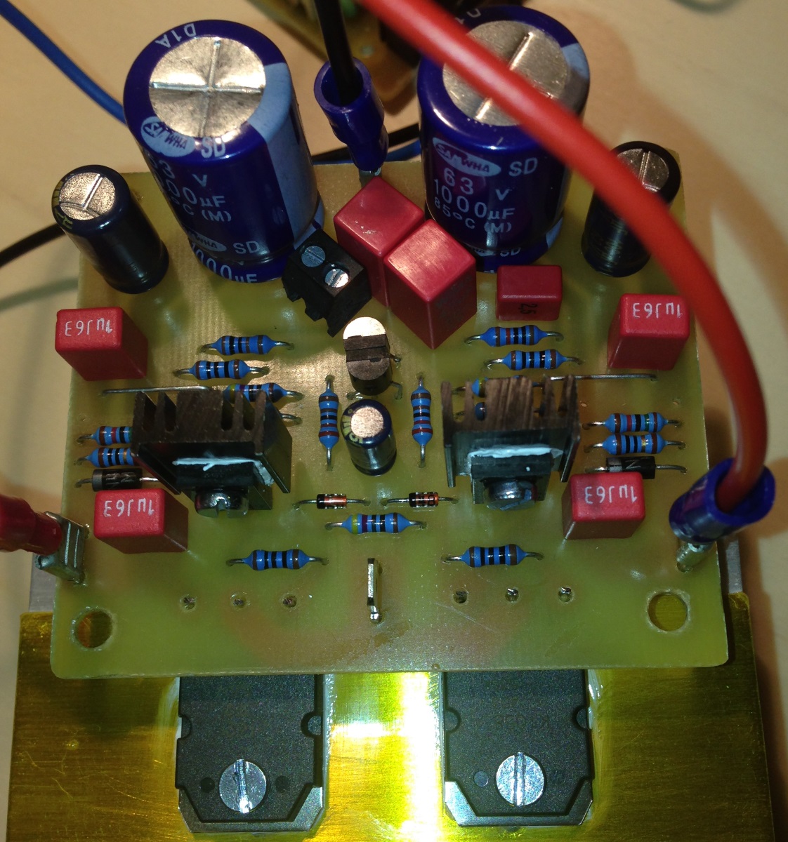

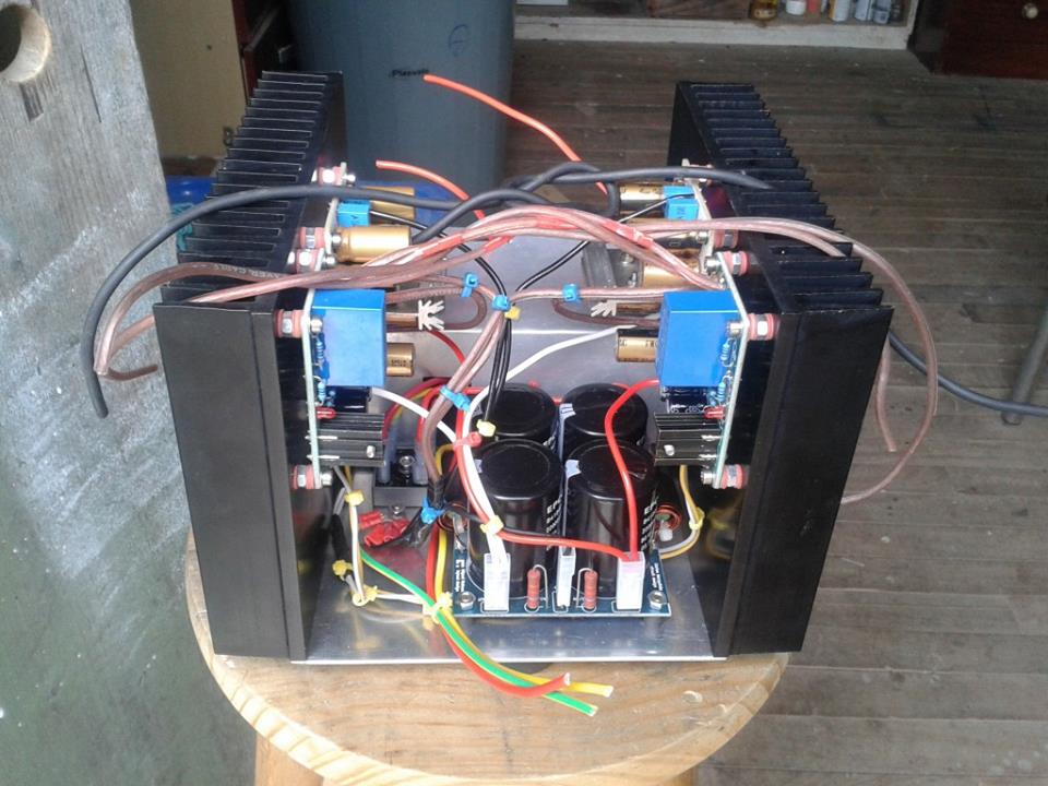

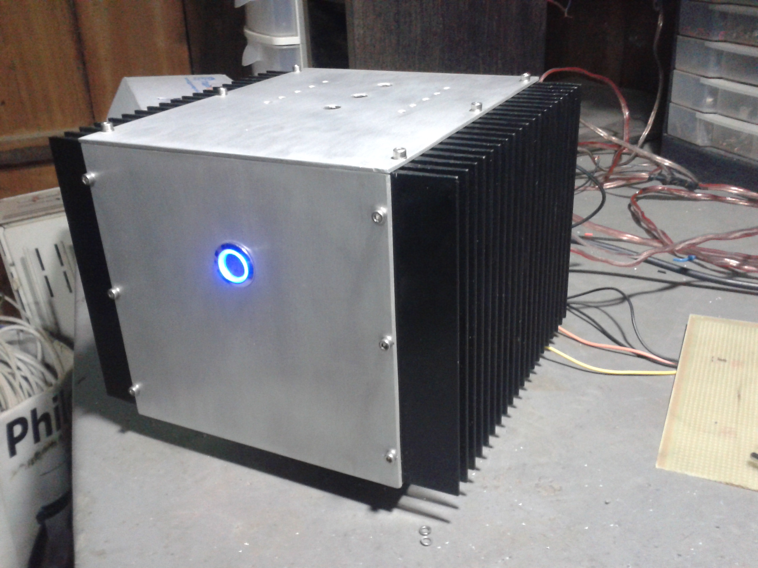

One more PeeCeeBee

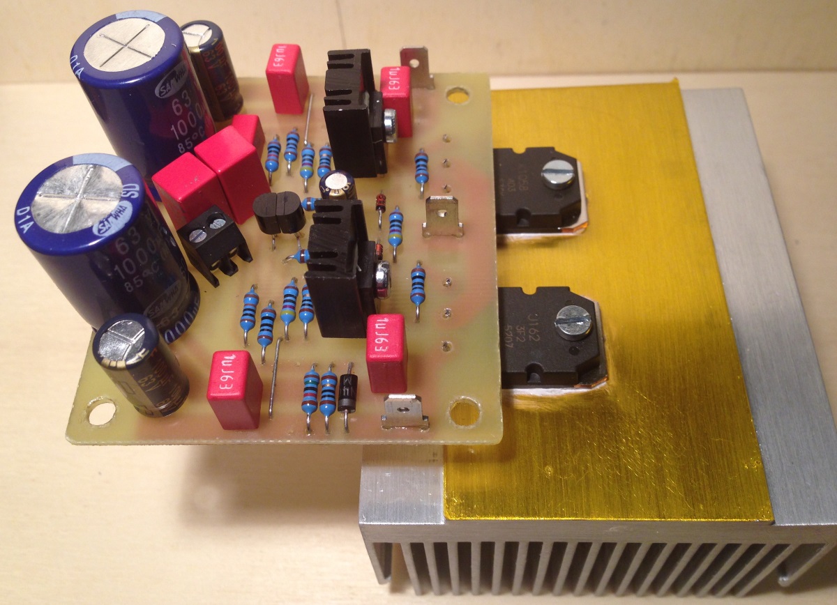

Hi, what a nice, small and elegant amplifier. I have made my own pcb ​​for components from the shelf. First result is a clean, clear and fresh sound without any noise or hum with a offset of 15 mV.
sure he gets a prominent place on the hit list 🙂
regards Olaf

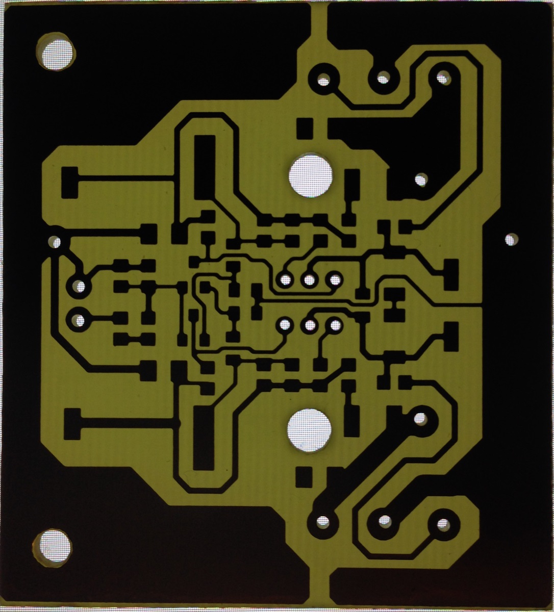

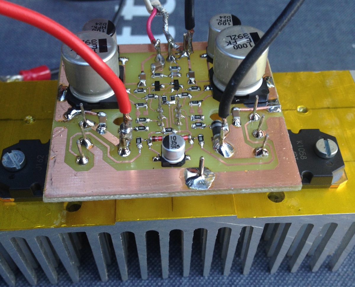

SMD-PeeCeeBee (Just for Fun)

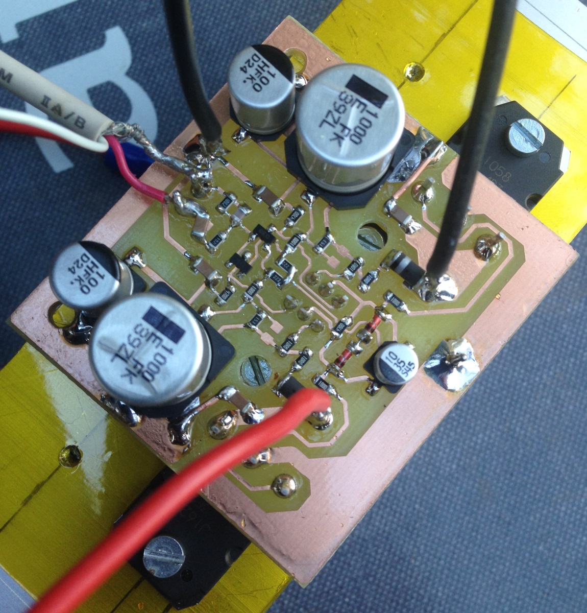

Sound is great, but so far only in the test environment with cheap car speakers. Runs + -36V. 16mV offset is without any adjustments.
regards Olaf

here are some files. But I'm not sure if everything is save for a long-term. For example, the 10R resistors in 0805. The heat sink is too small for a realistic test. Maybe I can even make a few measurements next week. But there is no real advantage to use SMDs, it's just fun 🙂.
regards Olaf
