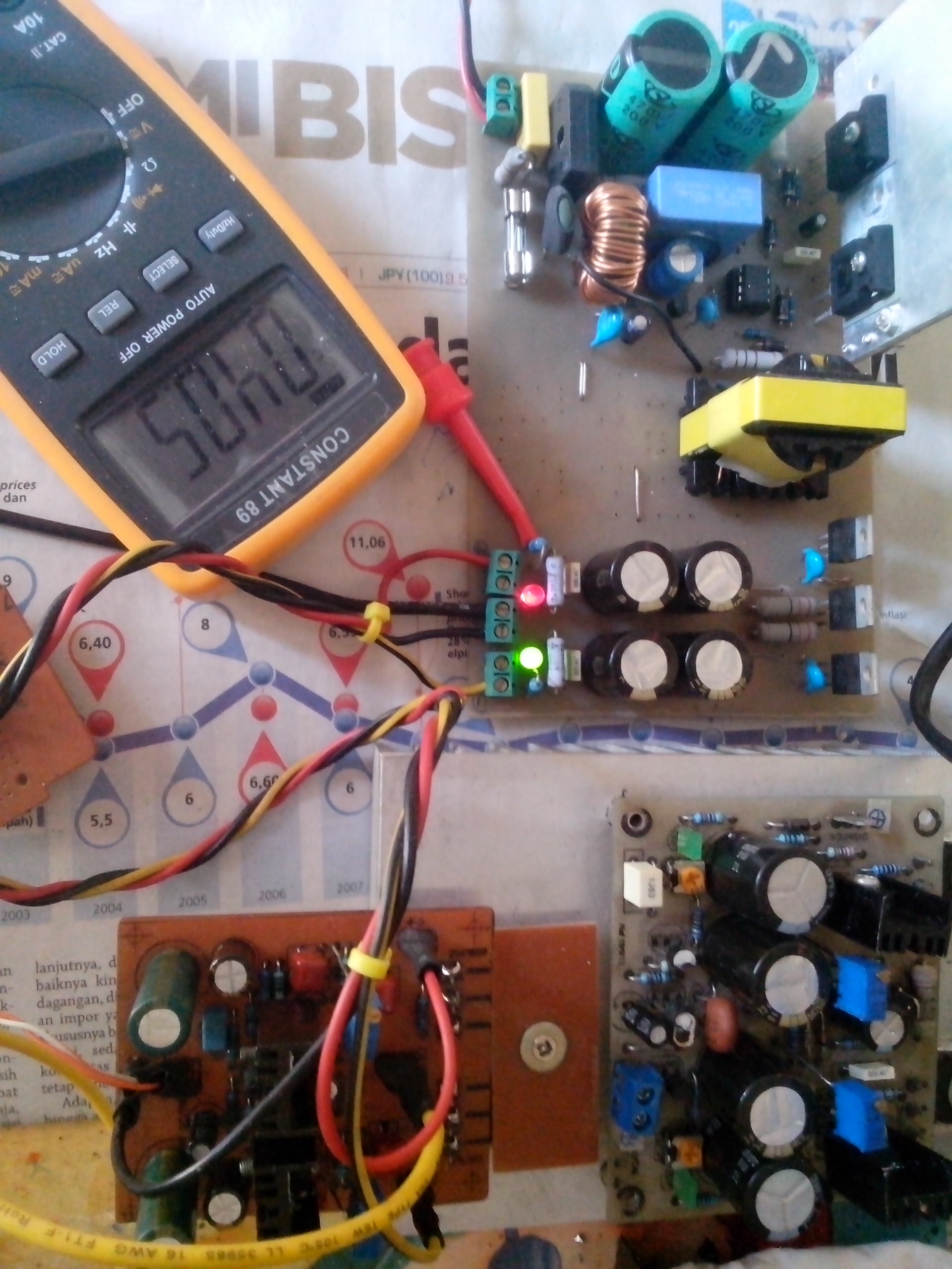

i've been using my own diy smps rated 300w 40vdc output. using ir2153 and cannibalized part from broken psu pc, my vssa peeceebee still rock! 😉
yes i read LC post on other thread .... but theres no problem with my vssa, been 2 month running my vssa nothing happen, no hum, no noise, dead quiet. my vssa peeceebee just getting stronger 😉. someday i'll etch my PMI's peeceebee version 😉

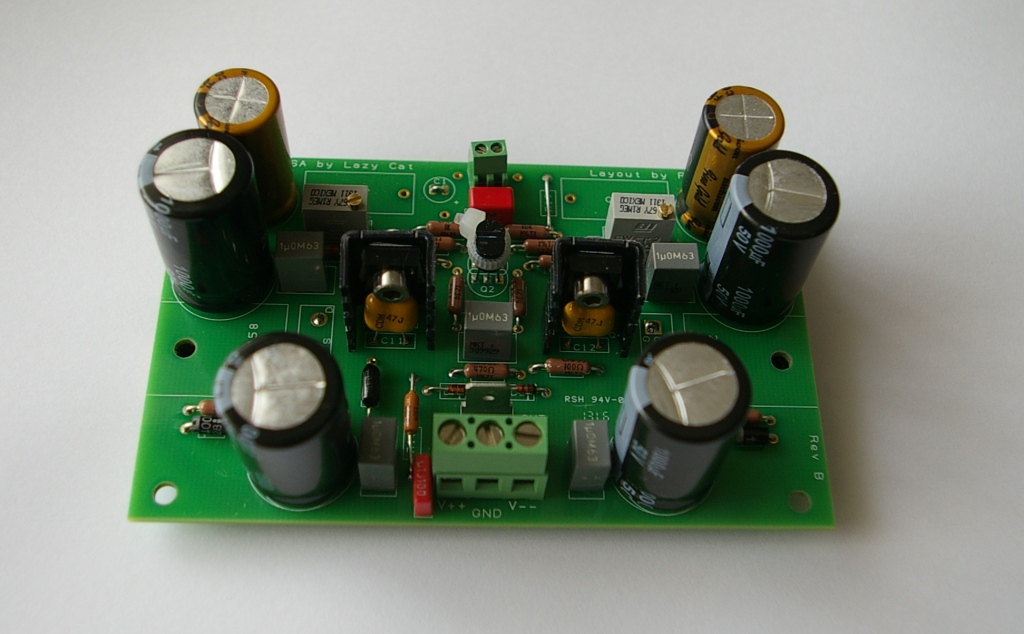

My parts arrived yesterday from Mouser and today it's fun time! 🙂
So far I've assembled one board.
I had to enlarge the holes for the thick legs of the 2200uF Fine Golds, otherwise it's been a pleasure soldering this pcb. The gold plating is a nice touch and the solder flows easily.
For the rails I went with panasonic FR (Fine Golds not available from Mouser at this time) and the low ESR of the FR's might be a good thing to have at the rails.
The VAS transistors are not matched - one is 80 and the other measures 150 hfe. I simulated this difference and the distortion is a little higher but just for a very tiny bit, no worries about.
Hi naf,
Will you be publishing your homebrew SMPS details at some point? It looks highly interesting!
With respect, I don't think that is allowed in this forum, because of safety and liability issues.
Although some SMPS are adequately isolated from the mains, many are not, and so there is some small, but real danger that another diy newbie comes along at some time in the future, reads you post, and does something that turns out badly.
yes i agree with PMI, and this is Shaan thread about vssa peeceebee so i can not publish it here.
but if you really want to build it, i could send you details how to build. consider you know the risk, smps is danger and i'm not responsible for any damage.
send me your email address via private message.

My intention with the p/s for this project is actually to go the other way, toward a cleaner and quieter linear supply (as I posted above, see pg 74), with a slower turn-on (longer turn on time), than a typical smps. Not so much to save the on-board resistors as came up in the VSSA thread yesterday, but to avoid exposing the on-board electrolytics to a large inrush current on power up, and also, to avoid any potential source of a "thump" on power-up.
A symmetrical design like PeeCeeBee, or VSSA is perfect to test that, because the rails draw about the same current at every stage, and the circuit should be stable during power up/down. This means that if you tune the power supply rise/fall time, you can reduce or eliminate one source of the turnon/turnoff noises.
That psu board is two-sided, but if anyone wants to etch their own, I will publish a single-side version which is electrically identical (somewhere else, not in Shaan's thread).
