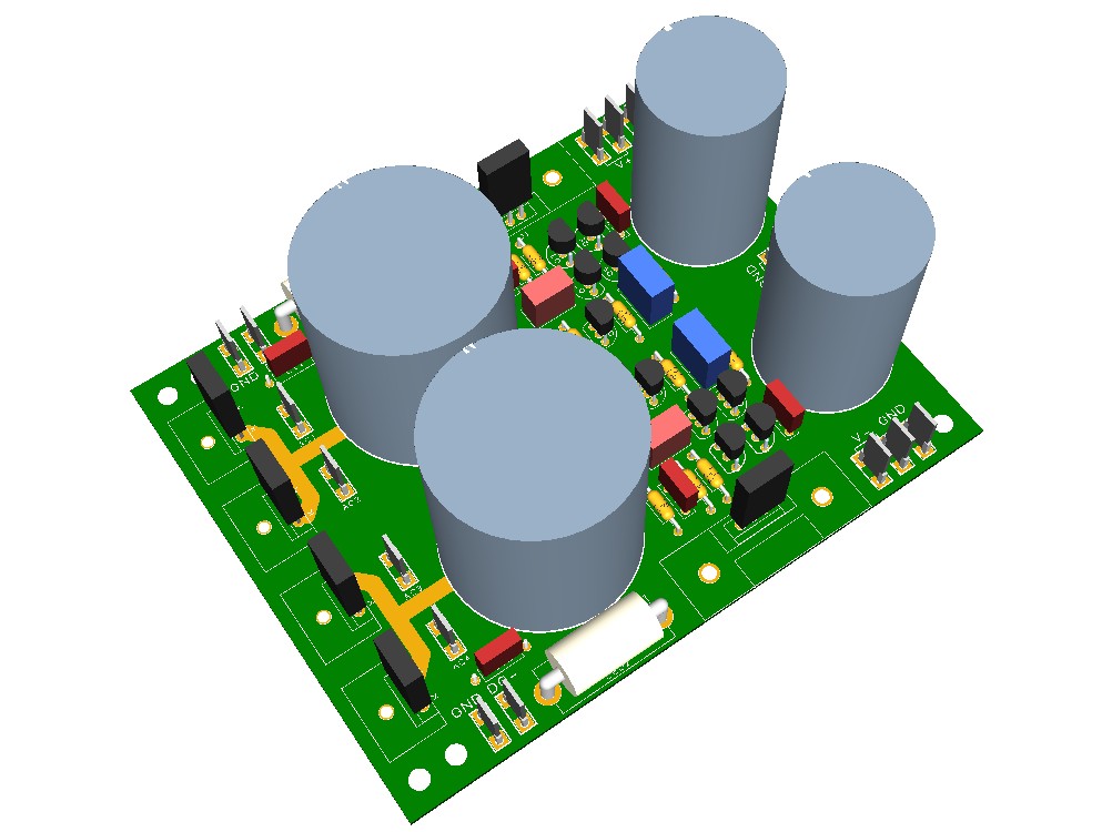

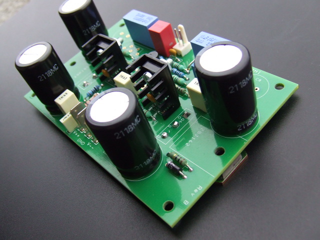

@Paulo: I experimented with power supply configurations a bit, but I have tried to keep that out of this thread, b/c it is already complicated enough.
First I tried 2x4700 per rail, later I settled on 3x4700 in a CLCRC configuration, but I am also working on a different linear power supply both for this board, and for the VSSA boards I got through the GB from LC.
The design I am using is from this thread, by MrEvil, similar to what you were describing, but the DC loss is very small, and the filtering should be just about ideal for this application.
http://www.diyaudio.com/forums/power-supplies/53359-finished-capacitance-multiplier.html
Component placement is done, layout is almost done, but some silkscreen and label issues are left. If you would like to help, or at least comment, your input would be very welcome. (a couple other people who have my boards are also helping)

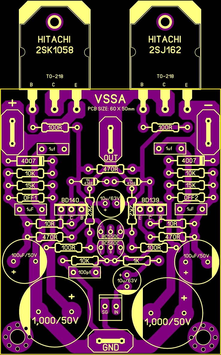

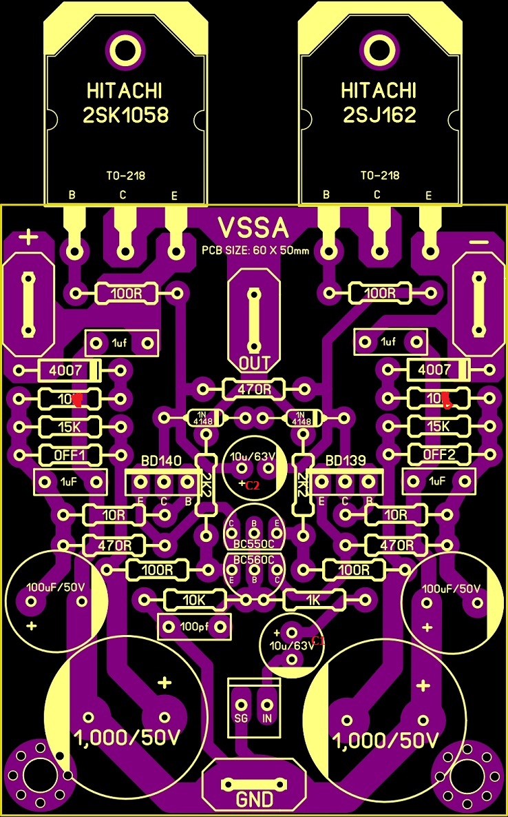

Hi LC/Shaan,
After reading the entire thread now it's time to build this PeeCeeBee, but before getting in to action i want to hear your input about this pcb.

Hi LC/Shaan,
C1 - better avoid electrolitic capas at input, i have plenty 10uF electrolitic caps (elna, rubycon, etc etc) and must say I am not appy with them. Better is to use even 4,7uF wima MKS2 (cheap and availible everywhere).
C2 - there will be around 1,4V max at iddle so voltage rating doesnt have to be that high, also make sure You have enough room for radiatior for vas stage.
The two resistors after diodes are 10R.
Thanks borys... what about nonpolar caps for C1?
