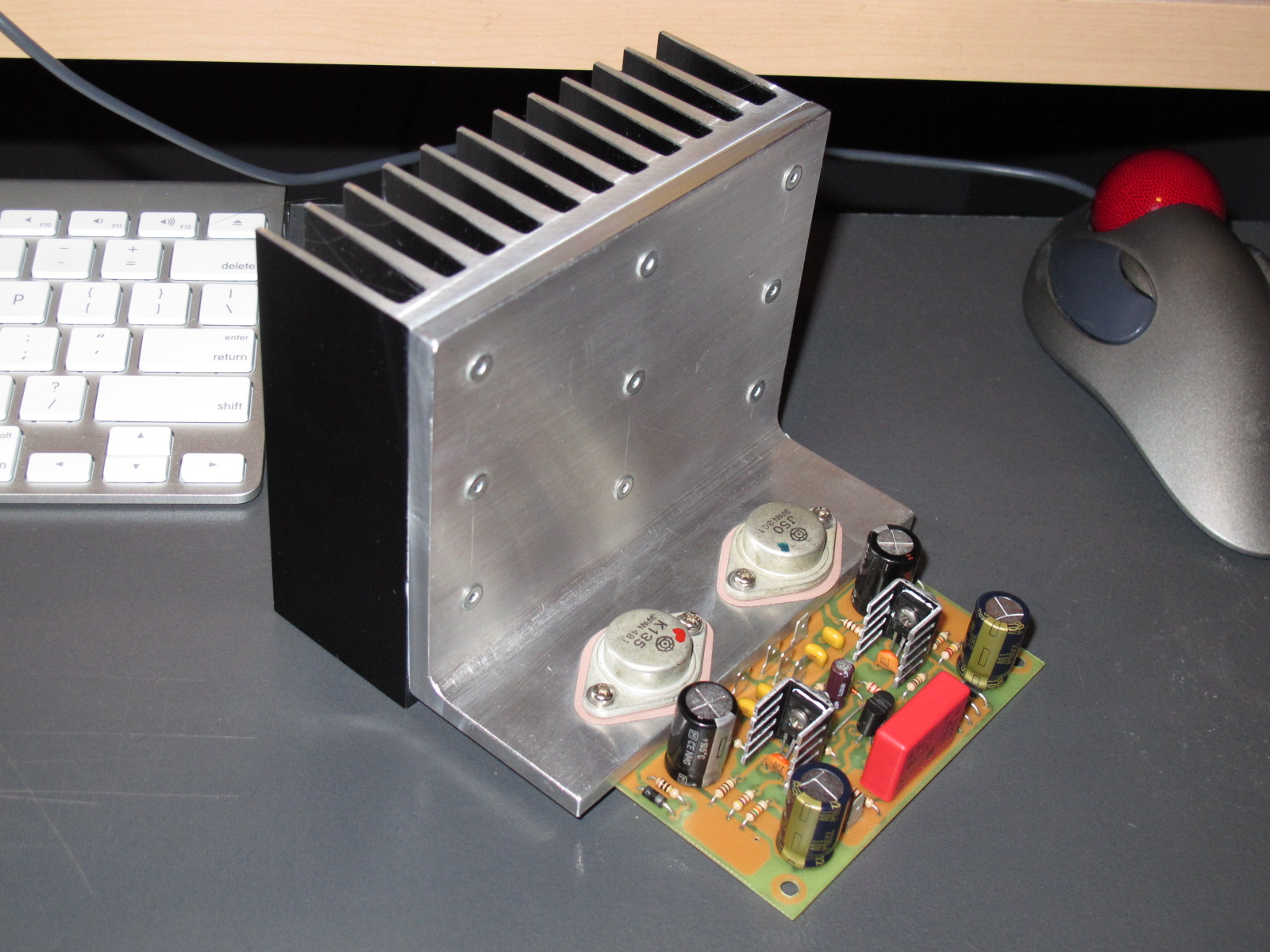

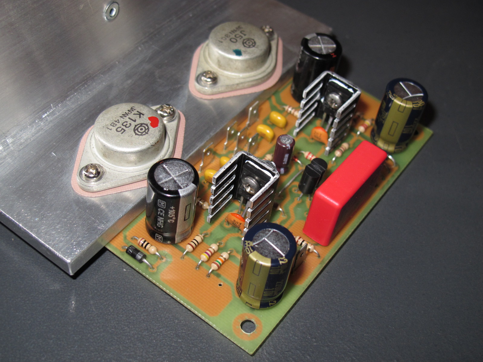

A little more progress
A completed module. Just need to prepare the other heat sink adapter and heat sink for permanent assembly.

Offset is set via an additional resistor in parallel with the 15k current injectors, as per Shaan's schematic. I just used a pot to zero it out and put in the closest standard value. Offset comes in under 10mV with one standard value in place.
Thanks. I decided to leave both trimmers in place on the first two boards, just in case there was a change over time and temperature, but so far I have not seen it change more than a few mV.
Next set of boards, I will try to make do with a single resistor and see how that goes, but I would like to get maybe 50-60 hours of normal volume play on the first set b/f I build another one, or change this one.
Closely matched input pair and VAS pair will in most cases need no manual trimming and give offset of less than 20mV. Currently one of my boards has 3mV and the other has 8mV, untouched. 🙂
Both of my boards started w. about 15mV DC offset, but untrimmed, the measured offset changes a bit as voltage from bench supply is gradually raised. I did not really investigate that further. Trimmed to zero after warmup, seems to drift +/-5 mV. On the first board, I reset it to zero again when I switched from a regulated bench supply, to an unregulated rectifier/filter.
