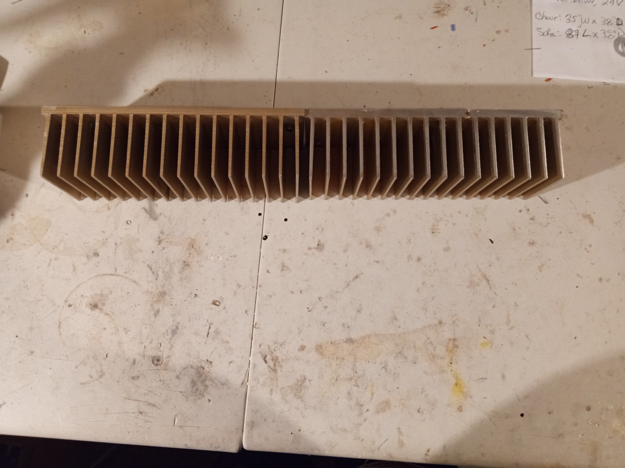

Hi shaan,
I am building a chassis for the V5 and for V4H. I have some 24V AC transformers in my inventory that I would like to use for either one. I understand that I will have reduced power output. Do you think that the heatsink in the pic attached would be sufficient for my situation. I have 2 of these.
Also in your opinion, which amplifier would be more suited to the 24V AC transformer, the V4H or V5 ?
HS dimensions: Base is 6mm, length is 400mm, fin depth is 50mm, height is 70mm

Use 0.1ohm 5W or just jumper short the pads for the CRC rail resistors. The drop will not be much under load.
