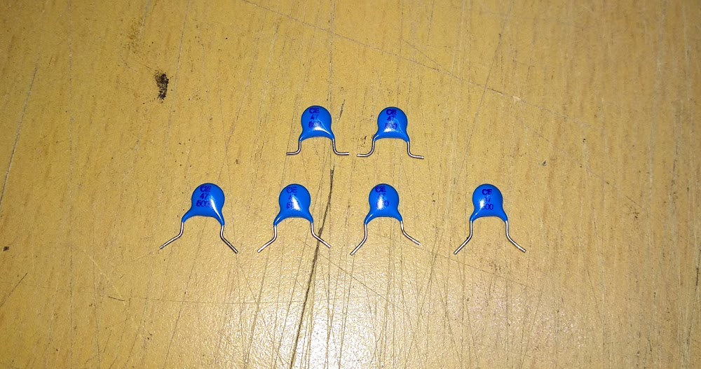

Get 6 nos. 47pF/500V capacitors, ceramic or silver mica (12 nos. for two channels). These can be the same caps used for C5 and C6. Also get four 100ohm / 0.25W resistor for each channel.
Step 2:
Bend their legs in the way shown in the picture below. Two of them bent at 90 deg and the rest bent at 45 deg, about 3mm far from their body.

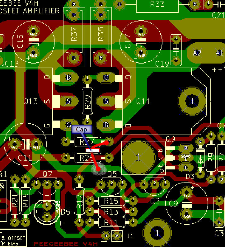

The Rev1 V4H layout looks like this. C23 through C28 added. Gate resistors will be changed in schematic, but places remain the same.
ER9dMH_rmbySXhE-ko409QhnJlKGZnztlv36jQycgHAQQcqSBPSE6CpTt34EBzMti3Ffw_0hWP_RbsGxcIISBLEWX23oI6NceFpwmPcZafFueHAap3QatT2sGnmmaaolIblx-S1-hAf5m1IBPSe27NKyZ2Ve92ISmmPFgdnkfdiP4dAuk8k5TBcvUxY0pDo1LyKBIucTNXziHY29bo1fOKDQa8JEAG9GddopT97s8JhydWk5PKIBMV382CwG8XrRIvZzacXohLzF9FEtG5IHJU0WF-FG55LxwV73MCxMBNfwdFwTpB_394CVopBh7QrGDdvCLpr7SeBs-OR2tmHOw_LNu66scdnBDoBo7gPRpB9oO1GjFjR4z5kWUG0Hyz17MgHn_eeiTGhsyTbDeAFvLnKqtstAZiEshyaVi2Qv1RGUVTLYqfdqfFHOw7TL_H0noZLV5-ulmWEKME-ntW0IakGF3PKJajO_TjOwhNUQaKuuU1WzJ1jrrxIwMWemn6vKx209awKuk6jdK7jqz9AEc0PO8cueXUFSXBTYNXblRF2d7_Z7TM9Q8jXMzLby9sG41dCT0QkCkgVEsAumEFcKYo_l4PIiBz0RYtyXCU0lO8xTTUJ6fBnTHYx1XXxJNtR2LuMxIrzQleSFnwOxHz5Ht-nDmw=w1000

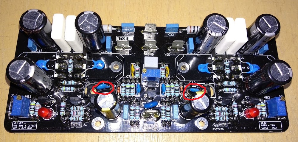

VAS ground caps, the same as the ones soldered under the board. I took this picture while experimenting. 🙂
