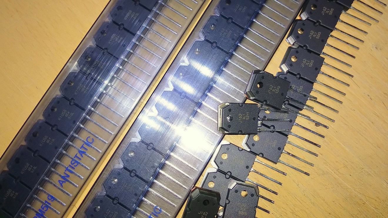

Boards will be ordered on Monday. I will receive the batch by August 20. Shipping will commence afterwards. Shipping invoice will be sent by mid-August to members from abroad.
If there is a mistake in the list then please let me know.
Thanks.
p.s. as usual, MOSFETs are already home. 30 more pairs coming next week. 🙂
