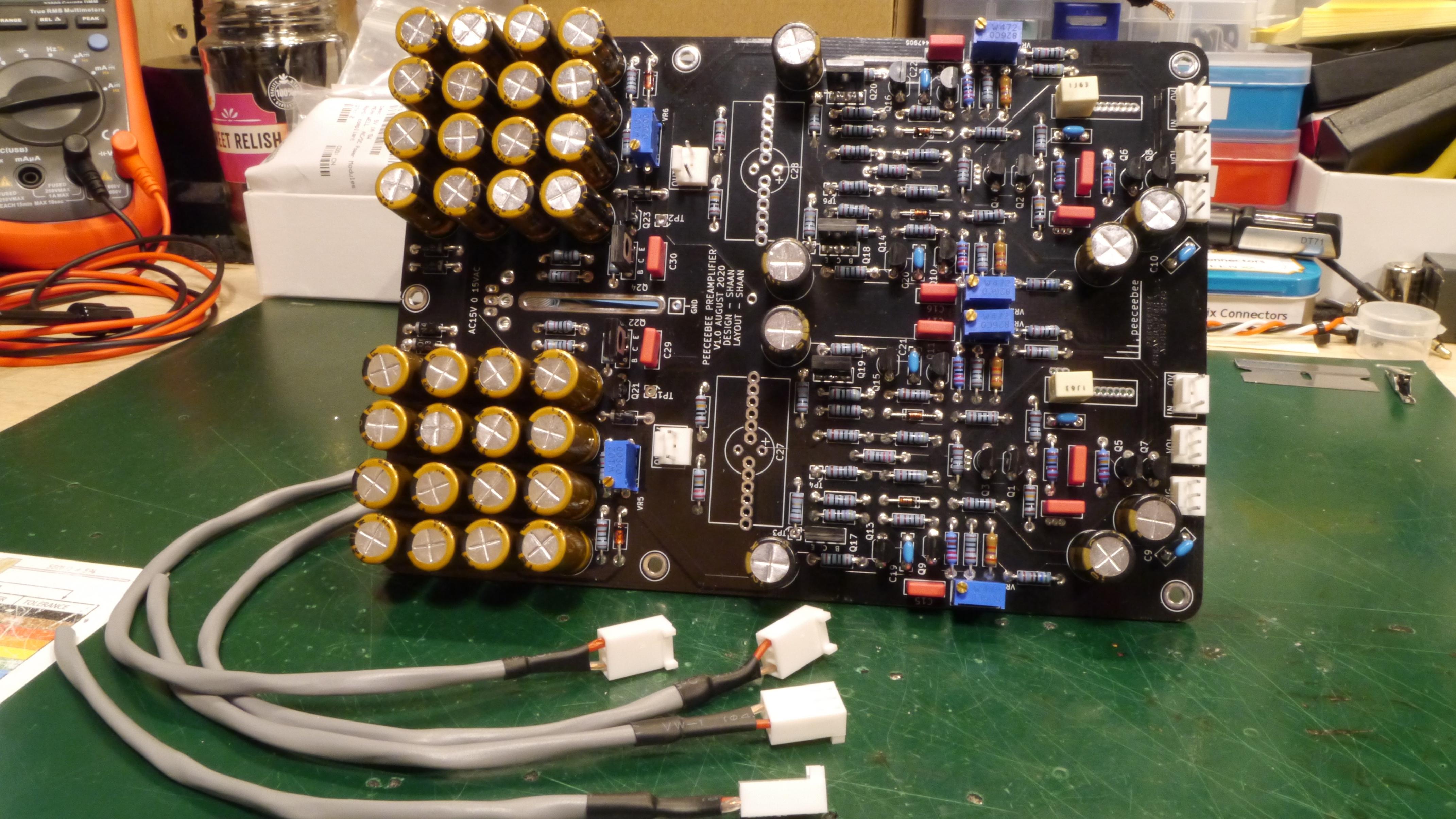

Thought I'd share my finished board (except for C27-28). Very easy build. Have not tested it yet.
Thank you shaan. I'm sure it will sound great.
Those Nichicon FG???
