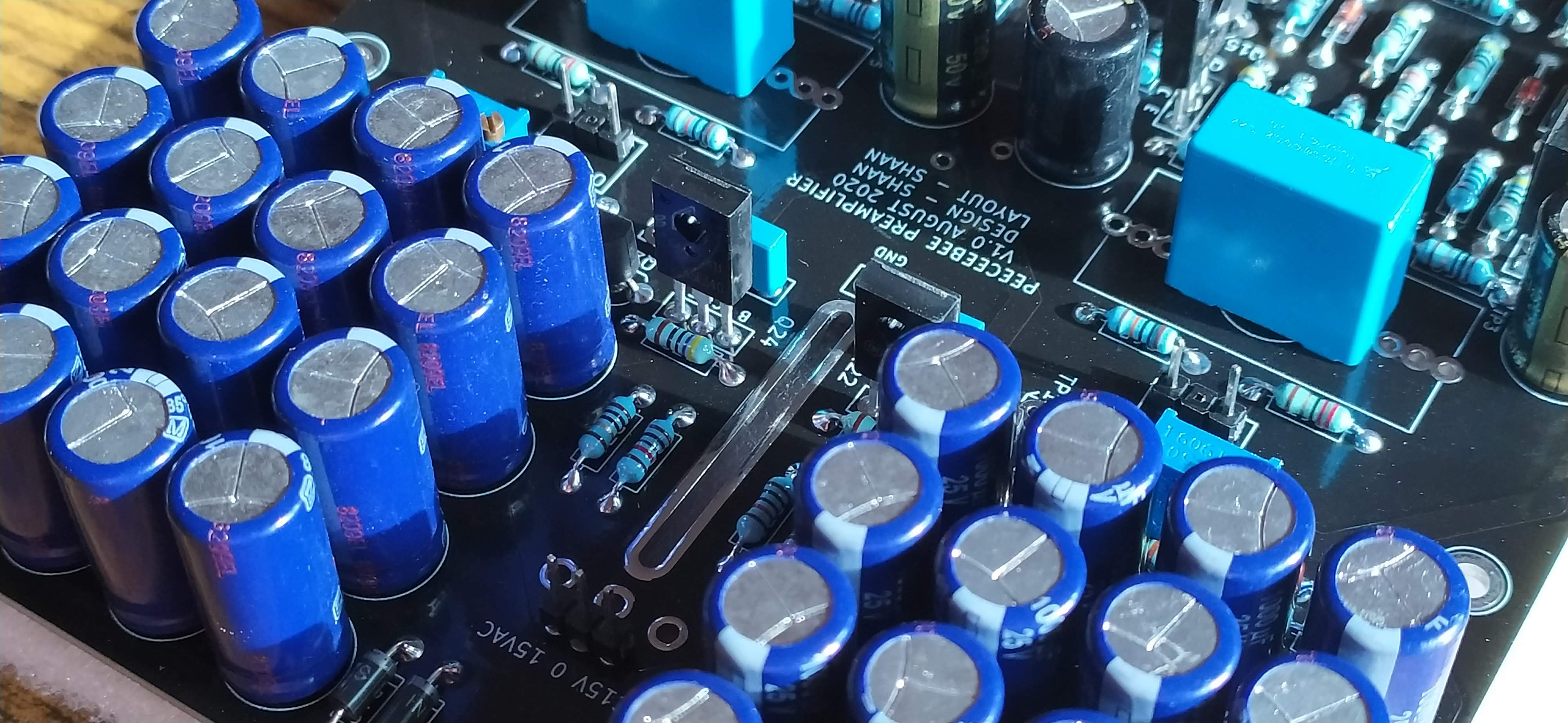

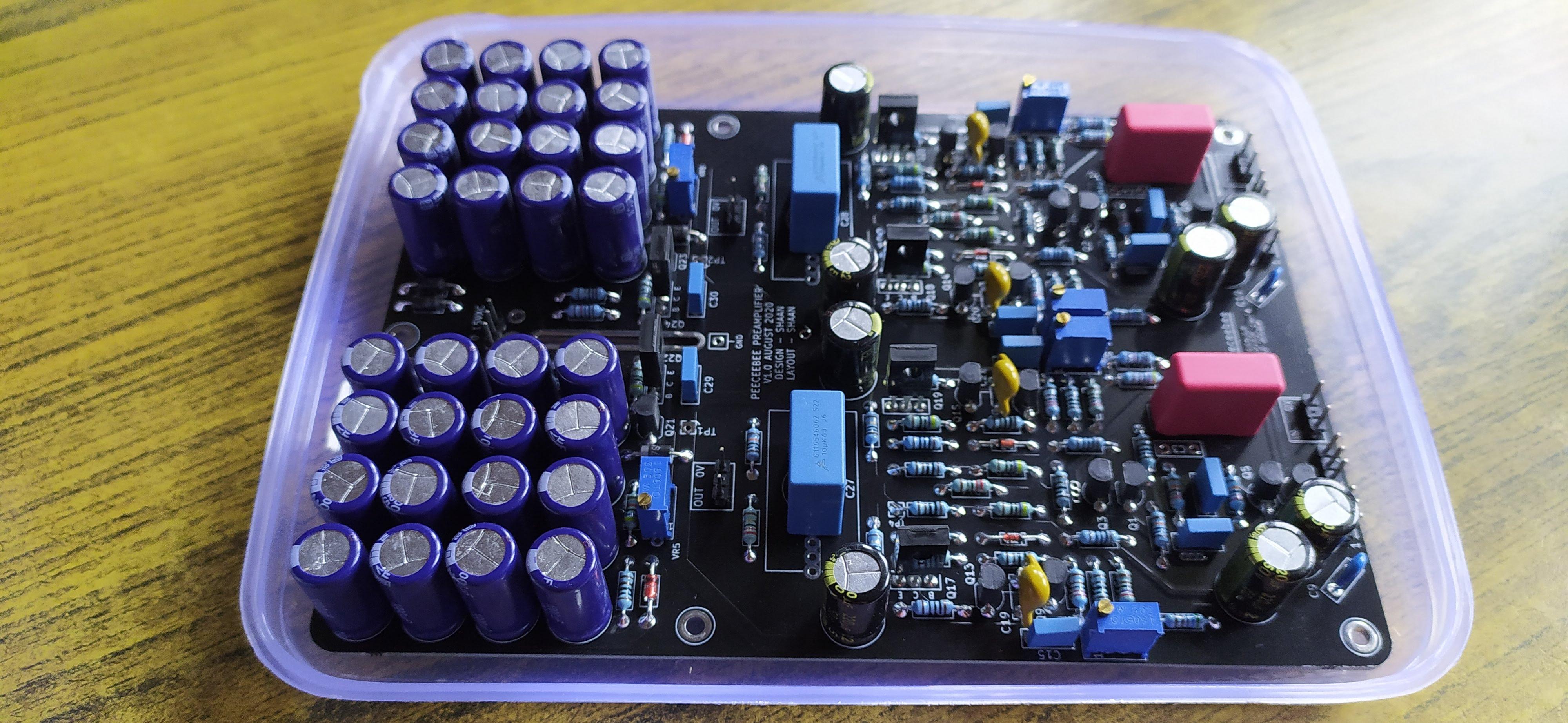

Hi Shaan,
Board all built and rails trimmed. Looks very nice.
I do have a question about the bias trimming section - you say to attach the probes to TP1 and TP2 followed by TP3 and TP4. Should this be TP3&4 and then TP5&6?
Also, it says to turn VR1-4 anti-clockwise to trim, but following the preliminary steps the trimmers have already been set to fully anti-clockwise.

Hi Neal.
You're right there was a mistake in the setup guide. I have already corrected it and updated the link in post 1. Please let me know if you can view it.

Thanks for the quick reply Shaan.
I can't access the file, the link says the file is in the owners trash.
