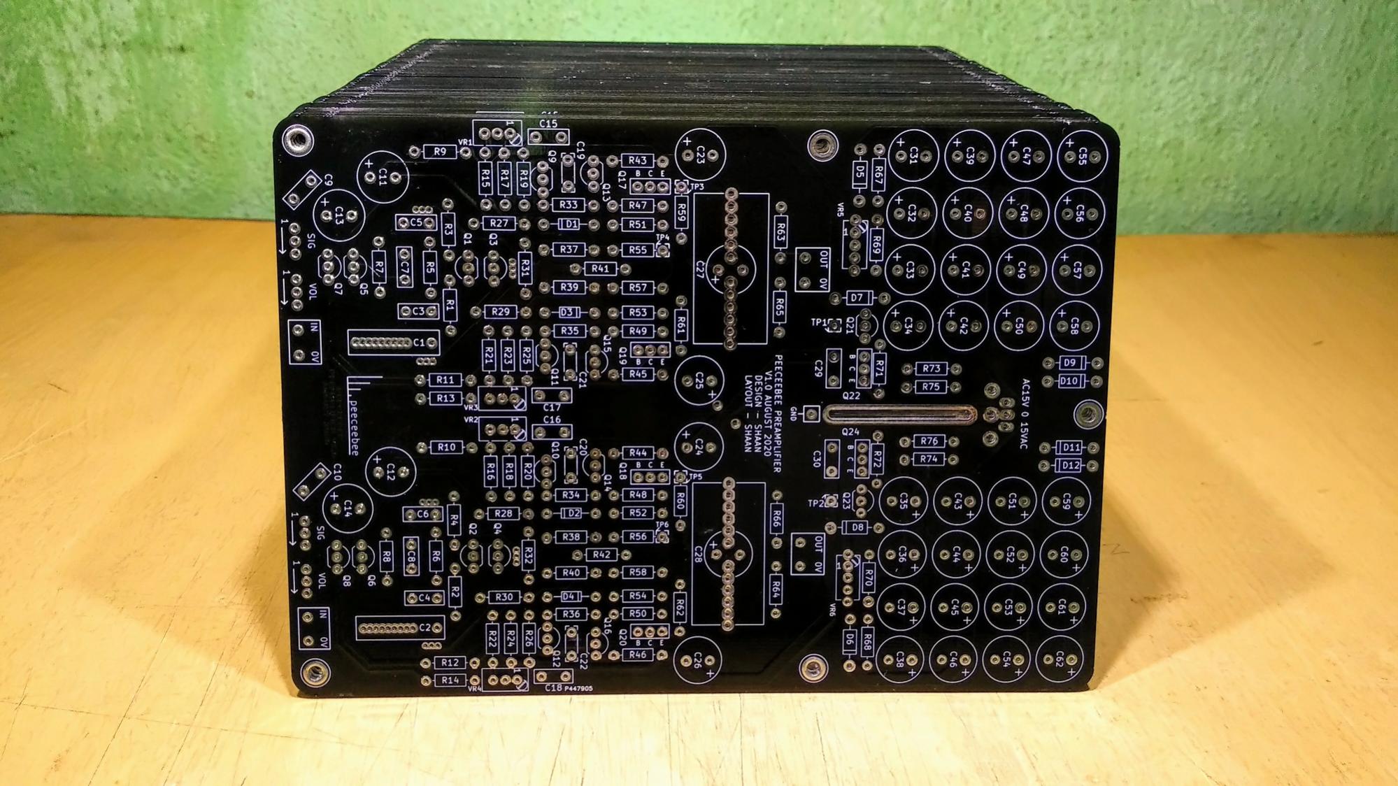

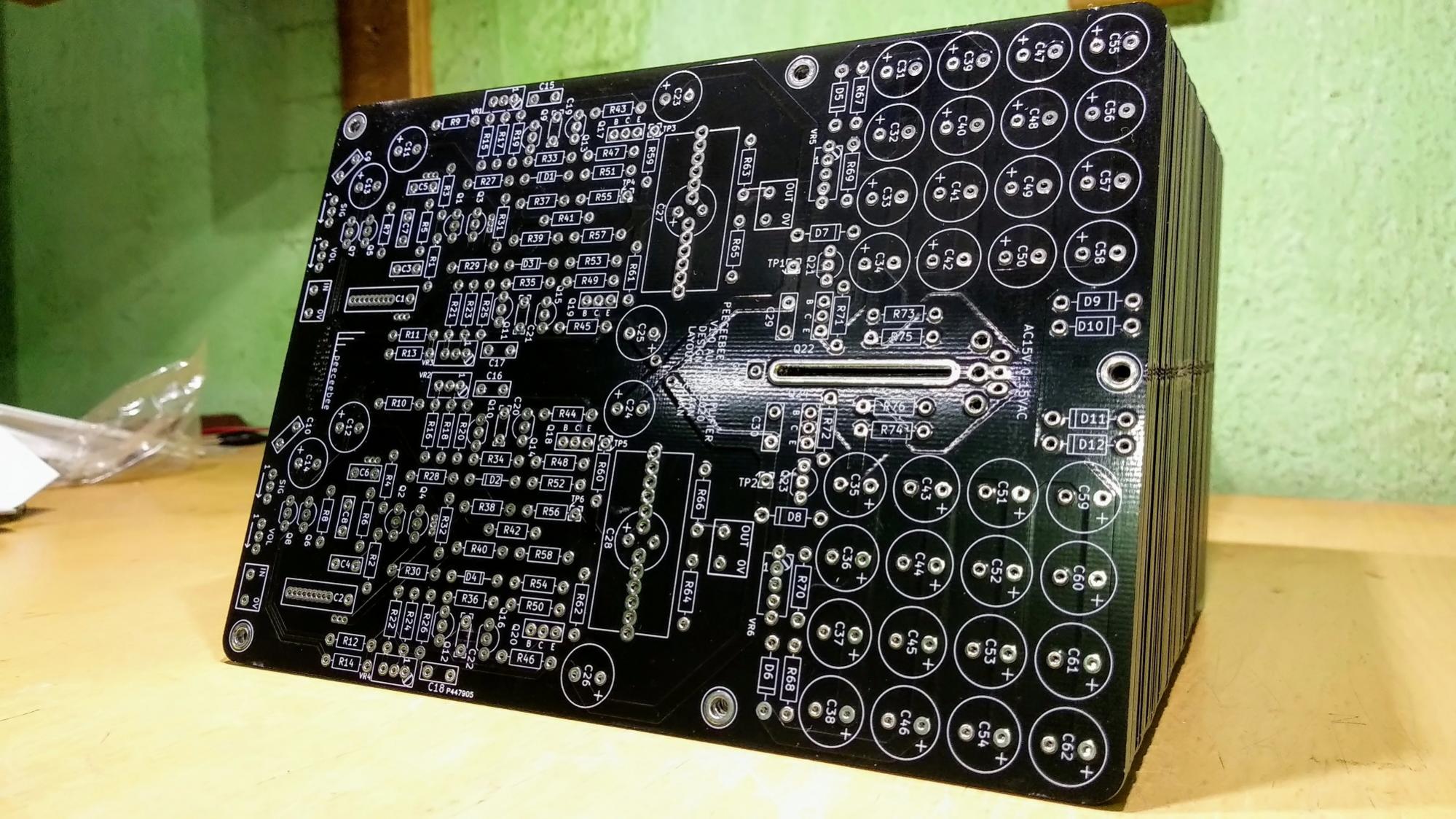

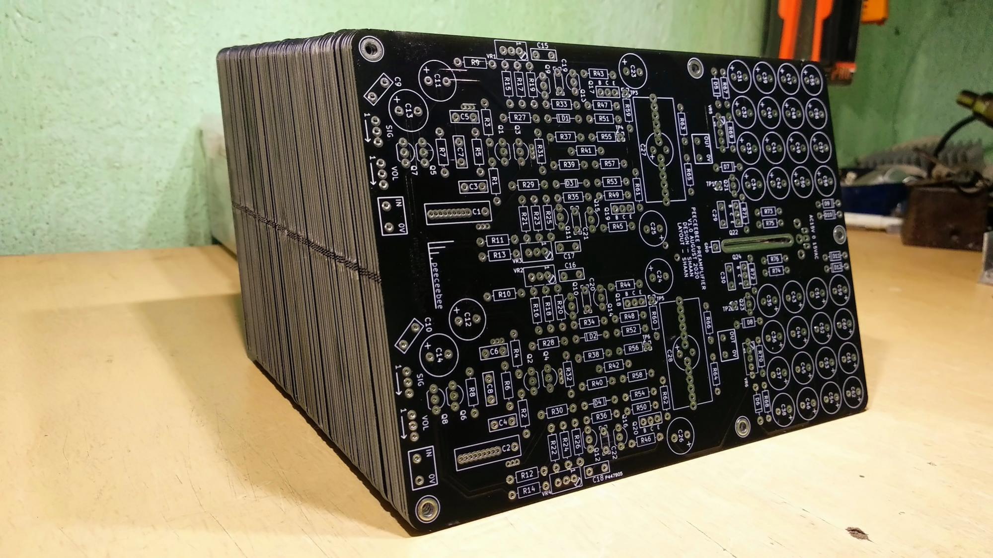

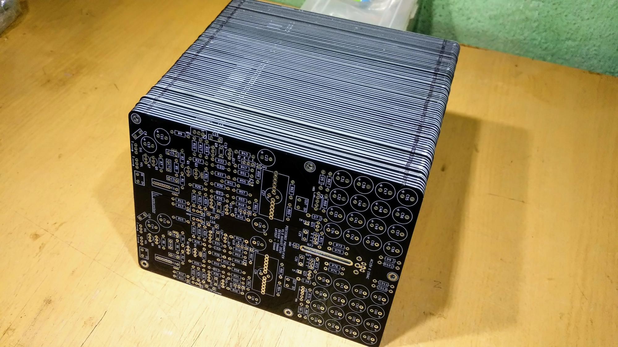

Update:
The good stuff has arrived! I have already assembled one of them and it is working perfectly! We're good to go!
Regarding available shipping options to different countries, I have made a list of all the countries that the boards are to be shipped (along with V4H and PSU), and will take it to the PO today to check what options among speedpost, air parcel and registered post have now become available for each country. Our extremely "smart" Govt. postal website has no update of any sort so far on this, so I will spend some quality time with the officer today and get the list updated. Will share it in the evening. :)
Thanks everyone for your patience.
