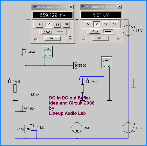

Here is my own approach for a DC-in and DC-out Buffer.
I use a one JFET + one BJT Follower.
At 5 mA, BC550C has VBE like +0.660V.
At like 1.65mA, JFET BF245A has VGS like -0.660V.
Add those, and I get 0.000 Volt offset at the output.
The BC550C does what it is best for: Provide current.
The JFET BF245A does what it is good at: Provide High Input impedance.
Circuit can be made very fast. 1 MHz is no problem!
Also shows very nice low distortion, without any feedback.
Most of the low level distortion is in fact 2nd harmonics.
Enjoy :cool:

Yo Lineup, your circuit looks interesting. Can it also function as a good linestage (without gain) by replacing the 100k with a 100k pot? The 5mA CCS can be replaced by a 4.7mA current regulating diode? Will it drive other like tube power amps well too?

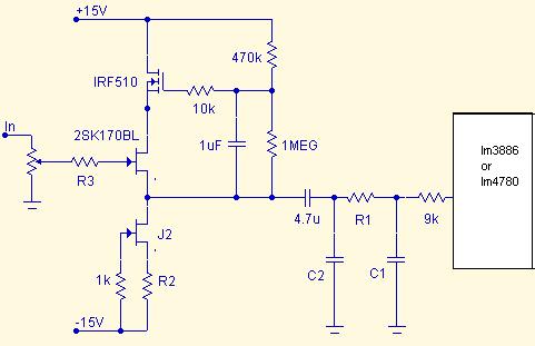

I'm glad this thread has been revived! I had never seen it and a clear layout design for perfboard is exactly what I had been looking for.
I have been considering adding a buffer to my LM3886 chipamp (the Carlosfm design) and thought about adding Pedja Rogic's or the new Pass B1. Since the Pedja's one has been tried and tested for a long time I think I will go for it.
I just have some questions.
1- Do I need to change any values for my particular chipamp?
2- Can I run the buffer it with a basic regulated ready made wallwart type PSU?
3- Do you have any suggestion in terms of type and quality of specific components?
Many thanks for your help.
Regards
Antonio
Sanchez, I would build it with what you have at hand... there is more to be had from topology than parts...
These work great with chipamps, as it forces the amp to work in a limited frequency band, more suited to its abilities.
Mine was not very full of nonsense with the PSU, but if you hear a buzz, appart form ground noise I would look for a small transformer to make a PSU, I used a 15VA 15V transformer, and this is likely overkill.
I hope this buffer can be used for Lm3886 and LM4780 "without" any changes in values. Please guide me if i am wrong...

first look at my attached shematic
A)
We have two BF245A as input stage
It is important that is BF245A (not B/C)
As at ~ -0.650 Volt GateSource,
the BF245A should have something like 1.65 mA current.
(I am sure we can use BF245B but not at this current level.
And like 1.5-2.0 mA is well enough to drive one BC550C, hfe-gain >400 )
B)
One BC550C as output stage = Follower.
Volt B-E is something like 0.650 V .. at normal currents.
BC550C works best at 1.0 - 5.0 mA.
I have used 5 mA, as this gives maximal output current
and so can drive any load rather well.
Of course this output stage can have most any other LowNoise TO-92.
As being in Europe, we can buy BC550C and get them for almost nothing ;)
But 2N5550, or 2N5551 and 2SC2240 or whatever would work as well.
Even BD139 ... one TO-126 should be okay. For higher currents.
These all have like 0.6 - 0.7 Vbe, like BC550C.
The current can be anything in output.
As long as not more than input BF245A can drive. And this would be quite a lot of current!
BD139 for example could be set to work at 50 mA. No problems, I think. :cool:
C)
After setting up the output stage,
the lower BF245A is adjusted with potentiometer or by changing the resistor value of P1.
Pick the resistance that makes 0.00 Volt at output,
when you have connected the GATE of input BF245A to GND (0 Volt)
D)
The Input resistor can be one potentiometer. And just about any resistor.
No problems.
Value will not effect the DC-offset voltage (0.00V) at the output.
You should get always the same DC at output, as you have at input GATE,
if you have setup the P1 correctly.
JFETs work well even with very high input resistors.
So we can use an input resistor / potentiometer with high value.
1 MOhm, 470 kOhm, 100 kOhm 50 kOhm, 25 kOhm .. no problems.
I would not go as low as 10 kOhm.
JFET input does not work as best, at very low input impedance.
To use any prectically any current source for the '5 mA' output is possible.
JFET, like in Input .. CCS Diode .. LED + transistor ..
and even only one resistor to bias Output BC550C will work.
The power supply is not very critical in my setup.
This buffer has got very high PSRR (power supply rejection ration).
So will work well with most.
Of course one regulated dual LM317 + LM337 is always a good choice for preamplifier circuits (and Op-Amp circuits).
See this link I got from pengboon in his email.
goes to Nuuk Gainclone pages:
http://myweb.tiscali.co.uk/nuukspot/decdun/gainclonepre.html
however, remweber that BF245 can have max 30 Volt Drain-source voltage.
So make Nuuk's supply here be: +15V .. 0 .. -15V .. or lower.

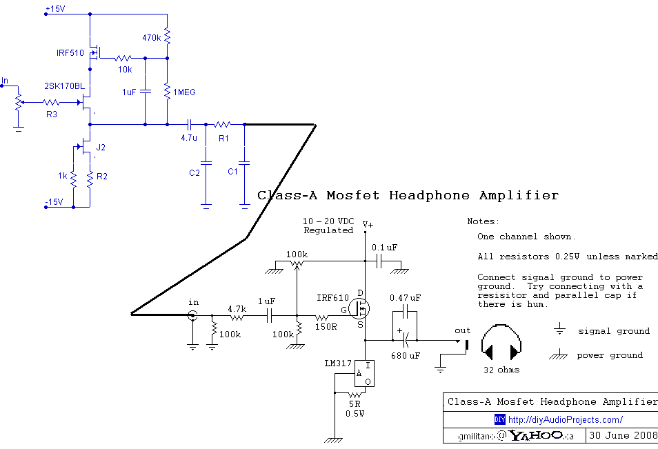

HI,
i plan to builds a class A mosfet headphone amplifier - http://diyaudioprojects.com/Solid/IRF610-Class-A-Headphone-Amp/
and wants to add pedja rogic buffer at the input stage.
is any modification required in buffer circuit or amplifier circuit OR can i simply connect them.
Please guide. here is the circuit for amplifier
AndrewT said:
the main purpose of a buffer is to allow the unsuitable source to drive the complex impedances of the interconnections and the input of the next stage.
Yes, buffer the volume control. But, you do not need to buffer the input of the headphone amplifier.
hello sir,
i had read lot of praise about this buffer and how it highlights fine details of audio signal, and that's why i want to add before headphone amplifier.
i think i'll experiment running the headphones with and without the buffer.
