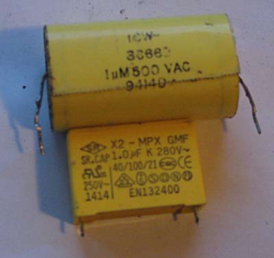

Had some fun tonight upgradeing my PR buffer...
Got rid of some crappy MKP caps and replaced with relatively much better caps from ICW... then I remembered that Pedja said he had to limit the frequency in the design, to get the chipamps to work nicely with it...... so out came the screwdriver, and out went the 0u047 caps...
Was sounding a bit bright at first, but is amazeingly even more detailed than before...
Unfortunatelty I had the wife hovering in the background to watch TV, so I could not do much comparisons bewteen just the replacement of the cap, and the removal of the other cap... but watch this spot...
For gainclones.. leave the design as illustrated in the 2 veroboard drawings, This mod is only for SS and valve based systems.
