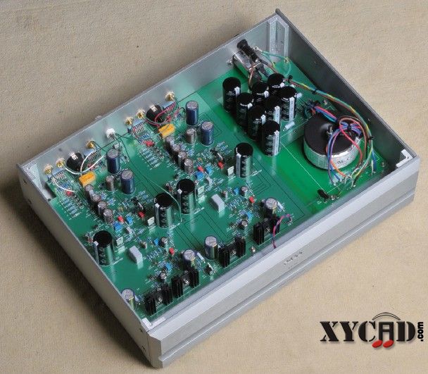

Have anyone built this all in one box, internal layout similar to the Pass Labs XP-15 phono? I prefer a 1 box solution.
It is possible, but you must have some internal shield or can for the transformer.
If I place my RIAA chassis on top of the PSU chassis, it will hum. Once there is about 12-18 inches between the 2 chassis, it's silent.
Perhaps you might want to get a very small box for the transformer, and put the rest in the big box?

I would go with a two box solution, maybe put the tranny and diodes in it, and connect it with the PowerCon connectors.

I really second those 2 ideas. Whilst running former in another housing may seem troublesome, extra work, extra umbilical and connectors, but I can say by experience it's really worth it. Nothing worse than having extra hum whilst using a low cart output, that you chose for delicateness' of sound !!!!

Thanks guys. I know its a significant benefit to have a separate PSU since this is a DIY project building from scratch, whereas people have to accept the commercial 1 box version as built. Seeing a picture of the internals of XP15 tells me its alright to copy the same layout, morover the tranny doesn't look shielded. I intend to shield it. Afterall countless pre amps manufactured are 1 box. I've planned to have a pair of Cinemag SUT at the input. Its also intended for MC mode only. Thats why I'm still looking to reduce the gain to 40db maximum.
I'm going to give it a try to mount the PSU the same way as XP15 and see if any issues crop up. If I can get away from 2 box, I'll be a happy camper.

A single box may work depending on the transformer. The XP15 transformer is shielded and actually is now double shielded and uses a low noise design. I tried an off the shelf unit and noise was 20 dB higher. They are also rotated for best noise on the original Ono they we're at 90 degrees.
