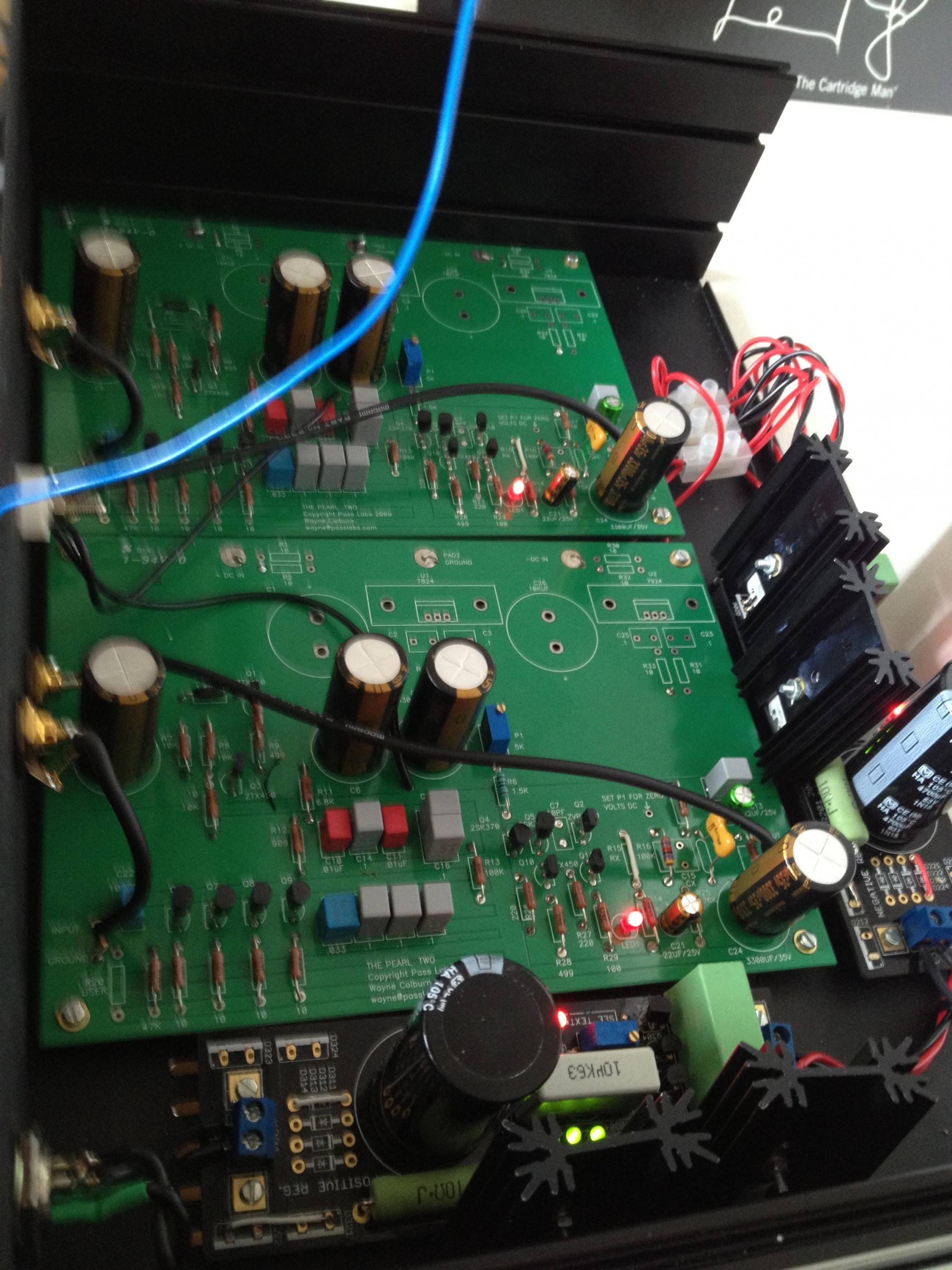

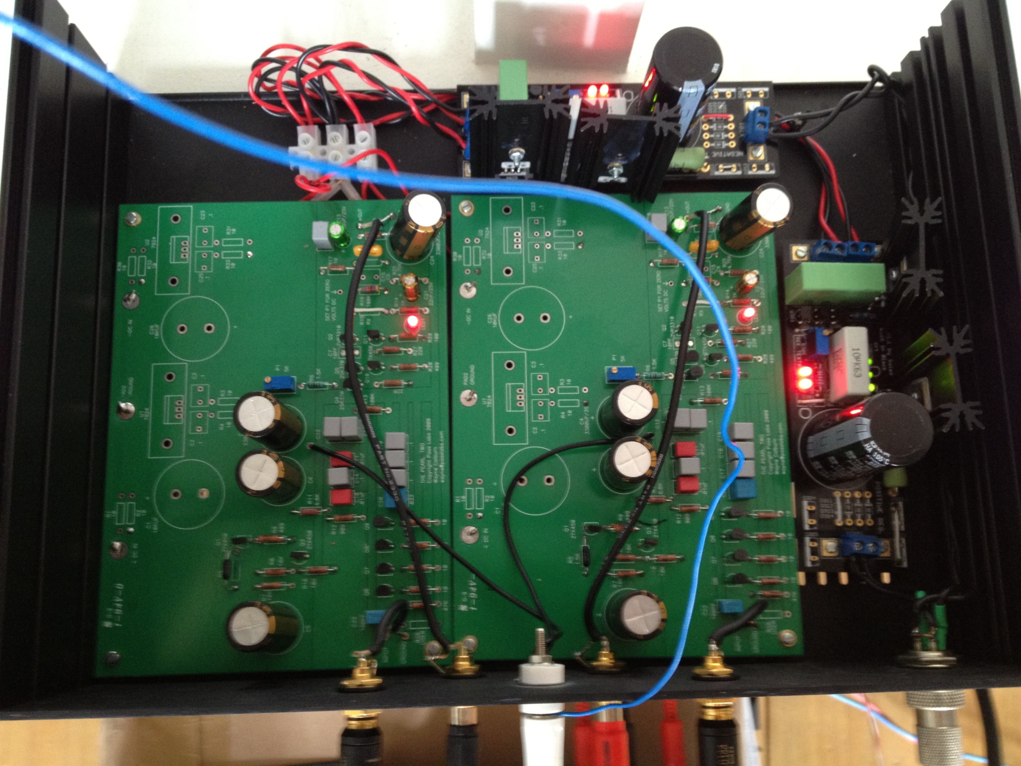

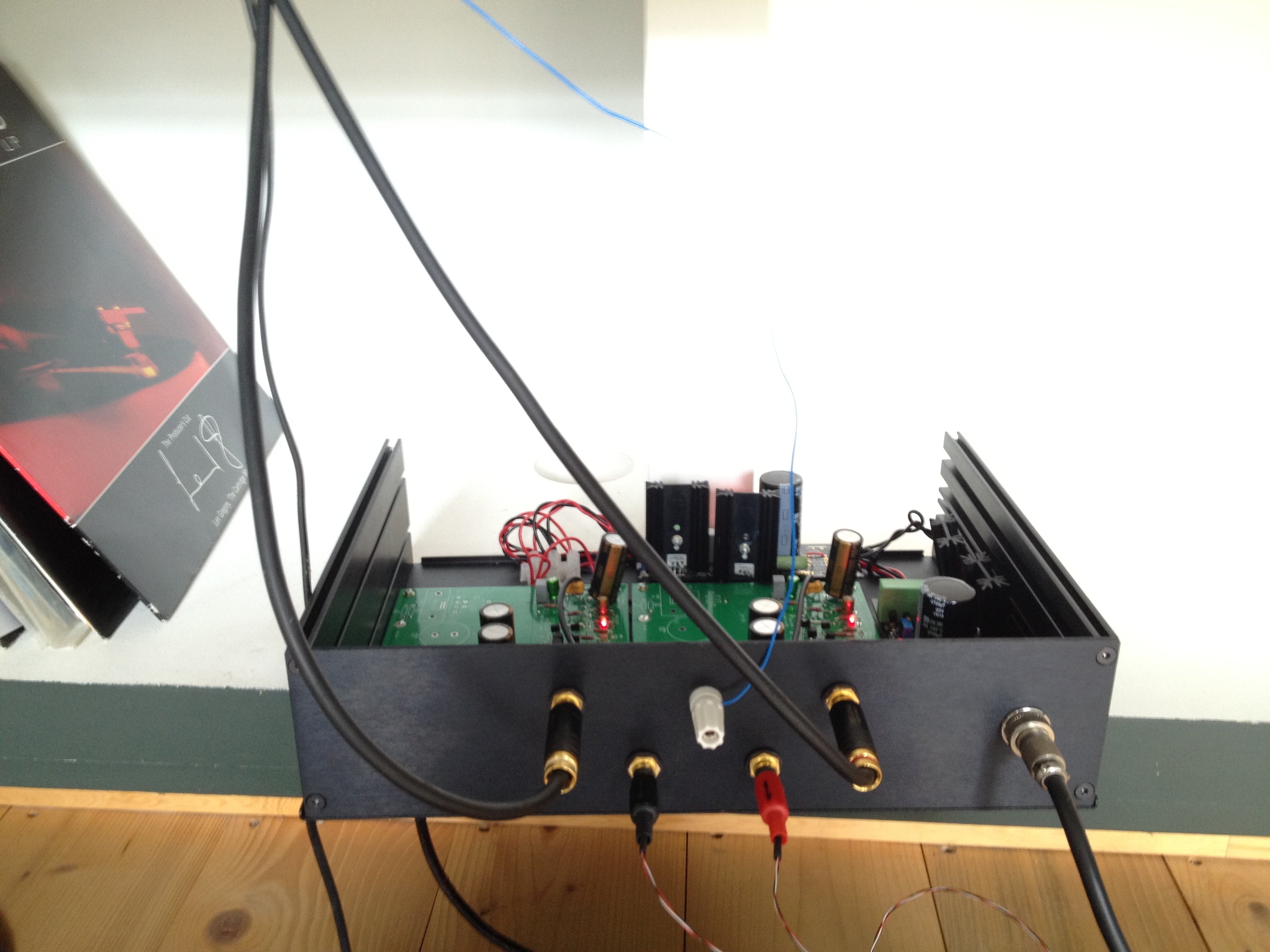

Joined 2011
finally
It's up and spinning :hypno2:
Pheew, it took time this build! So, firstly, thanks all for the help provided. I wouldn't be listening to it at the moment without you, guys. Special thanks to Anaël and Salas.
I've spinned about 5 LPs until now. First impression, it sounds better by a notch to my previous RIAA. If it was mechanics, I would say somebody has tightened the screws in the system. And of course it's tomb silent. So in general let's say the state is more solid right now :)
Other benefits may appear after more listening. It could be, that my rig is not helping to hear the full potential at the moment too. But I have to say, at least to myself, that my comercial, "dwarf" in comparison GSP unit wasn't bad at all. It might have some tiny benefits even. But as I said, I should better listen more and compare.
My cartridge loading resistors are 47.5K and my cartridge loading spec. resistance is 47K. Hope there's no mismatch? I've also lowered gain. R16 is set to 47K. I had way too much of it when with 100K. I wonder if I can measure my gain somehow now? Maybe it can even be lower? Chance of oscillation?
I don't have C9 installed. Wonder if it was there for any reason at the beginning.
HFN test record says the system is in phase. I swapped +/- leads on both channels on the cartridge.
Crikey, it's hot down here. About 30 deg. C. inside. So both DCB1 heatsinks and Pearl negative one is sweating around 50C. Closer to the winter, I would love to hear if upping CCS helps.

Hey, Nice setup dude :)
I can see "my" Allen minimalistic replicas running at the outputs ;)
Good to hear no noise at all. Gain setting is also absolutely relevant.
47k5 as cartridge load is perfect, no need to think for a load mismatch compared to 47k value ;)
Best,
nAr
