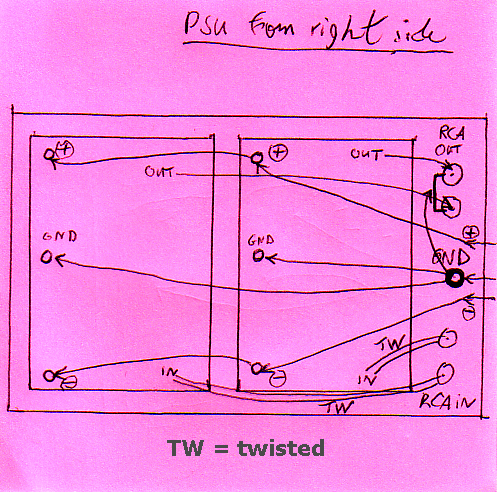

So, I've been spinning records, and I still have some grounding problems. Touching various parts of the unit makes the ground buzz worse, or go away.
Touching the metal case, which is grounded to earth, makes the buzz go away. Same with touching the interconnect grounds.
Waving my hand near the wires connecting the input jacks to the board make the buzz louder, and touching these wires makes it very loud. The + and ground wires from the input jacks are twisted together. Any ideas for eliminating this?
Mark

1) verify from input jacks from TT that each channel from cart has distinct GND
2) TT has a GND wire alone, that must be wired to audio GND if I recall
Can you share pics of your realisation ? Could be helpful. Thanks
Here's my build. As you can see, I lined the wood case with aluminum sheet. This sheet is grounded to earth. The top is powder-coated steel. I also made an aluminum sheet for the bottom.
The black (-28v) red (+28v) and green (ps ground, not grounded to earth) come in to the case. The green goes to the board grounds and to the binding post, isolated from the case. The binding post connects to the output grounds and the TT ground.
You can also see I'm using two wires twisted together per channel.
What I'm seeing is that bringing my hand close to, or touching, the input wires at the bottom will make a buzzing sound. Touching the input wire and the aluminium liner at the same time makes the buzzing disappear completely. Also, touching the metal tops of the caps makes the buzz go away.
Any suggestions?

My 2C:
Its worth trying to solve this by rearranging your ground a little. First off, try and replace the input wiring with shielded cable. Then tie all shields together at one star point - where your PS ground also goes to. Lastly, connect the ground lug of your inputs to ground via a 0.01uF cap (any cheap ceramic). Its important that this cap is grounded with as short as possible leads between ground lug and case ground. Long leads = useless. Looking at your case, it might be worth changing your layout a little so that the 2 inputs are beside each other, and then the 2 outputs are the other side of the case.

I would do a decent Star Ground.
Using your GND jack for TT ground, as a Star. See attached. I moved PSU input to the right for more consistance.
The + and - distribution "in chain" is acceptable, even if I wouldn't.
But Ground needs a special treatment not to catch any noise.
Make cables short as possible, but no vicinity of big electrolytics for GND wires.
Sorry it's done quick n' dirty, but I hope readable. Inputs don't need shield, a twisted pair with + / GND shound be sufficient.
Still all metal parts of the case direct to Earth. You can then link the Star Ground to Earth (chassis) but not direct, use 10R/1W or CL60.
Can you try this ? 😎

Thanks nar. Looking at your picture, the only things that are different from my build are:
1: The binding post needs to connect to earth ground through a resistor
2: The output leads are not twisted.
Is this right?
Do you recommend separate lines from the PS to each board?

Nope, look closely 😉
Your PSU input is at the left, and to me you don't Star Ground, you "chain" grounds to the 1st board, then 2nd board then to the TT GND on the right, then you put that ground at the outputs RCAs.
Am I mistaken ?
I would also suggest you turn your boards and arrange to get the PSU input in between the 2 boards maybe, and so for the TT ground binding post and all RCAs, it would also give you shorter Ground paths

Ah, got it! I'll try it today.
