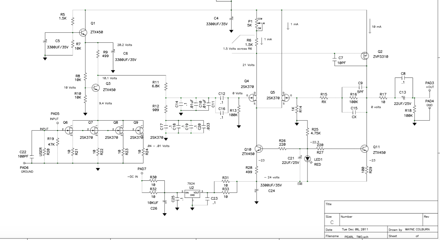

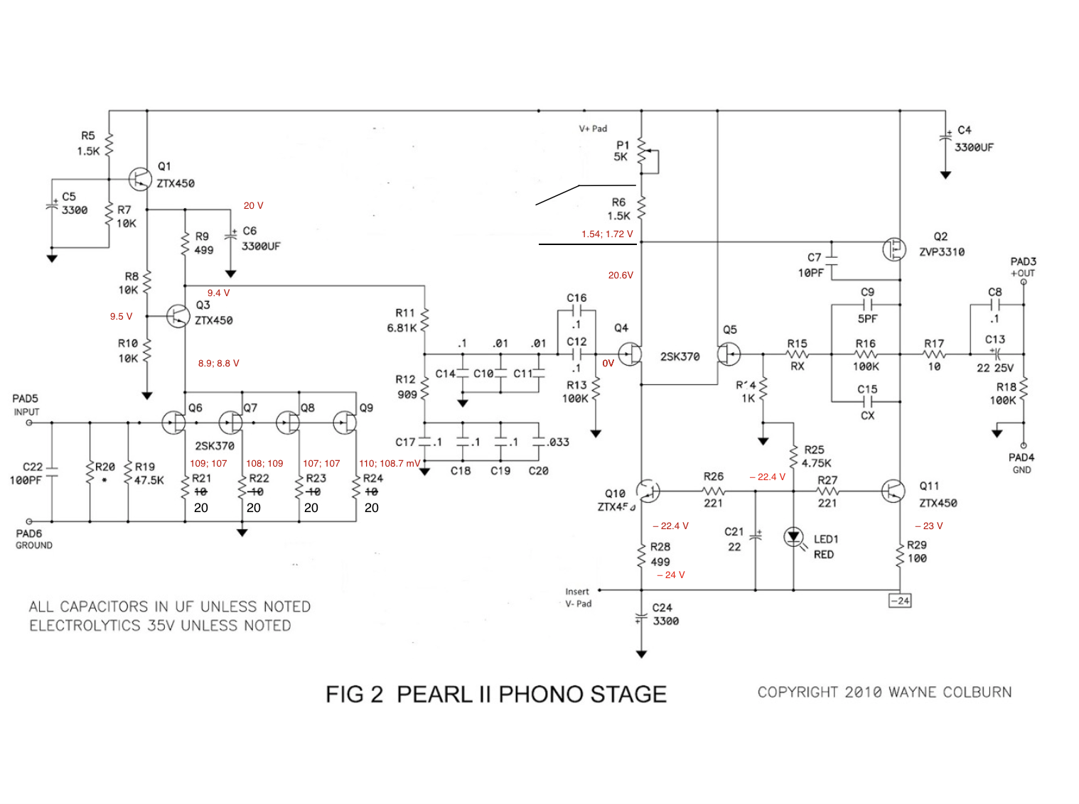

What voltages do you get on the bottom of Q6-9? If it is 70mV or more, they are draining Q3. Change R21-R24 to 20R. I had about 6V on the collector of Q3 at first (but the amp worked fine...). I changed R21-24 to 20R and R10 to 8k2, now I have 8.8V on the collector of Q3 (9.3 on the base and 8.6 at the emitter).
If absolutely no music comes out of your board I suspect another fault. Check for things like a jumper for R15 and no jumper if you decide to leave out C15.

as Wellerman already said, make sure Q3 is forward biased, meaning VCollector > VBase > VEmitter. If that is not the case, change (reduce) R10 to 8kOhm or even lower. This might be necessary, if too much current flows through the JFETs, which can also be reduced by increasing R21-R24 to 20 Ohms.

R21 to R24 were changed to 20 ohms and I've got closer voltages to Wayne's. Looks like ballpark. Attaching mine and Wayne's voltages.

With that particular cart you throw too much level into Pearl II to get undistorted at the output at stock gain setting, this is why on high level records you get saturation.
You should keep the looped gain down- it's unlikely the 1st stage that overloads -
With 5mV cart you may try to lower the looped gain by 40 dB total, it still gives a x100 voltage so about 0,5V at line outputs, comfortable to use everyday.
To do this just use the maths. R15 is a piece of wire unless you want more gain, so adding a resistor here will increase your 'problem' instead of curing it.
(This feature is reserved to MC low output cart owners to get their sound level back).
If you add more R to R15 print (series with R16) you push up closed loop gain (and get closer to open loop in fact, so higher noise, distortion and such).
Basically, gain of the 2nd stage is ratio of R16/R14 so 100/1 means x100 stock so 40 dB. Plus gain on the first stage with is about 15 dB if I can recall.
Maybe 5mV with 40 dB gain on the 2nd stage (and about 55 total) will be too much for your ears for a real 'clean' sound.
So, you can lower R16 to about 66k to get about 36 dB gain on that stage, sufficient with your cart. To do so, either change R16 with desired value, or just parallel a 200k to R16. :)
After doing this, recheck DC points and 0V after warm-up as a different gain setting can affect points.
