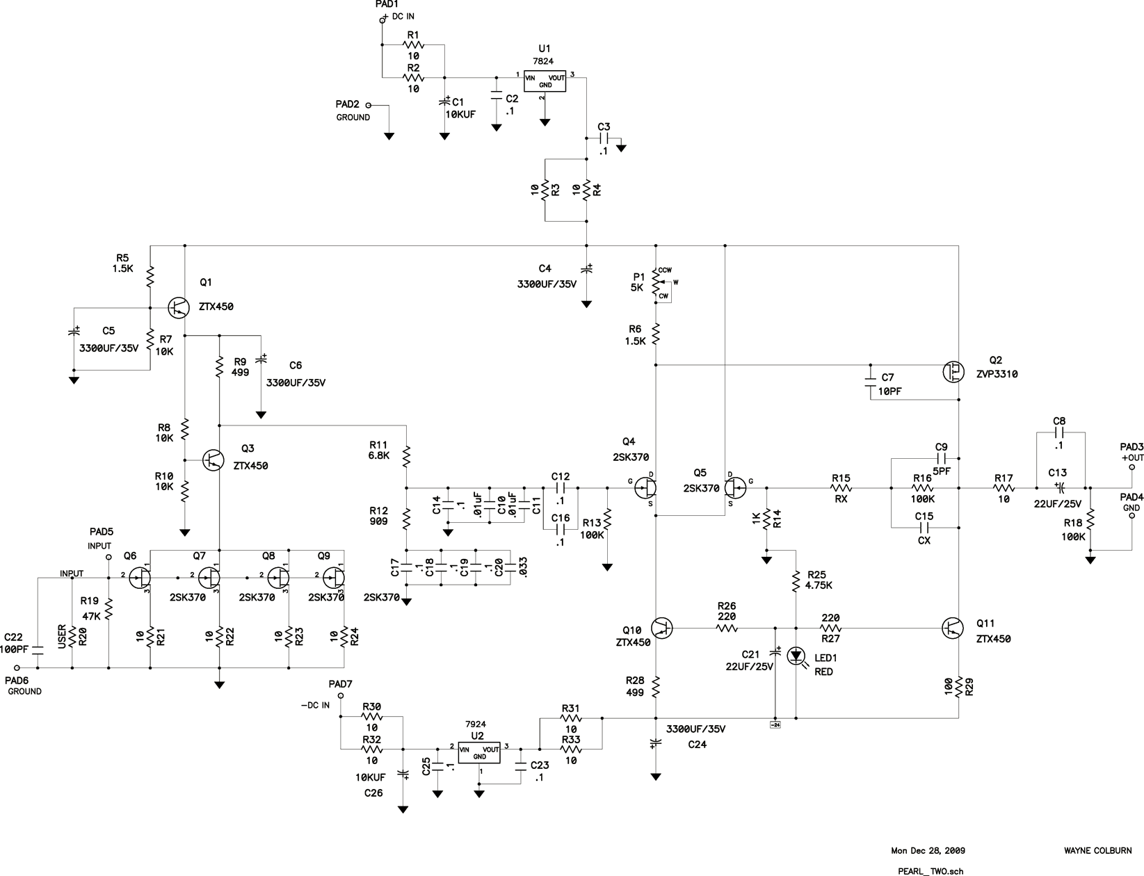

I hope this doesn't spoil the fun, but I didn't do anything but loading Wane's schematic into PS, then I decreased the brightness value. And voila...

hmm.
If I look at the original pdf directly on my monitor, that stuff is not visible, but off axis it is.
It reminds me of how people were able to read the blacked out parts from the 9/11 commission report.

quite interesting! I do see it if I turn my monitors contrast waay down.
I don't think I'll be buying anything based off of that, since it could easily have changed. (won't stop me from seeing what parts I have on hand) otherwise I'll just wait until I have the PCB's in hand...
Suppose now we can start some analysis though ;-)
...or fully "open" the screen of your laptop and look at the schematic from a very open angle...and the values magically will appear...
😉 sorry Wayne, it's
And many, many thanks, I can't wait...
Only a comment: 7824/7924: there's room for improvement, I think😀

Congrats Holger! Member GuidoR spot the trick on Dec. 29th 2009.....
and when I changed the pdf background colour the day after all the correct values immediately appeared......
P.S. Designatiions and values are printed in white over a white sheet....
No need for excuses Holger, I was just pointing out that the schem was almost "public" already 😉
