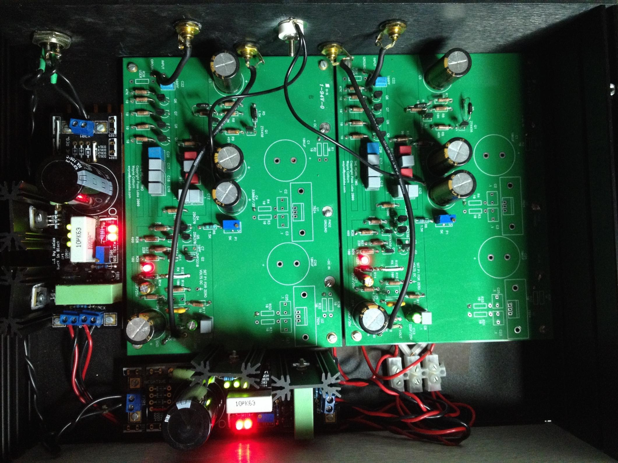

Hello,
I've have modified my Pearl II to have more gain by reducing R14 value to 300R.
Two questions:
1. Adjusting offset to 0V are we supposed to do it with an input shorted?
2. I would like to calculate overall gain this mod provides with the scope and to see if both channels match in gain. My signal generator can go as low 10mV. Do you, guys, are building voltage dividers to test your phono stages for low input like 0.4 mV signals?

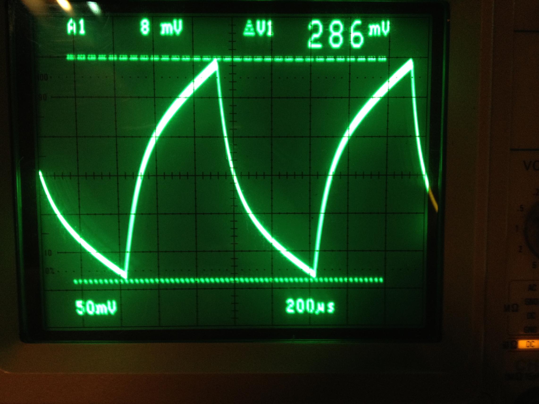

Here's a couple of measurements that I have made. To my untrained eye they are deceiving.
After changing the gain resistors I can set DC offset to fluctuate from -60mV to +60mV DC (rough take). How bad is that? Could that be some wiring problem?
After taking a couple of scope measurements the sine wave at 1kHz 1.1mV shows me that I've got 46 dB (223mV) 😱 gain.
And the square wave doesn't look square at all.
What am I doing wrong?

The square wave is fine - it is going through the RIAA eq and that will do that.
The Sine wave looks ok too.
The DC offset is a problem. Try checking it with the cover on and after everything has warmed up, the airflow around the devices could be making the DC offset go crazy.
If you can't fix it, the options are AC coupling or a DC servo amp to keep the offset stable.
