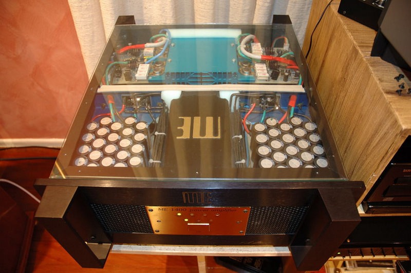

Little bit about the cooling of this. As said the fans are heatsink temp speed controlled. And usually just kick over at 30w Class-A settting.
The air intakes are behind the massive chamfered front handels, you can just see the grill then foam filters (user cleanable) behind them, with very quiet German made fans behide them sucking air in from the front grills.
The the two channels are East/West with their heatsinks butted together to form a chimney heatsink, with fins on the inside "perfect", then the exhaust is at the rear and you can see the two butted heat sinks through the grill.
Those 92 x cap banks are "tripple stacked" in height. Purposely done that way (instead of big baked bean cans) to keep the power supplies series resistance (ESR) very low.
Cheers George
This pic is of the similar but cheaper ME1400 which has set 10w Class-A bias, no adjustments on the front.
