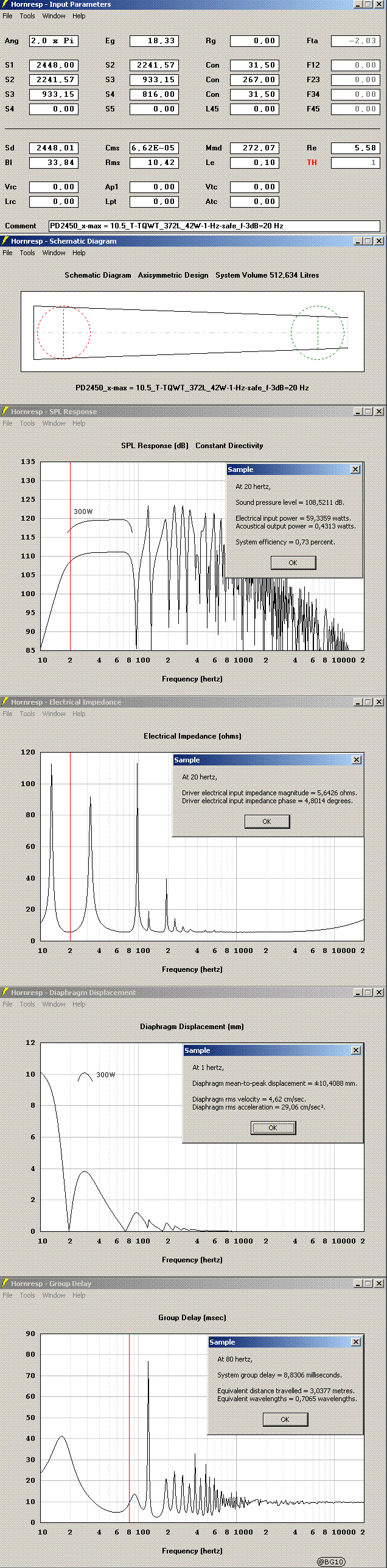

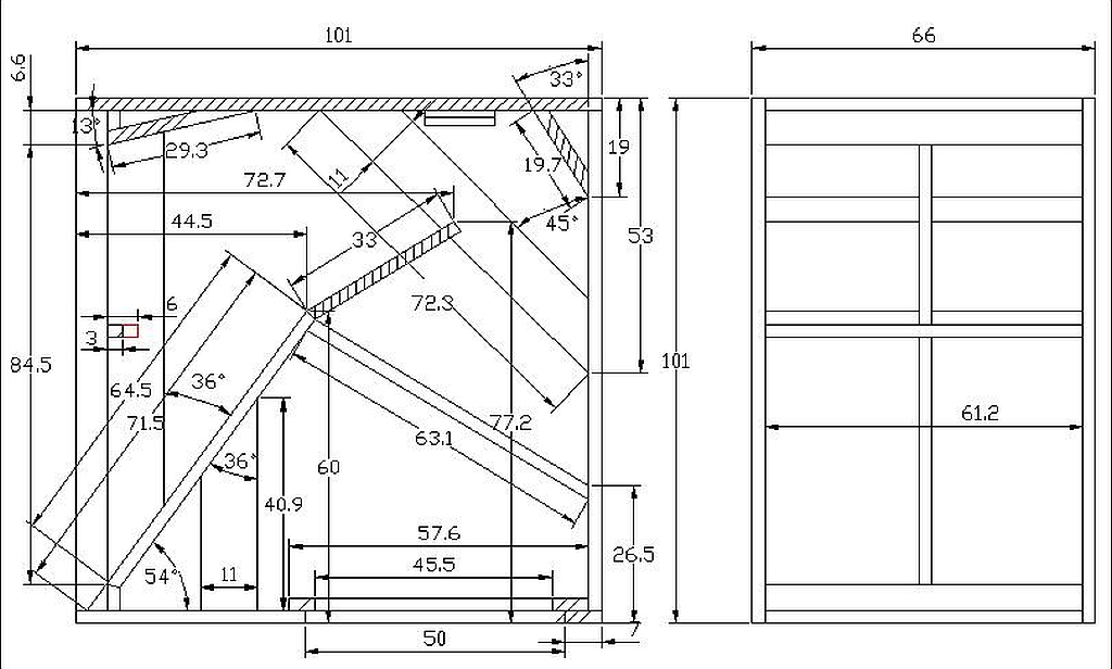

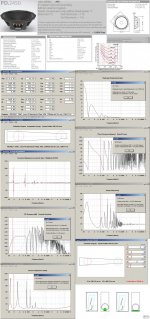

I decided to design a ‘home’ 439L T-TQWT with derated max input power as this incredible driver has only (unsurpassed?) 1% 2nd and 3rd harmonic distortion and very little power compression, IMO = benign if played below 100W and the possible passband SQ would peak.
The T-TQWT has now an f-3dB at ~17 Hz and is excursion safe at 1 Hz; a sub amp may be used with no input HP filter at all, if one dares.😀

Can someone help me wih dimensions on an enclosure based on Bjorno's simulation on the previous page?
I have 2 PD2450 comming my way, and will first try them in a SLOB, but would also like to try them for something quite different, i.e. a horn.
