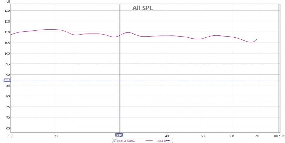

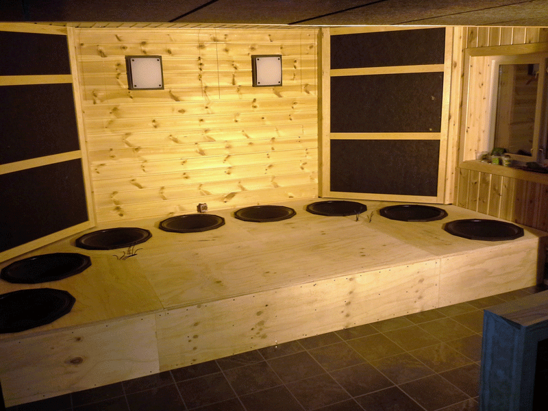

My 8 pcs. PD 2450 delivers 130 dB at 20hz in listening position and 136db at the rear wall🙂
Closed box with 380liter / driver
Image of Subwoofer and frequency response

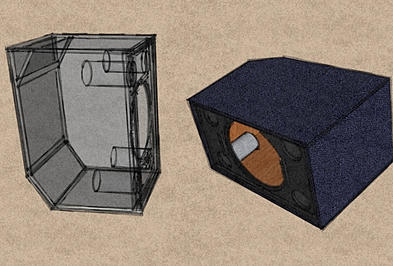

Here's the Opus Audio 224 (PD2450)
affectionately known as 'National Thunder' (by me, anyway)
and here's my single 24's, the wheelie sub.
207f09_7f1ccf02ae9cafdfb5964c05eeb51e19.jpg_srz_p_393_266_75_22_0.50_1.20_0.00_jpg_srz
Utterly fabulous in reflex. The 2150 'doesn't work' in reflex, imo, but the 2450 does, totally.
In fairly regular use still, after quite a few years. In fact, they'll be out at Alchemy Festival, in Lincolnshire, next weekend, on the Mushroom Stage.
I got 4Ω drivers, to maximise amp power, and standardise impedences with my double 15" bass.
Internally it is, like the bottom, but with a shelf, it's just transparent in the sketchup.
The slopey external cut out is for wheels.
the top square bit has cut outs for handles, like a scoop bin, which also house the Speakon sockets, so they can't be used as steps by munters, & broken.
They also make a ladder up the stack, when there's 4 x double 15" on top.
Different arrangement here, but you can see the idea, albeit horrizontally.
I had a scoop bin system many years ago, and I still haven't seen an easier way of one person moving a fair sized speaker.
