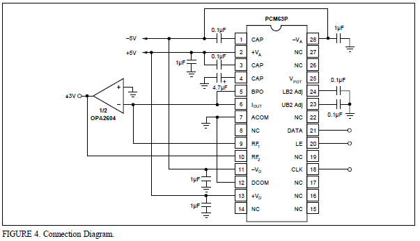

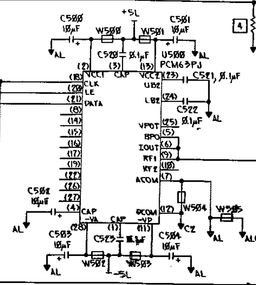

I've read the PCM63 datasheet and have the schematic (relevant parts attached).
On the GDA-600, 10uF caps are used on pins 2,11,13,28 (analog and digital power supplies) and pin 4 (offset decoupling capacitor).
A few questions:

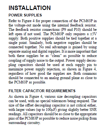

1) In the attached snippet, it is mentioned that "larger values (up to 100uF) give slightly better SNR". It wasn't clear to me if they are referring only to pins 1,3,4, or also to the power supplies decoupling caps.
2) Is there value in increasing the capacitance for the PS decoupling caps?
3) What are good types of capacitors for this application? Is this case a good candidate for "audio" capacitors such as ELNA Silmic II, Nichicon UES or UKZ, or rather low ESR caps such as Panasonic FC, etc?

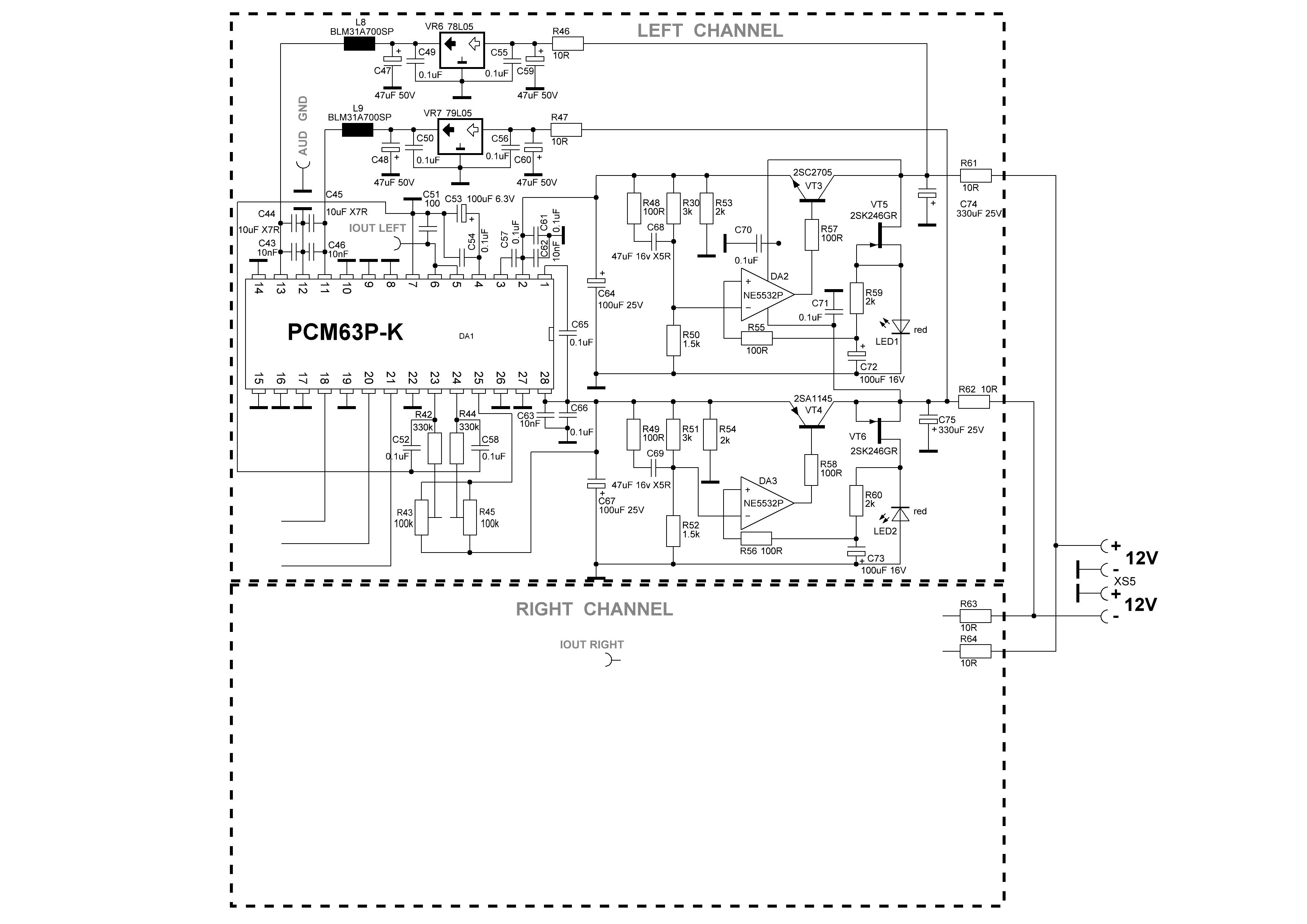

From one russian site...
Thanks! if I'm not mistaken it looks like they used 100uF, which is inline with the datasheet.
I think I'll increase the value up to that, as long as the new cap physically fits in the old position.
The DAC currently has general purpose Nichicon VX caps in those positions, not sure which to go with for replacement.

I not have PCM63.
But I think, can be used bipolar cap for decoupling otherwise Pin 23, 24.
Pin 23 and 24 is used for upper 2bit adjustment, then this section is suitable for nonpolar cap.

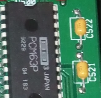

Pins 23,24 (C521, C522) in the schematic are 0.1uF.
They seem to be MLCC, or other ceramic type?

I seem that cap is MLCC.They seem to be MLCC, or other ceramic type?
I think, ECHU would be better than MLCC.
Page 3 of PCM63P datasheet:Are you referring to Pin 3, "Reference Decoupling Capacitor?
I am assuming this advice does not apply for the PS decoupling caps, on P11, P13, P28 and P2
Pin1: Servo amp Decoupling Capacitor
Pin3: Reference Decoupling Capacitor
Pin4: Offset Decoupling Capacitor
These capacitors are would be susceptible to sound quality of capacitor.

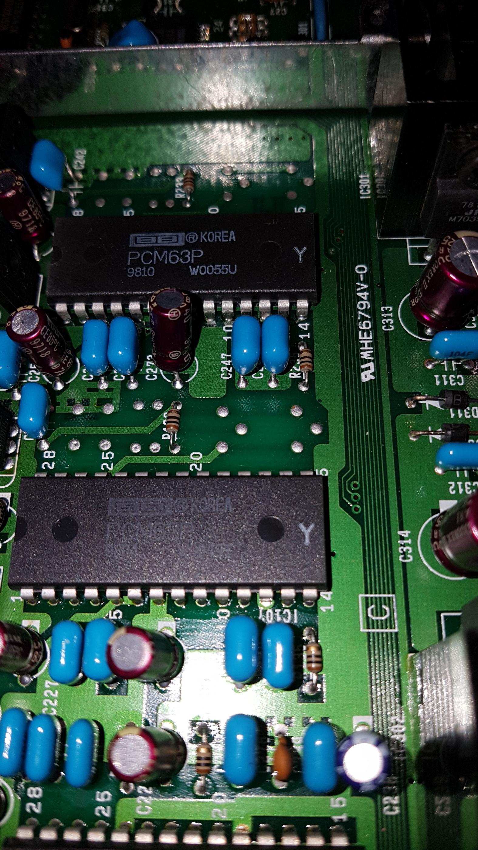

I totally agree WRT replacing MLCC caps on any non-digital DAC pins.
As I have stated elsewhere, you can disconnect the BPO track from DAC OP and use a (from memory) 2mA CCS for sound improvement.

... and play also with the voltage rate of the caps. Anyway, choice is limited by the print board... no smd caps on the picture. Avoid polymer cap in the analog side... (though rules may be broke) . Silmic II are far than neutral and imho will be to mellow with the PCM63 but all is about the I/V and buff as well. I like the choice of the picture that looks like Black Gate for the lytics. Try rubycon pps classic radiall size case too on the digital side. After you have to tune according the rest of the system to go further, low leaking caps here and there and think also to the power regs rails. It's the whole... step by step... try soe UCC polymer caps for the digital side too of the power rails... not too much low esr sometimes but you ears will guide you...if less than 6.5V, some 560 uF have very low esr and nice result but guess : all brand will give you a different result. For instance don't go SEPC caps that low esr often arms but more with the SEP caps serie and so on : you have to balance and it's a long try and error. Specs on the datasheet is a first step to reduce the choice then comes the setuping... at least it's how I proceed, YMMV.
