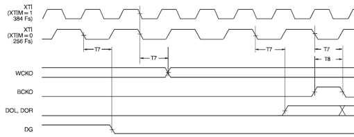

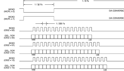

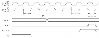

uhmmm.... my two cents...
Hi, all...
Let´s think on jitter at all: time domain errors in digital signal that leads to a wrong conversion value (in time, obviously). Please correct me if I'm wrong...
So, if PCM1704 as former 1702 also, depends on the " rising edge of bclk " signal to change the voltage value of the output, as stated in datasheet, jitter at bclk should affect the time it occurs. So... it will lead to the mentioned time domain error.
My reading of datasheet : the combination of Low state of the WDCK AND the numbered RISING edge of BCLK lead to change the output value, NOT the conversion, but that change SHOULD occur at precise time to minimise jitter effect. So, BCLK should be precisein time, although not constant.
We can observe PMD100 datasheet when it does operate stopped clock output, the first rising edge of bclk is precise relative to XTI signal (type of MCK ).
IMHO, to have a very precise MCK, SCK, XTI or anything like those and carefull PCB layout, is MUCH more important than introduce gates to reclock sck and wdck signals.
Sorry for long post. 😀
Regards to all
Euclides.
datasheet...
sorry, I forgot to attach that datasheet....
and so I do understand why 1702 and 1704 are both very good and have low sensitivity to jitter than other DAC chips...
Cheers...
Euclides
