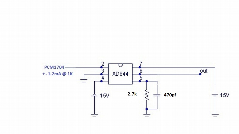

Wouldn't it be better to give that gain needed by the buffer instead, and keep the I/V resistance as seen by the 1704 low.
As I also use no active preamp with no gain and my output buffer after the I/V stage has the gain needed to give the >2v at the output.
Cheers George
Yes, you are right. I reduced the I/V resistance from 2.7 k to 1.35 k. I added some gain to opa1632 unbalanced to balanced stage. Result: Awsome 🙂

1.35k? I meant 15ohm and double or triple the gain of the buffer. As current output dacs love to see an almost short to get the best from them.

Hi George;
Do you mean you want to say 15 ohm at discrete iv output?
AD844 iv;
our discrete iv (Pedja Rogic's Inspired by ad844)
(not 3.3 k now, 1.35 k)
I have heard about 25-30 gain circuits (SRPP Tube) at the output by using passive iv and 30-50 ohm iv resistance. But is this also true for discrete iv? And 15 ohm and 1.2 ma (pcm1704 I out) need ~x157 gain for 2v rms out. isn't it right?

No, the load the PCM1704 sees with a triple stack AD844 on it's pin 2 is 15ohm. The resistor you've circled (1.5kohm) is not the I/V resistor it's the TZ "gain" resistor.

Hi George,
I think, ad844 with no feedback is using current out (pin 5) and need I/V resistors to TZ pin. The gain (output voltage) still adjust with this I/V resistor. Like our discrete I/V (
similar of AD844 simplified schematic.)
Pedra Rogic's discrete IV stage document (we use this schematic);
http://www.diyaudio.com/forums/blog...-out-production-pedja-rogic-ddnf-iv-stage.pdf
I dont know (I have not measured and simulated) our iv stage "input" impedance.
Datasheet page 13 says AD844 pin 2 input impedance is around 50 ohms.

From the data sheet the pin two of the 844 is 50-65ohms input impedance, stack 3 and it's around 15ohm.
"INPUT CHARACTERISTICS: Input Resistance Negative Input 50-65ohms."
